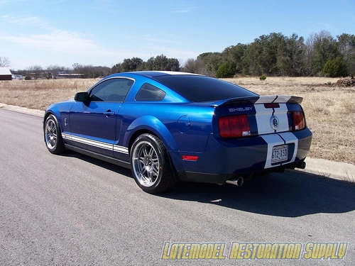

Our 18x10 SVE wheels for 2005-2011 are +43mm offset. Here is a pic of them on a GT500 with a 275/40/18 tire.
275/40/18 & 285/40/18 are the most popular rear tire sizes that I know of.

The wheels are 18x9.5 with a 45 offset. Stock rear tire on that wheel is a 285/40/18 and it fits perfectly. That photo above looks like the wheel is a bit close to the edge of the fender, prolly due to the 43 offset.

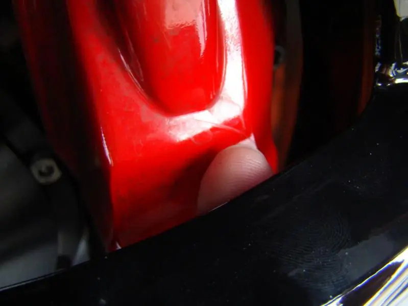

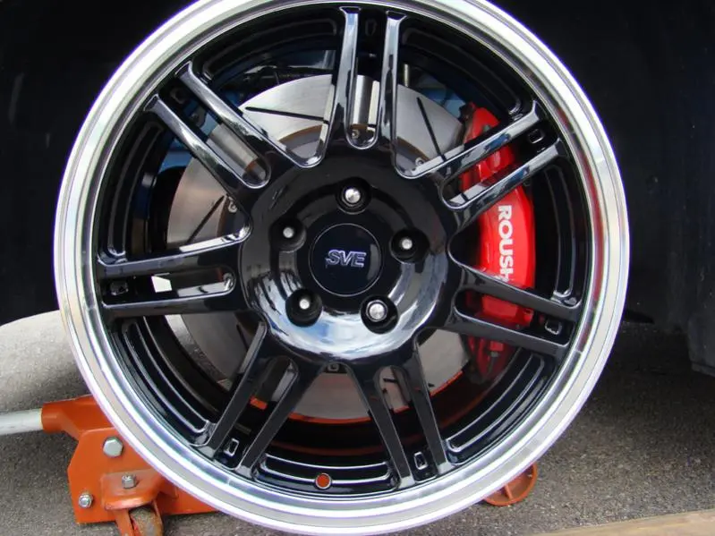

Sorry for the delay in getting back to you guys. The memory card that had the pictures from the test fit was misplaced & just now found.
The 18x9" SVE wheels will also clear the Roush caliper!
