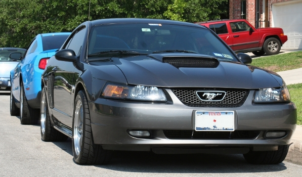

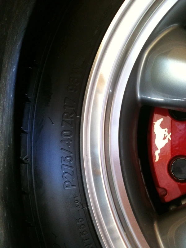

I have the C-springs and have no issues, if I had more of a drop it probably would be an issue. It is really close, but clears everything in the wheel well by at least 1/2" at full wheel lock on both sides (first pic is at full wheel lock, don't have any pics of the inside of the tire but nothing touches)
