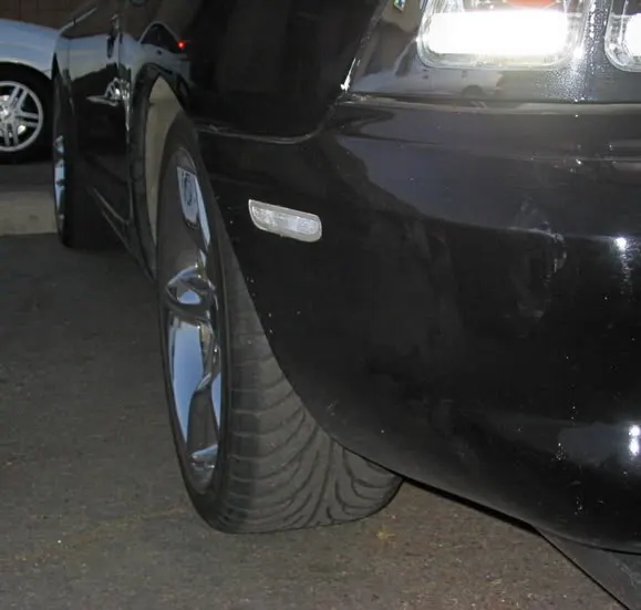

I want to get wheel spacers for my rear 18X9 wheels. I was wondering how strong are they? I'm afraid of them breaking off on me. Does anyone have any pictures of like 3/4in spacers for rear 18X9 wheels or anything similar? I was wondering whether 3/4in is enough for me, or whether I should go a whole inch or even just half an inch.
I was thinking about getting 18X10's as well on the rear and using wheel spacers as well.
My front wheels stick out more than my rear wheels, pictures below:

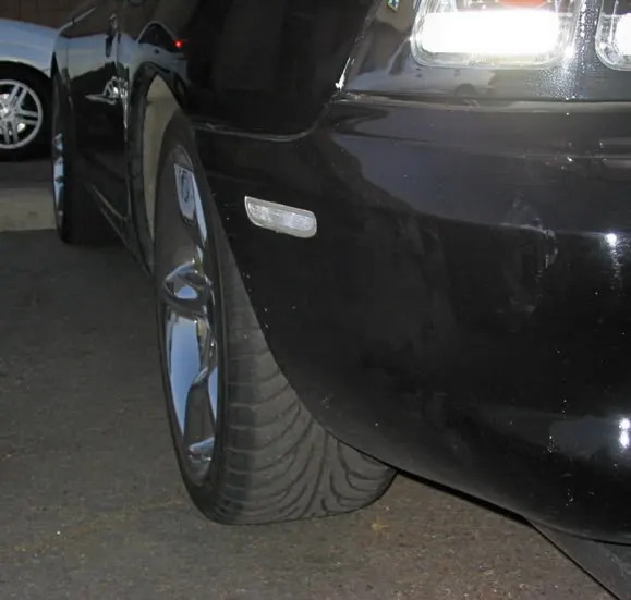

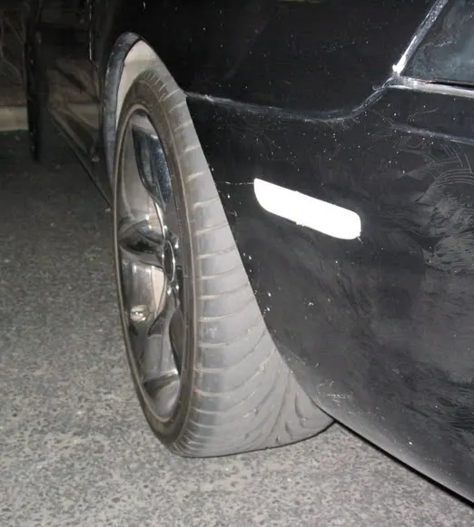

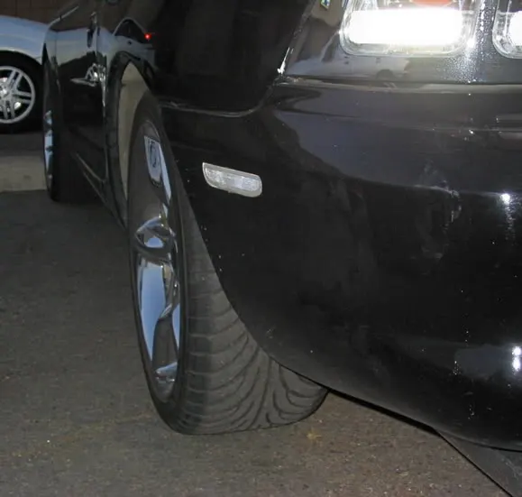

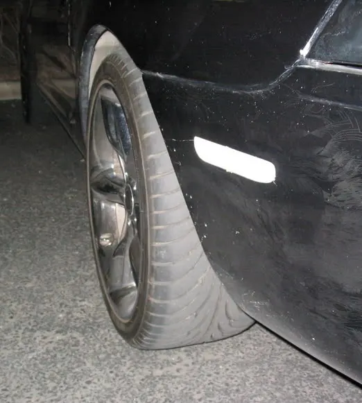

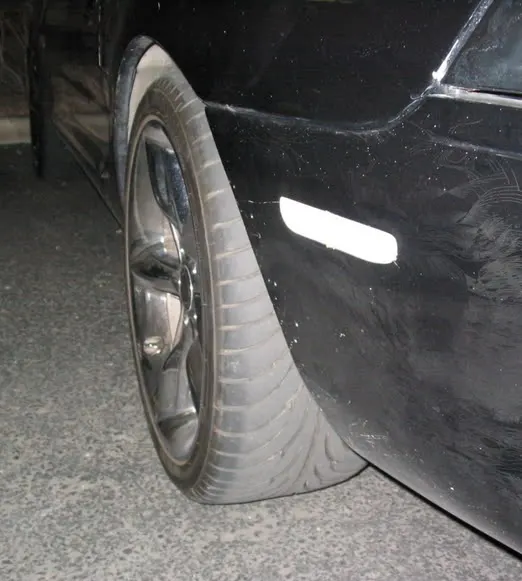

well for my 18x9's i went with 1in. spacers and i love them. you just gotta make sure you get some that are hubcentric. personally i would recommend getting 1in. feels just like stock but looks 10x's better.
heres before
and after
P.S. you are really beautiful

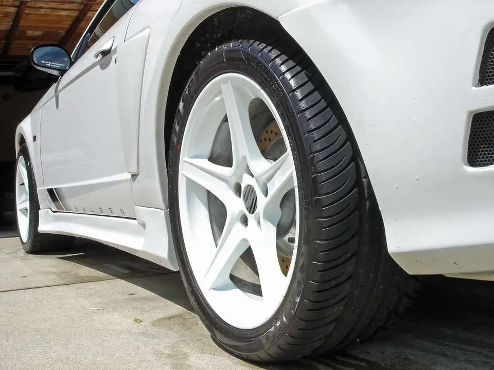

I would not run them with saleen wheels. it will be very obvious they are on there.
the only downside to a nice wheel spacer is having to remove the wheel to retorque them if you are anal the first time you install them and if you have a very open rim you can just see them between the wheel and the rotor.

thanks for the picture and the compliment :)
I think I'm going to go with an 18X10 with wheel spacer because I found some cheap white Saleen wheels for $150 each at MRT Direct :p

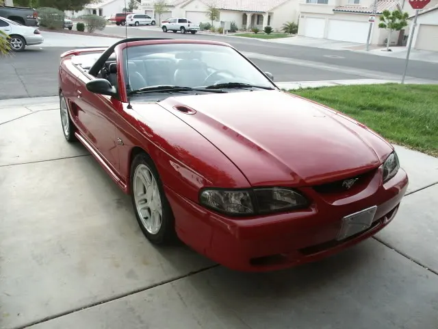

I don't think they are at all apparent to the un-trained eye. When you are rolling all you can see is the bright red calipers behind... that is if yours are some bright color. :p
H&R 30mm
On Edit: Crap! I just deleted my Wheel/Caliper/Spacer picture... I'll get back to you on that pic....
