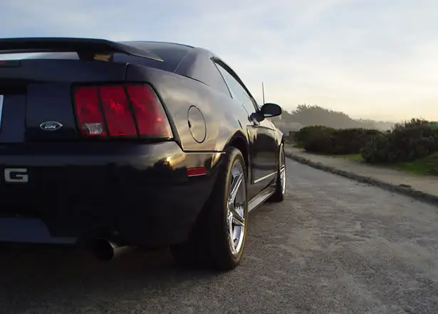

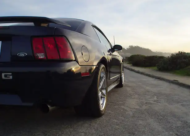

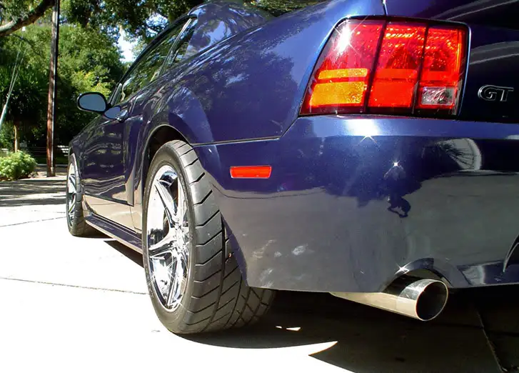

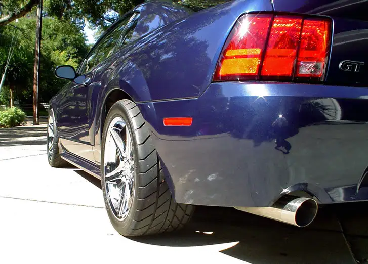

Dont get the spacers.....if you're going to get 18x10 saleen replicas, you wont need wheel spacers. 18x10 saleen REPLICAS sit out almost 3/4" more than authentic saleens. TRUST ME. i've done tons and tons of research on this subject. The offset on the replicas i have sets the wheel out almost flush with the fender...they sit out so far that they rub on the fenders when going over bumps (so i had to roll the fenders)
18x10s with 295/35/18
