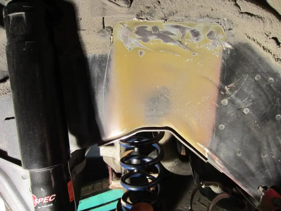

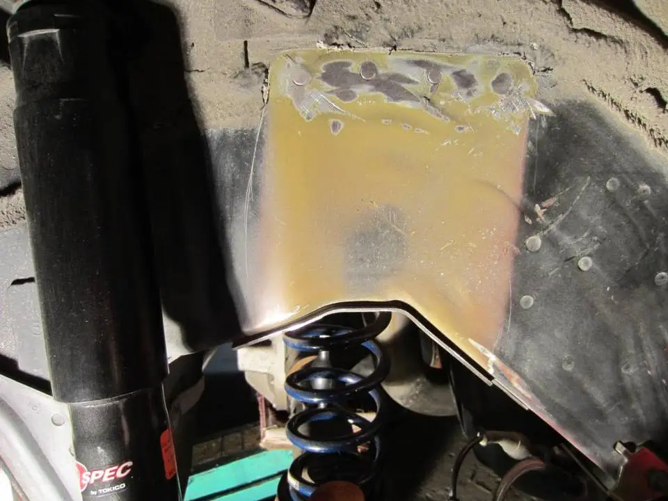

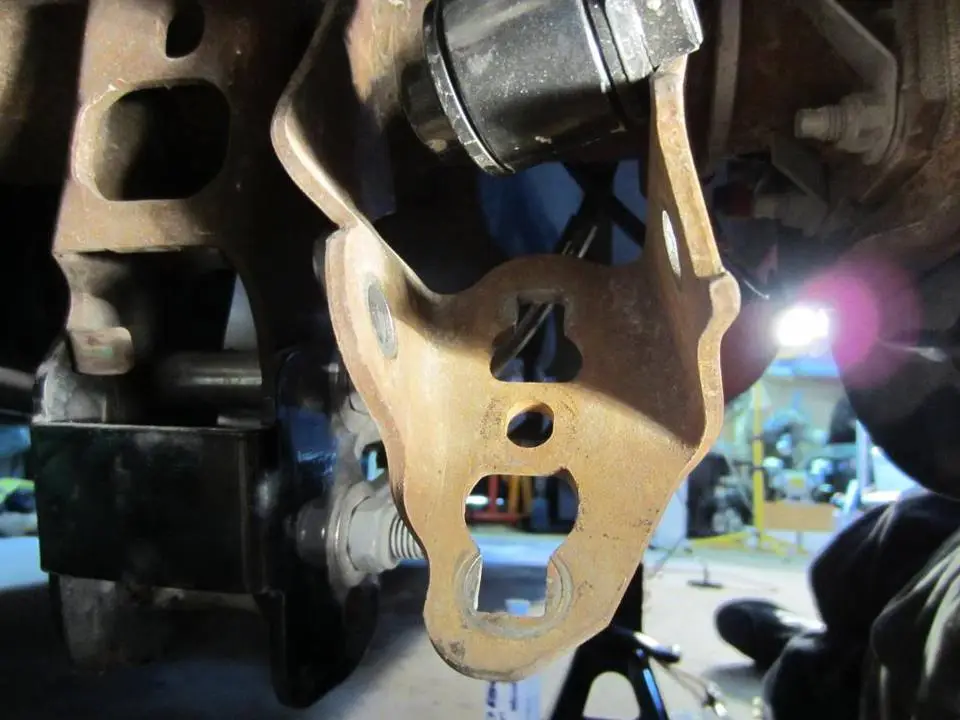

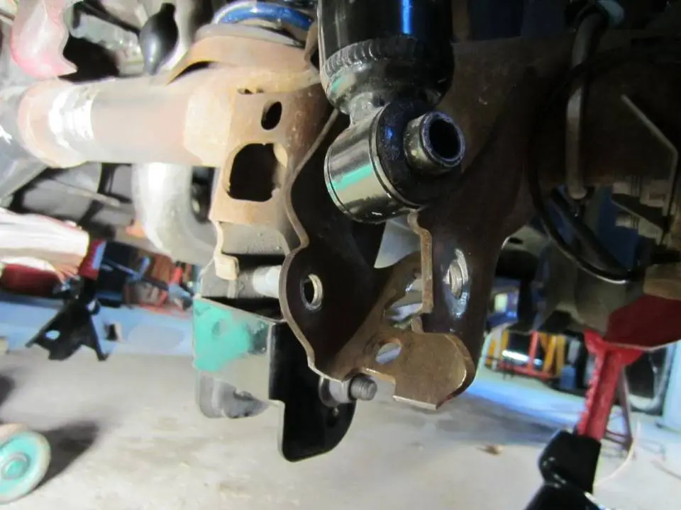

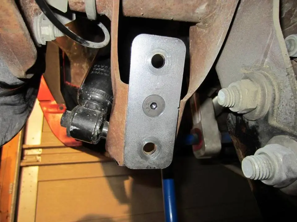

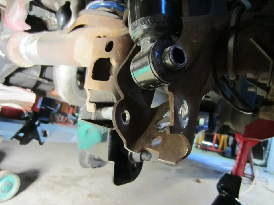

Can't speak to the front as I have 14" brakes, so I used 17" rims. On the rear you need to trim the sway bar mount as pictured here, then it is no problem installing 15" rims.
From this:
Trimmed to this:
Add Sway Bar relocation plates like this:
Then 15" rims fit the rear like this:

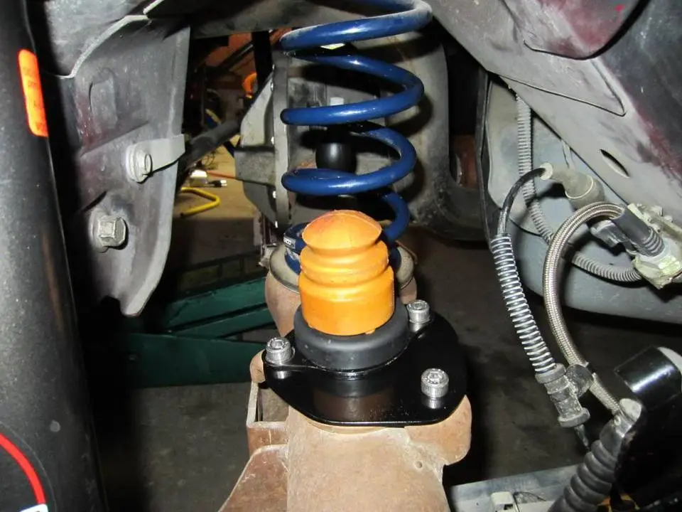

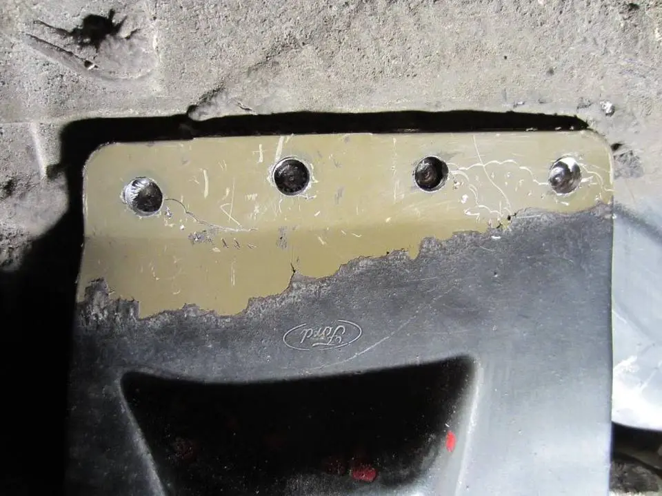

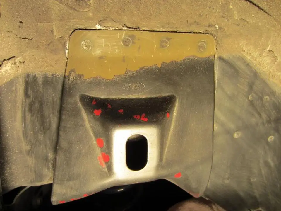

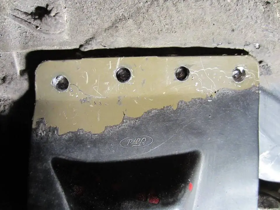

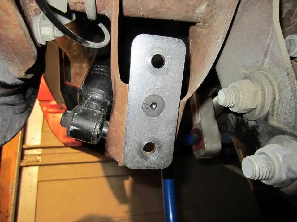

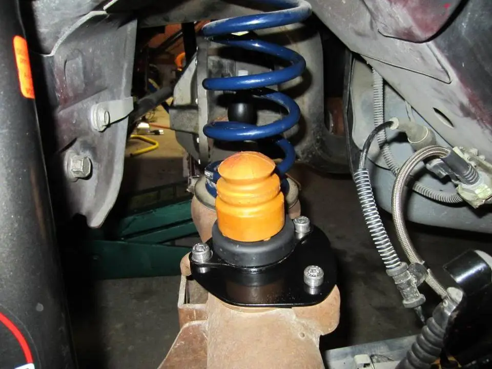

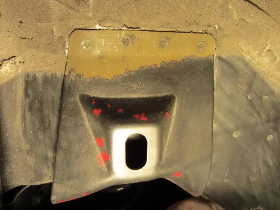

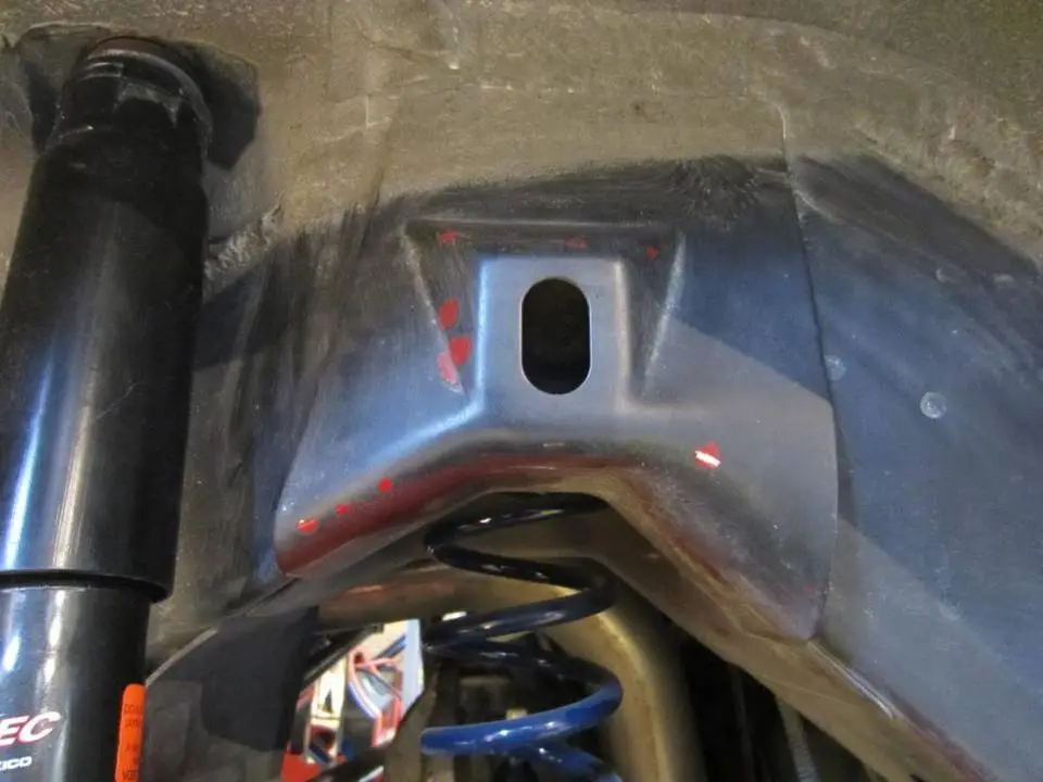

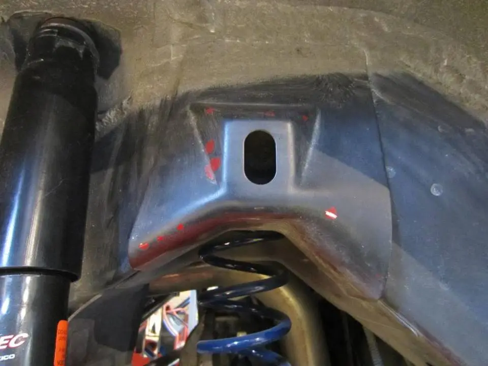

I removed the bump stop to the side of the frame and re-positioned the bump stop on the axle housing with a relocation plate to make everything work. Here are a few pictures:
OEM bump stop on frame.
Cleaned off the undercoating to see where to remove the spot welds.
Spot welds removed.
Frame bump stop cut off.

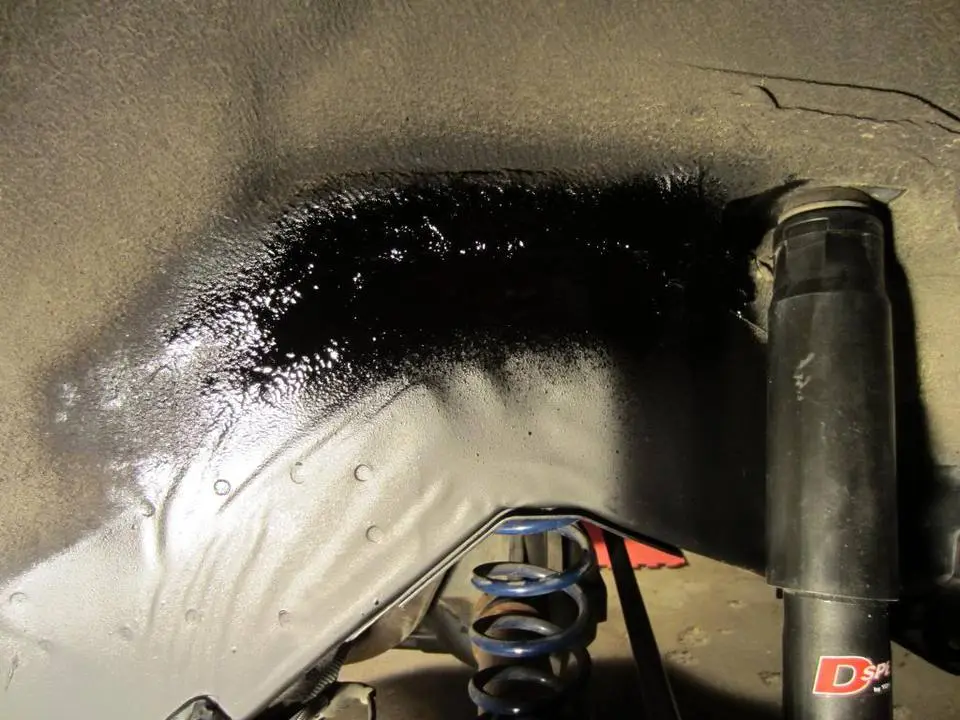

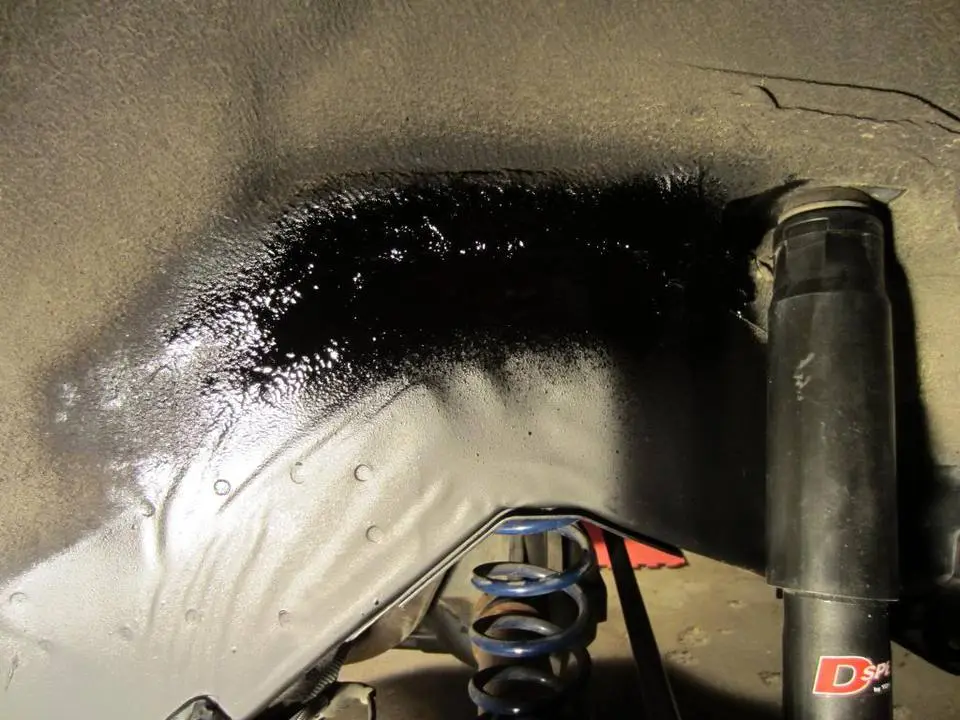

Undercoating applied.

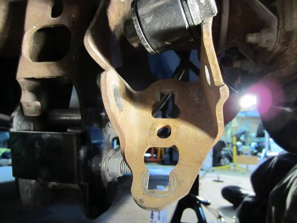

Fabricated a relocation plate to move the bump stop to under the actual frame rail. (note bump stop not yet trimmed down in this picture).
