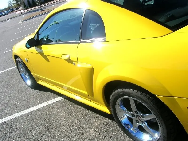

17x9's with 275/40/17 BFG's all the way around ftw.
