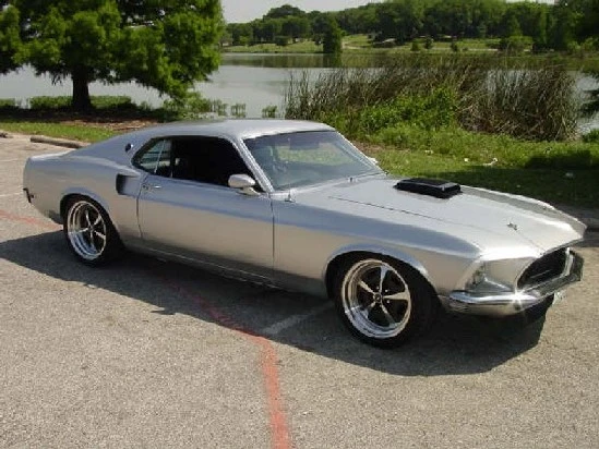

btw, now i'm stuck between those gtx wheels and the 18" mag 500's...i'm just not sure... the good thing about the 500's is that they look so retro and right on the car...and luckily, i have a pic of an almost identical car with them, and it looks great. i'll post it up in a sec.
brad
here it is:
I love the 18" billet 500 mags!!! They look SWEEEEET! That would be my choice. I like them better than the late model mach 1's because they have more of a lip on them than the 03's. Plus they are nice and shiny!!!

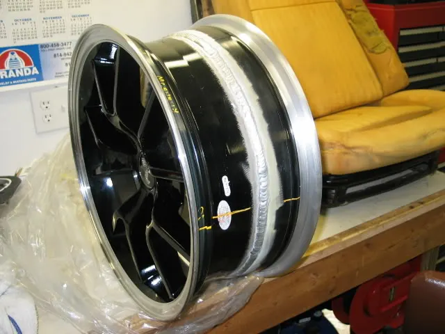

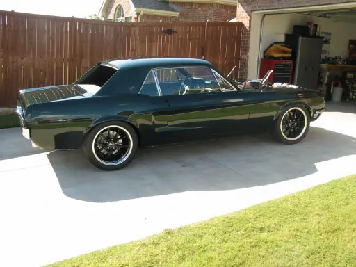

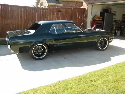

The FR500 will fit. My 68 copue has 18x8 (narrowed 18x9 +36)on the front with a 245/40 tire and a 1/4" spacer to keep the rim off of the upper control arm at full lock. The GW front springs have 1 full coil removed. Your 69 might have enough room for the 18x9 without narrowing.
On the back I have 18x9 (+24) with a 275/40 tire and no spacers. I had 18x10's with a 295/35 tire on the back but it rubbed a little so I went smaller instead of raising it up. I had the GW leafs dearched 2". In this pic the car still has the 18x10's. You might be able to squeeze in the 18x10 295 combo.
