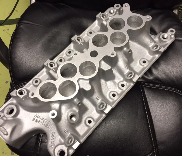

For stock heads..no. Not worth the $$.
Run the exporer 19# injectors of you have them. They have an optimized spray pattern that's more updated than the mustang ones. Use the mustang fuel rail.
Later on if you do big heads and want to keep the explorer intake, just pick up another lower and have that done. They are a dime a dozen....even for the less numerous -BA lower (egr equipped)
Here's my tmoss ported explorer lower waiting to get swapped out for my cobra lower. Just a sexy paperweight at the moment

His quotes vary depends on what you are doing exactly but after shipping and any extras (drilling for act, coating, etc) you are in the ballpark of $300-400 give or take.
For stock e7s it's not necessary. The intake as is will outflow the head.
Intall the explorer intake, grab a 70 or 75mm egr spacer, modify the explorer 65mm TB if you have it, run the explorer 19s and you should expect 10-15 HP over 3000 rpm with no loss of low end torque.
