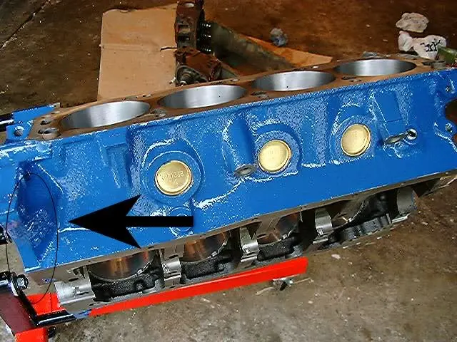

You can find the year of the engine block by looking at the casting numbers, but that does not mean that it has stock pistons in it. I would suggest pulling the heads to check for sure. It is a pain to do all that work just for some info, but that is the only way I can think of to know for sure. The block casting numbers are on the underside in the rear. Cant remember which side, but I am fairly sure they are hidden by the headers? maybe someone else should try to answer that.
