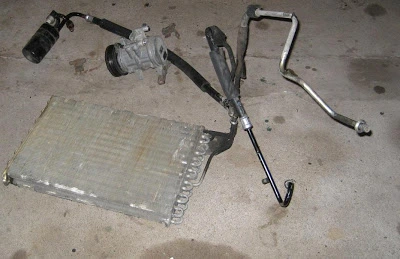

A/C
I just removed my A/C a few days ago.
It's gotta be a good solid 60 lbs or so.
I could not believe how heavy that compressor is !
