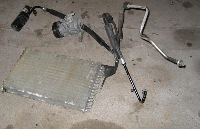

I just removed my A/C a few days ago.
It's gotta be a good solid 60 lbs or so.
I could not believe how heavy that compressor is !
How long did it take to removed the A/C and can you weigh it by chance?
It took me about an hour and a half to remove it all, but you can probably do it faster. I have a really deep aluminum radiator which I had to drain and remove. Also I was fighting with the A/C line disconnect tool at the firewall for a good 10 minutes. Those things suck.
Anyway...
I weighed it all tonight.
A/C Compressor 17 lbs
All other A/C lines and crap 9 lbs
For a grand total of 26 lbs :shrug: (sorry my guess was way off)
Every little bit helps though and the engine bay is SOOO much cleaner without it.

what about the condensor? is that included in there? and all the mounting brackets as well? I'm sure everything i took out was more than 26lbs, but i know it can be deceiving
yep
Yes, that includes the condensor and all lines.
The condensor actually hardly weighed anything, the compressor and it's bracket was most of the weight.
I weighed everything in that picture I posted before.
