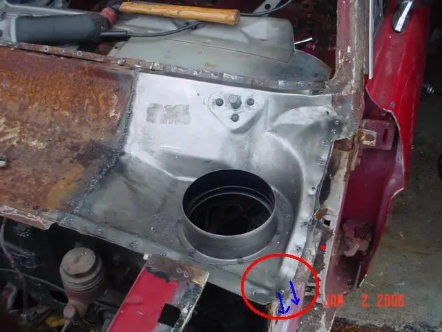

This is how it would drain from the cowl area. It would drain down the side of the inner fender and find its way in as you described at the rocker/inner fender joint.
