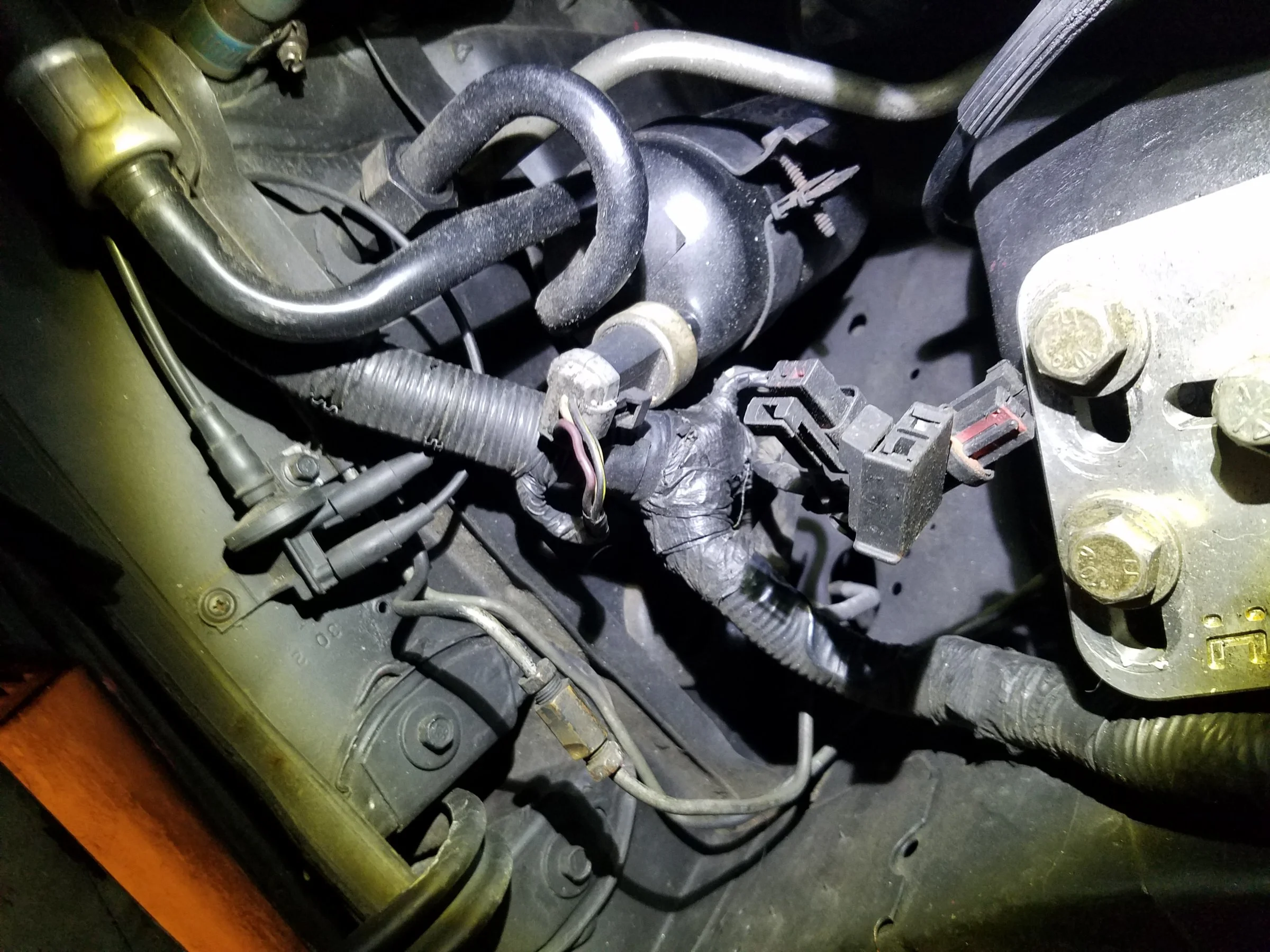

Just trying to get my 93 LX coupe to pass emissions and I need to locate the EGR vacuum switch. Egr doesn't have vacuum going to it and I don't see the switch. Also what are these 3 connectors for? Thanks!

Look like they are missing, there should be a couple switches with vacuum lines on the rear of that shock tower.
I have some from a 91, they maybe compatible
What's a reason someone would remove them and what exactly would I need to buy? And if you have any info on those 3 connectors in the pic it's appreciated.

The 3 plugs are for the 3 solenoids. EGR, TAD and TAB. The TAD/TAB are for the smog pump system (which I assume is missing as well?).
You are missing all three, along with associated vac line plumbing.

First question: stupid advice from someone that knows nothing about what makes these cars function/thinking it will make the car faster.
Second question: was answered in mustang5l5's post
Was not sure if it was 2 or 3 switches, now I know,
Thanks @Mustang5L5 are the switches the same from 91 to 93?

Searching on Rockauto.com, I see the same part number used 1987-1993. About ~$20ish
So to replace the missing egr switch is this all I would need
https://lmr.com/item/LRS-9459B/1986...19__USkYPIA3W-O3i5Tv6WnqvXc6Z2tdVPGgLVZ_D_BwE
As far as the other 2 solenoids I'm not going to replace because I don't have cats anyway.

Yes. It's half the price on rockauto.com.
How do you plan to pass emissions without the cats and related air tube?
There's a few places around me that will pass emissions without cats but I'm not sure if not having the egr hooked up will give me problems.
