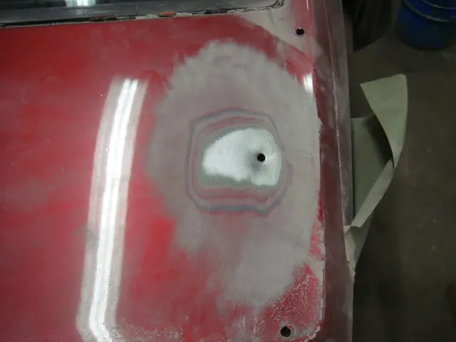

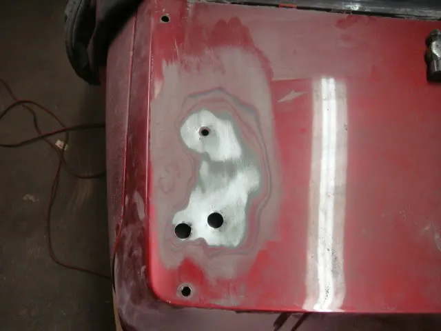

btw.....be aware you have to fill three holes total, and drill a new hole for the 3rd brake light wireharness to add a Cobra spoiler to a GT hatch. I just did this last night. I wasn't too thrilled to do this. And you are supposed to drill 4 more holes for the middle part of the wing, which I am NOT doing.
After I ground the paint off, I dented the holes in with a hammer and bondoed over them. I didn't weld them up because I didn't want to start warping everything and make a huge mess. 90% of what I did will not be seen, but it will be nice and flat because I feather sanded everything and blocked it out before bondo, after bondo. I sprayed 3 coats of 2K Urethane primer and called it a night. I will block them again today and they're good.
I did NOT fill the highest and lowest hole as it appears, they are taped off. I only filled the large wire harness hole on the right (the big hole to the left is the new one)
