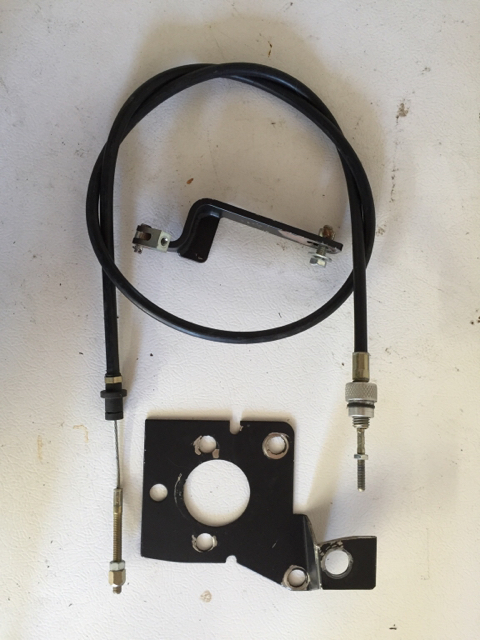

I've got a cable setup from Modern Driveline I'm looking to sell. New, installed and then decided I wanted to go hydraulic so my wife would be more comfortable.
Make me an offer if you're interested.
It was a sweet set up and felt fine even with my stuff clutch. Very smooth.
