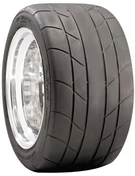

I have Mt 315/35/17's I couldn't be happier with them. I have drove a few times and the rain and it wasn't to bad. The newer wider 17's from MT have an improved thread pattern. I picked up .5 in the 1/4 the very first time I used them and .9 over all. They also handle well at higher air pressures.
Here's the new pattern.

jive can you give me a link to where i can find those exact tires
jivepepper
Jun 19, 2002
776
18
Under a Sombrero. in WV.
Dec 25, 2007
#20
  • Dec 25, 2007
  • #20
MT's site
http://www.mickeythompsontires.com/strip.php?item=ETStreetRadial
Jegs site. This is where I bought mine. Just scroll down
http://www.jegs.com/webapp/wcs/stores/servlet/product_10001_10002_753925_-1_36685
