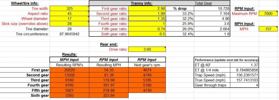

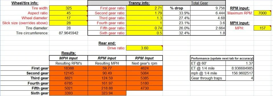

I'm in a grey area regarding which 1-4 gear set to use with the T56. The two options are the 2.71/1.79/1.3/1 gear set, and the 2.98/1.99/1.35/1 gear set. I am simultaneously concerned that I will bog with the 2.71 ratio and that I might blow through either gear set in 1st once the turbo spools.
One advantage with the 2.71 gear set is that if I ever run 1/8 mile, I should be able to finish the 1/8 mile in 3rd gear. It seems like reducing rwtq and extending 1st gear is a good idea, as long as the motor doesn't bog, but as you can see, even with 3.60 gears, the numerically low tranny ratio, and the 28" tires allow me to go ~60mph by 7k RPM (my motor's redline).
Here's the comparison between the two. Ignore the performance figures, as 60' times are manually input and may not be accurate.

You are running pressurized induction, and a turbo at that, You will have an excess amount of low end torque to try to communicate to the pavement. That means your best results will be with a 2.71 gear set to limit the torque multiplication. With proper traction aids and setup, that should put the torque at the tires in a range for best grip and maximum acceleration. Too much 1st gear will smoke the tires all the way through 1st and into 2nd.
Well, there are some numerically lower 1st gear ratios that g-force can put in, like the 2.62 and 2.29. If I go with too tall a 1st gear, eventually the car will bog and potentially lose the ability to spool off of the line, even with a 2-step.
I'm in agreement with you about smoking the tires. I'm just concerned that a 331 isn't going to make a ton of torque off of the line.
You should have plenty of torque IMO. You may potentially have to run a higher launch rpm to get the wheel speed up to keep from bogging but I would run that 2.71 or 2.62 gear. I don't think a bog is likely anyways. Now with a 2.29...I'm less confident. With your suspension/tires I don't think you'll blow the tires off with either of those gear sets but it's just my opinion based on a few racers I know locally.

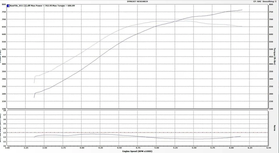

The turbocharged cars typically have a broad, flat torque curve that starts low and climbs a little until just before peak HP. I haven't seen the dyno sheet from your setup, so I can only guess what the torque curve looks like. Posting your dyno sheet, or a link to where you may have previously posted it would be very helpful.
A wild guess tells me that by 2200-2500 RPM the torque curve looks pretty healthy. Pull up to the starting line, rev to 1800-2100 RPM and let out on the clutch, hard as you floor the accelerator. The rear tires should break loose a little and the RPMs rise into the range where the torque curve looks really good. Then the tires hook hard as the weight shift and traction assist that you have tuned into the suspension begins to work. If you did you suspension & tire tune correctly, you probably will need some wheelie bars to keep things under control.
Here's the first dyno. It's unfortunate that I don't seem to have the 2nd dyno which showed the curve from about 3000RPM on up to 7k.
Anyway, the turbo spools around 3300-3500 if memory serves. I'll probably be launching on a 2-step from in neighborhood of $5k RPM. Keep in mind that until now, I have not had a tough enough drive train to set the turbo on kill. I felt like even at the power limit below, I was pretty hard on the TKO (rated at 450 ft-lbs), and the 28 spline 8.8" rear end. I kept it on 275/40/17 MT DRs and fortunately didn't blow anything up.

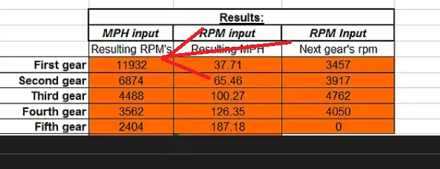

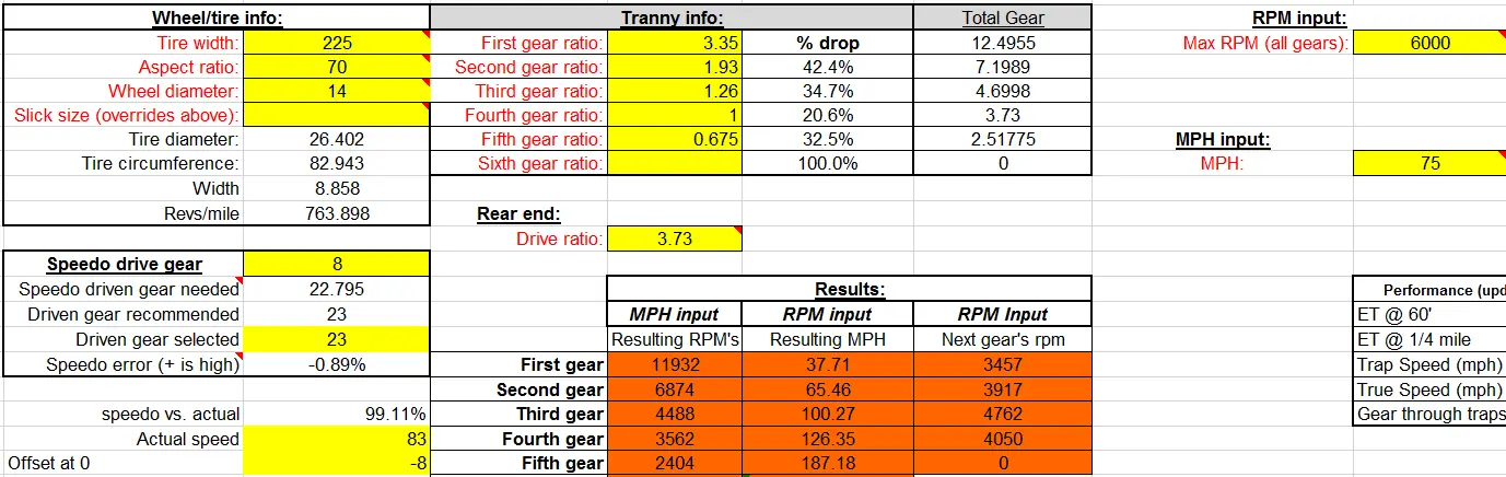

So, I prioritized a balance of performance vs. reasonable cruise RPM, assumed a 6000 RPM redline, and your eventual preference of 225/70/14 tires. The column under "RPM input" tells you your speed at redline (6k) in each gear. The red/orange column under "MPH input" shows the RPM in each gear at 75 mph. So, looks like you'd be taching 2,400 on the highway.
Assuming your car makes 300 rwhp or less, you are not close to optimal for 1/4 mi. with this setup, because this setup would be optimal for a car that runs 126mph-ish through the traps. I have no idea where you are, but based on your hypothetical against a Honda Odyssey, you'd probably struggle to break 100mph in the 1/4. So, if you wanted to optimize the launch & the 1/4 over highway cruising, then 4.30s would probably be about right.
When it comes to performance, "don't fear the gear." If you want a nice car that will cruise alright on the highway, maybe a tad high, but will also come off the line nicely and do alright on the 1/4, then 3.73s are my vote.
