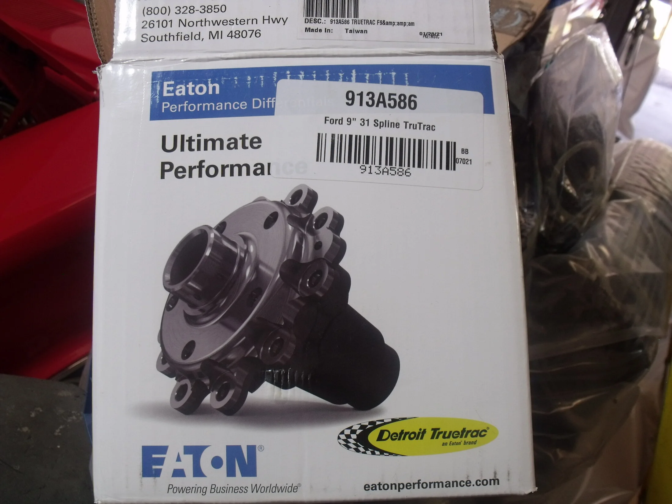

And yes I will be going with an Eaton TrueTrac helical-gear style, limited-slip differential. I'll be storing the original open diff along with the original 3spd Top Loader, and original bell housing.

Awesome choice on the diff. Didn't know what kinda budget you were thinkin of
Yeah the fact that I don't have to run friction modifiers with the true-trac and the reviews were so good it was the choice....I thought about going with a nodular gear case, but think it is overkill for such a low HP car (about a $500 difference). BTW I'm getting the whole center section so I can keep the original senter section as a unit.

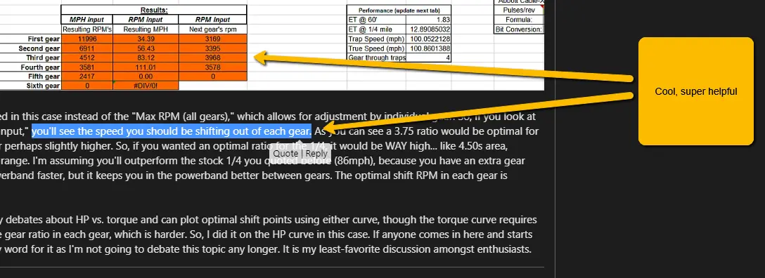

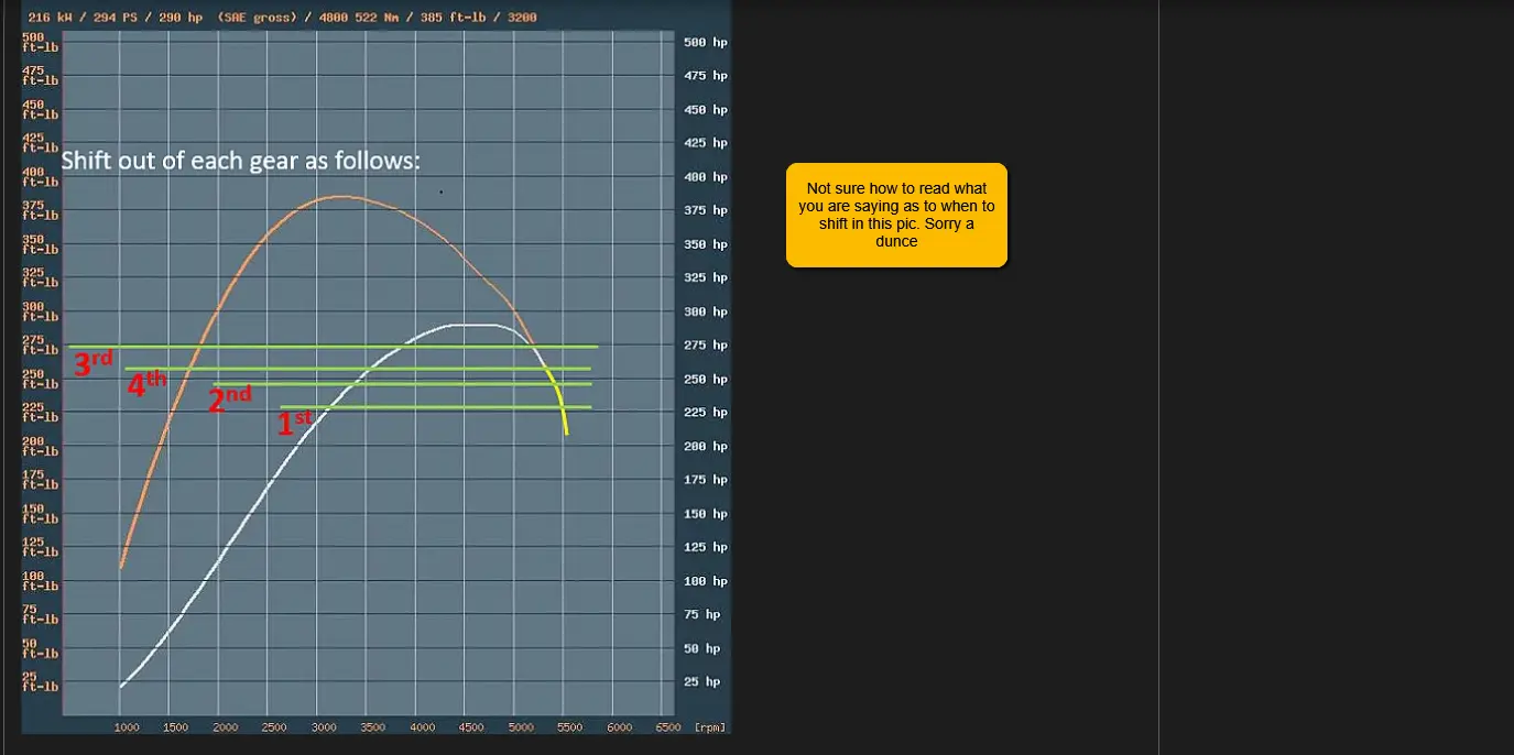

I took a little liberty with the dyno, as they ended the run at around 5,300 and it looks like your optimum shift points are higher in all but 3rd gear. So, I extended the curve out to approximate what it looks like the rest of the dyno would look like (yellow). Then, I plotted the shift points such that the rising HP curve in the next gear intersects the falling HP curve in the current gear (Green). If your car runs like the one in the dyno, these will be your approximate optimal shift points with your T5. Word of caution: Don't overshoot, as the HP curve is dropping off precipitously. You're better off short-shifting than over-revving.

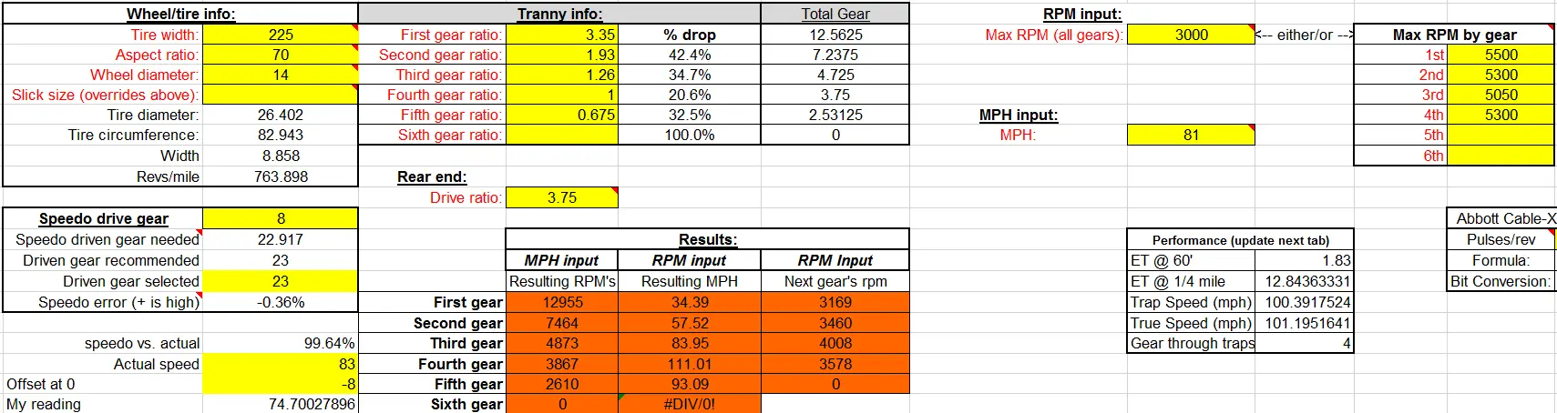

Here's what that looks like on my gear gonkulator:
Note the "Max RPM by gear" was used in this case instead of the "Max RPM (all gears)," which allows for adjustment by individual gear. So, if you look at the orange/red column under "RPM Input," you'll see the speed you should be shifting out of each gear. As you can see a 3.75 ratio would be optimal for a car that traps 111mph in the 1/4, or perhaps slightly higher. So, if you wanted an optimal ratio for the 1/4, it would be WAY high... like 4.50s area, assuming a trap speed in the 93mph range. I'm assuming you'll outperform the stock 1/4 you quoted before (86mph), because you have an extra gear which not only gets you into the powerband faster, but it keeps you in the powerband better between gears. The optimal shift RPM in each gear is independent of your rear gear ratio.
Side note: I have been in soooo many debates about HP vs. torque and can plot optimal shift points using either curve, though the torque curve requires replotting the curve multiplied by the gear ratio in each gear, which is harder. So, I did it on the HP curve in this case. If anyone comes in here and starts to argue with me, please just take my word for it as I'm not going to debate this topic any longer. It is my least-favorite discussion amongst enthusiasts.

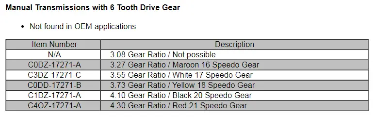

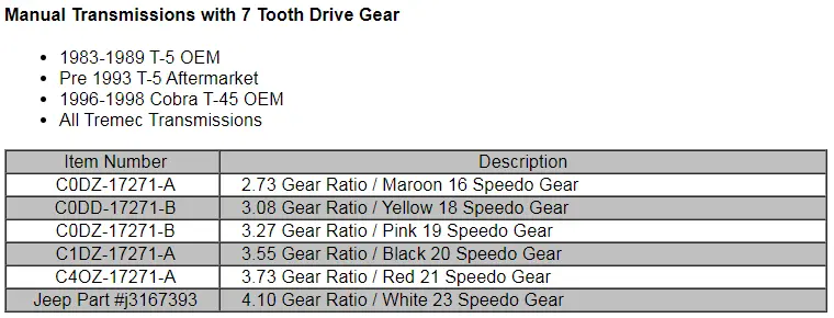

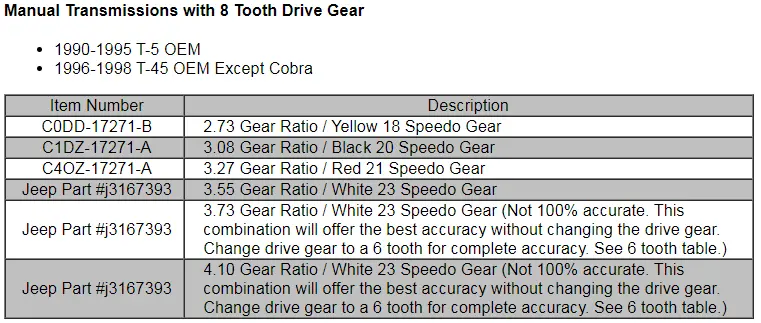

Just a word of caution here, I'm not sure and in fact I don't think that after market companies all use the same color scheme.

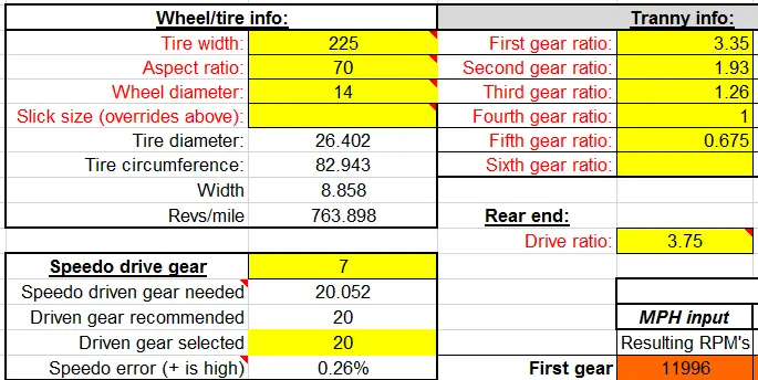

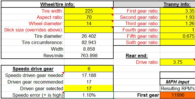

I typically use my gonkulator, but here's a couple helpful tables from something I saved some time from before I can remember... If you stick with an 8-tooth:
If you go with a 7-tooth:
If you go with a 6-tooth:
Here's what the gonkulator says:
6 tooth:
7-tooth:
You've already seen the 8-tooth gonkulation in an earlier post. I don't know why the gonkulator disagrees with the tables, but I trust my math. So, I'd go with the gonkulator. The 7-tooth with a 20 is very, very close.
Edit: Matter of fact, yes I do know why they disagree. The tire size isn't accounted for in those tables and your cited tire specs should make your tire taller than a stock fox's, and the gear ratio is off by a fraction. If you have an exact tire size, we can put that in there. The manufacturers exact tire sizes don't match the sidewall specs exactly, but they usually publish their tires' circumferences.

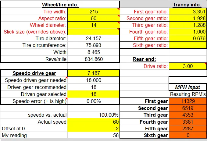

Ok. So, according to your earlier assertion that you have an 18 tooth driven gear, the math says.... drum roll please....
For the math to be perfect, based on all the inputs, you have a 7.187 speedo drive gear. There's slop in all measurements. When you get to splitting hair, the tire circumference isn't going to be perfect according to the calculations due to manufacturing, wear, tire pressure, etc... The GPS and Speedo readings are going to be at best within ~1mph (2% at 50mph), etc... So, if you really do indeed have an 18-tooth driven gear, then it looks like you have the 7-tooth speedo gear you suspected.
Given that you thought you had an 18-tooth driven gear, and also stated you thought you had a 7-tooth drive gear, and given the fact that the math works out to support that idea, I'd say that's what you have. That's great news! That means that if I do successfully convince you to go 3.75, a 20-tooth driven gear will work perfect, and it won't chew up like an 8-23 speedo drive-driven gear setup would.

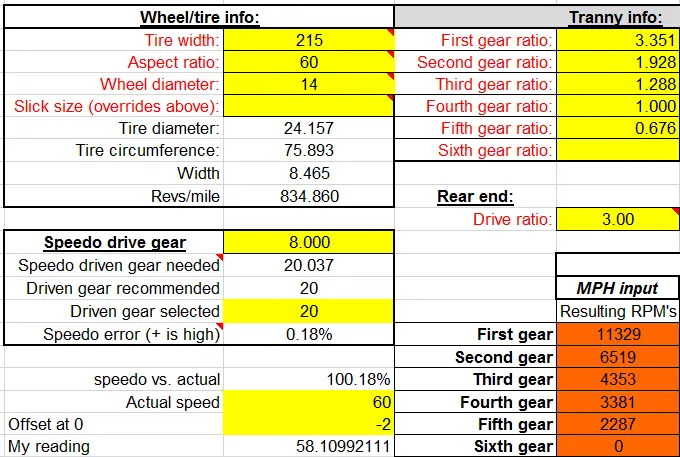

If, on the other hand, you find a 20-tooth driven gear when you get in there, then you'll know you have an 8-tooth speedo drive gear:
... but it sounds like you've validated your 18-tooth driven gear assertion.
Now, with regard to your tach, here's what the math says (based on GPS Speed, which is assumed to be true):

Hey, by the way, I noticed in your thread about this stuff, you list your transmission's gear ratios stating you think you have a 90, but then the gear ratios you list are for that of an 86.5-89:
WC T5 '86.5-'89 (2.95 1st for T5Z)% dropWC T5 90-93(2.95 1st for T5Z)% drop
3.350724638​
7(83-89) or 8(90+)
3.350724638​
1.992438563​
40.54%​
1.928166352​
42.46%​
1.325337331​
33.48%​
1.287517532​
33.23%​
1​
24.55%​
1​
22.33%​
0.676492262​
32.35%​
0.676492262​
32.35%​
The T5Z would have a 2.95 1st. The earlier trans (83-89) has a 7-tooth drive gear. The 90+ has an 8-tooth. So, maybe, despite whatever car it came out of, the trans you have was originally an early WC T5.
