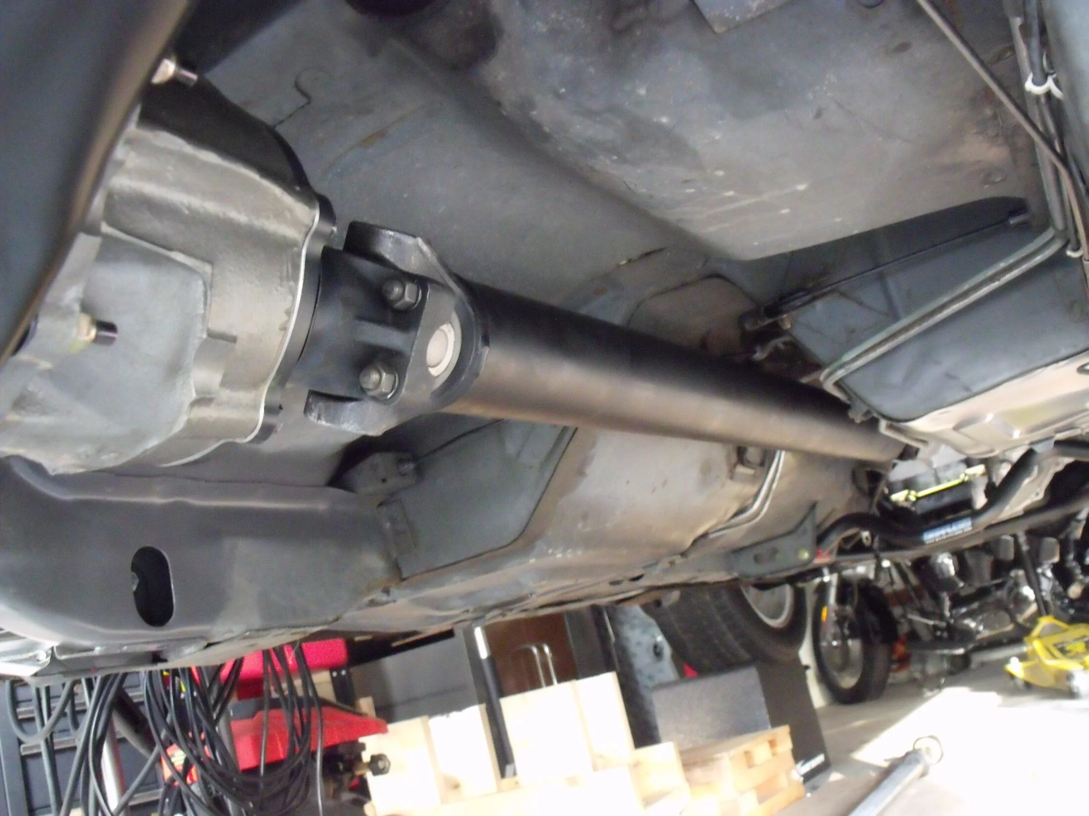

When I did mine I subtracted 1" for net length..
As said above, do this when he car is down and settled on its suspension... I have race ramps so it helped alot.. You can see one on the front left wheel/tire in the attached pic..
1350 u joints on mine..
Reactions: General karthief
