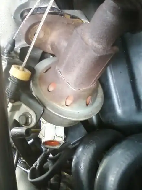

This is under throttle cable is this the EGR valve? Or solenoid I read that EGR will have a P stamped on it none of these do as far as I can see
Or this is under MAF/CAI housing
wanting to replace EGR valve hoping its my engine not idling prob
The first pic is of the EGR valve.
