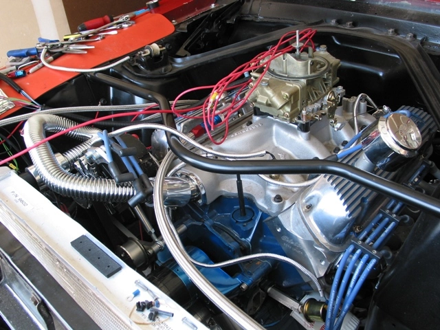

I really think something is screwed up with my inner fenders or something. I talked to NPD and the straight 6 just has a "special bend" to clear I think the air cleaner or something. It still doesn't mount up as far as the bolts go. The v-8 bar I have has 2 holes on top and 2 on the vertical and only 1 of those holes line up.

Well, it all depends on where the misalignment is but there are never enough holes for all the bolts to be used. If you want to use all the holes you'll have to drill. That is overkill but unused holes are unsightly IMO.
Plus sometimes the inner fenders need to be spread a little due to ~40 years of sagging in order to get the bar to seat right.

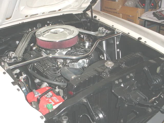

The point of pressure on the ones that use the top of the shock tower brace are at an ANGLE. Of course the export brace is too but where the transition occurs is about the strongest part of the brace. If your goal is stiffness I haven't seen one that will work any better than the original ones. If you are looking at it for cosmetics then most of the aftermarket ones win, but not as much in my book as in other folk's. See, I am still a pushover for much of the '60s FoMoCo appearance, Cobra finned valve covers, blue block, etc.

66moneypit said:
Huey....I didn't see your brace on there. Do they sell the brace I saw in your pic ? I just call them up and ask them for it ?
I still had the original curved brace on it in that picture with the HEI. I haven't updated the picture since I changed to the MPG unit but it still clears the HEI but from behind it with a slight bend. I do drag race every weekend and I have not noticed any problems with flexing.
