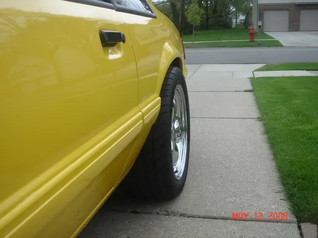

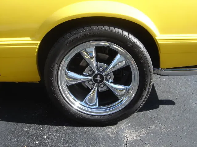

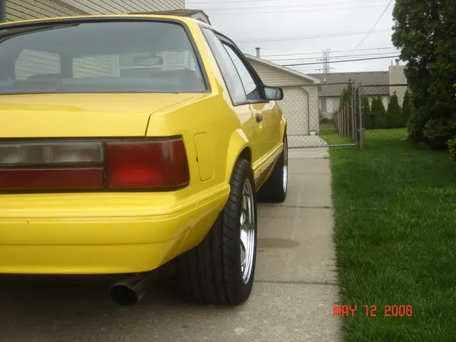

Here is my 17x9 bullits on my fox with 285's

If you go 17X9 buy some 275-40-17's or 285-40-17's.
