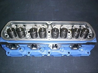

Thanks guys... yes, the two heads have the same port and bowl work, the cost differance is the springs!! the only set of heads I had fail.. ( yeah, it happens) was a set pushed beyond the valetrain limits... Long over revs.. SO I strongly suggest the spring up grade!! cool?? Yes the springs are good for Hyd roller cams up to .600 lift, and yes, cams that big are way over the power of the heads... but it is better to by that up grade, than a set of heads from others ( Others: the guys on the other side of the island) that only have " .550 lift" capability's.. yes??
12s is there with the ported E7s or the Ported GT40s... and they are a lot less than a set of the alum heads, esp after you have to buy the pushrods..ect to make them work!! LOL
Have fun..
