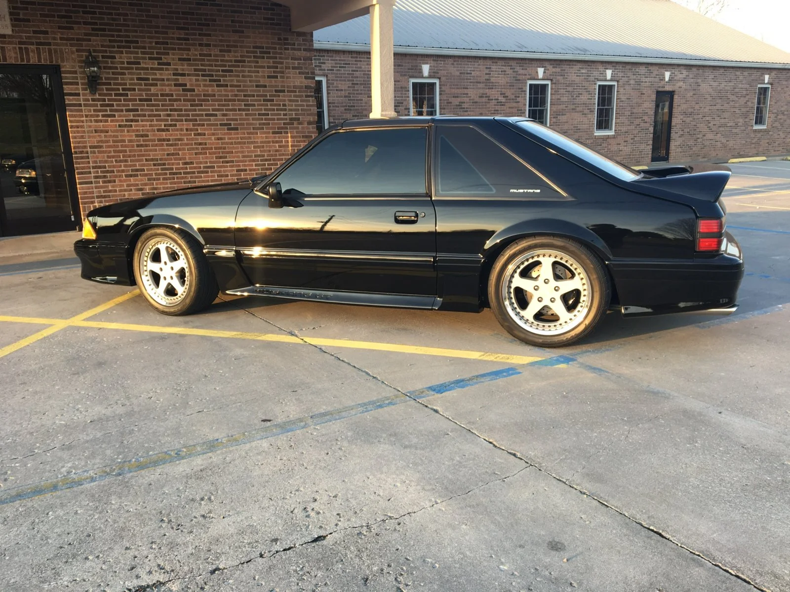

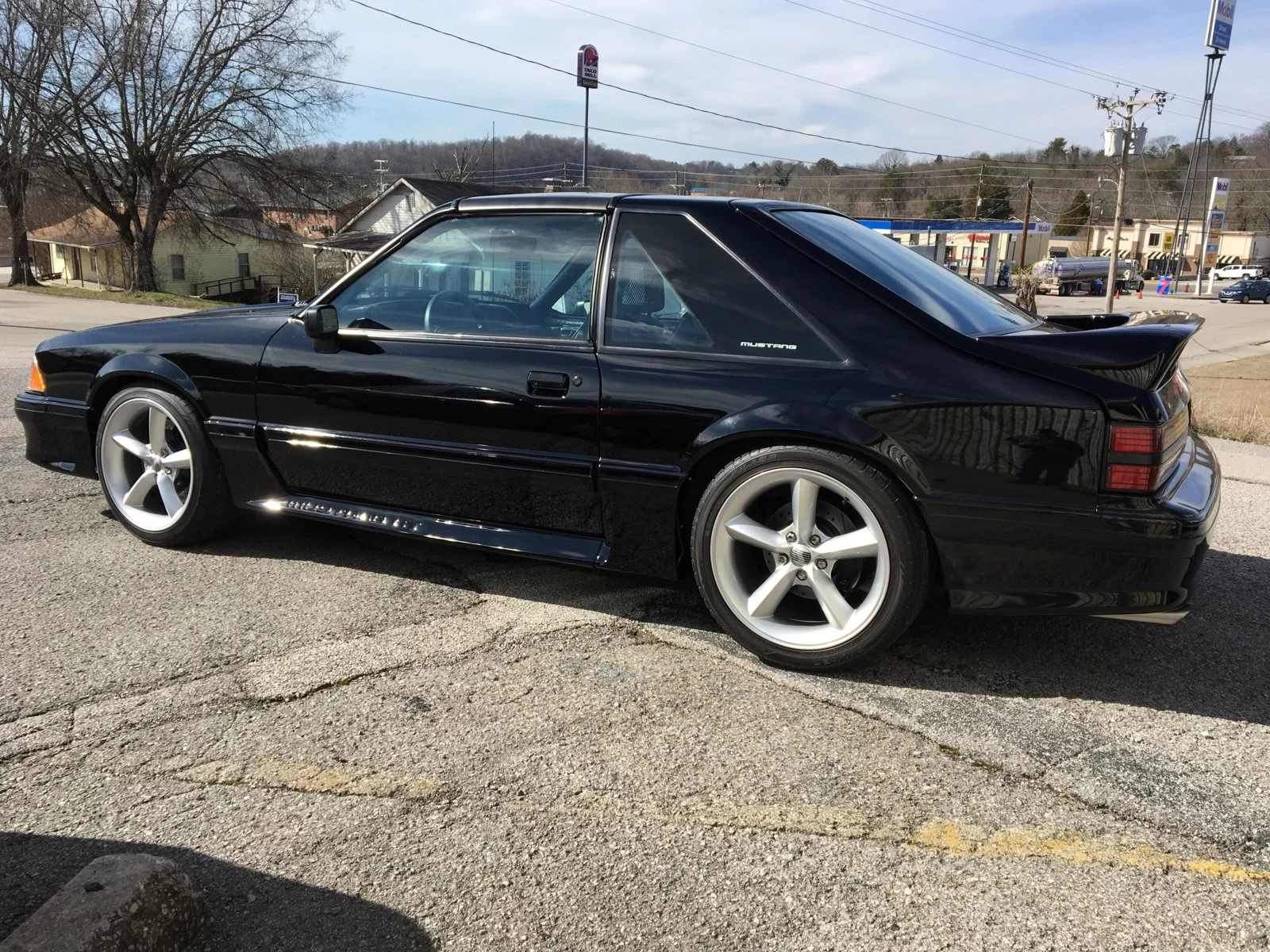

Up front 18X9's with a 245/40 tire rub on my car, and Im barely lowered. Cant remember, what year is your car? Mine is an '89 with the smaller front fenders. I would consider an 18X8 with proper offset to tuck and still be able to turn. My 18X9s are a +30 offset and stick out with '94-'95 front spindles. I bet an S197 offset with '96+ spindles would fit well. Matter of fact, @95steedamustang , what is your set up on your T Top fox? If I remember right, I think its S197 offset wheels with '96+ SN95 front spindles and an SN95 rear axle?

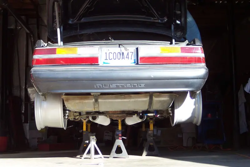

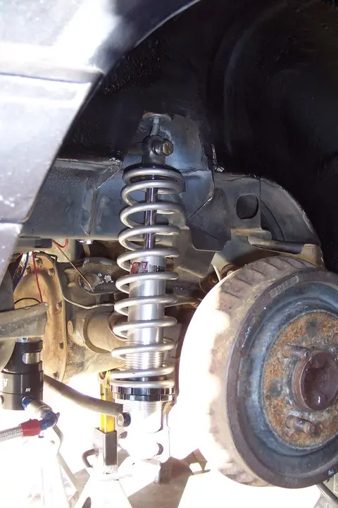

My shop charges $4,000 to do the complete mini tubs and narrow the rear end to properly tuck the rear wheels. That includes rear coilovers and shocks/mounts.
My T-top had 96 spindles and I was running a 08 Saleen heritage wheel 18x9 and it would rub slightly on turns but mine was slammed. But the rear wheels only work with a Saleen/Svo axle setup and I had widened them to 10.5 inches
Then I decided to redo a set of 3 piece Saleen sterns. So I fabricated my own drop spindles to bring the front wheels in 5 mm and now run an 8 in the front and 9.5 in the rear.

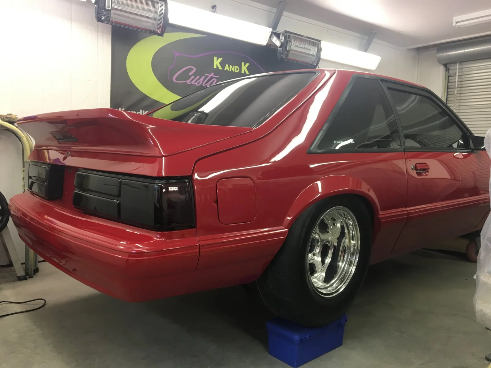

But on the topic, I just looked at the car in the first post. Only way your getting that look is mini tubs and air ride. This latest hatch project already has the tubs and narrowed rear but is probably getting air ride next to get that same type of look. Without the stupid truck fender flares.

It's gonna take more than just a mini tub to accommodate an 11-12" wide wheel. A 7.2" back spaced 10.5" wheel will push this far back on a stock length fox rear.

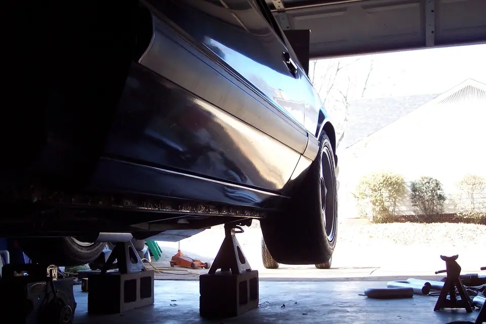

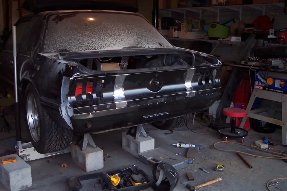

This was my first build here. https://www.stangnet.com/mustang-fo...-swap-progress-thread-project-89mach1.831329/
The first several pages detail the mini-tub. The wheels are 10.5", 7.2" back spaced Pony R's

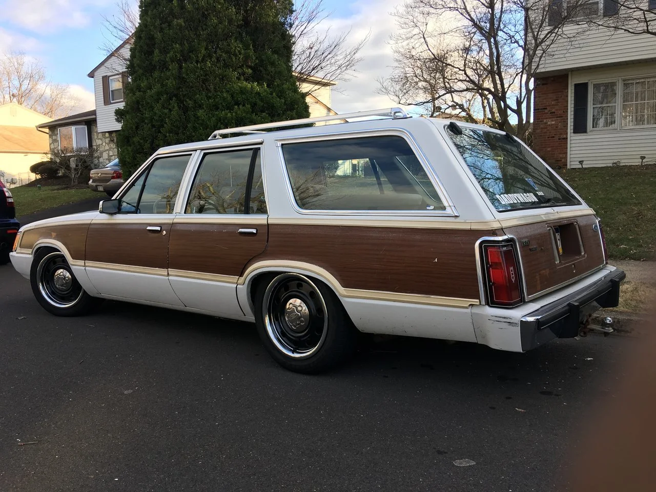

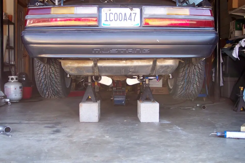

I’m tucked! 17x7.5 06-11 crown vic wheels with 225/50r17 firestone wide ovals. 25mm spacers up front and cobra irs out back with stock cobra springs. Don’t ask me how it ended up so low in the back... it just did without any effort on my part. Must be a difference in upper spring perches between 1984 and 2004.
