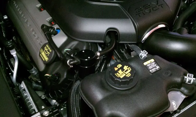

I've got the black JLT. Great quality, fit is like factory as they use FoMoCo lines.
JLT Oil Separator [JLTOS] - $119.00 : JLT PERFORMANCE, Home of the JLT TRUE COLD AIR KIT
Pic of it on my car:
this is why and definately go with the JLT, it's much nicer, uses factory fittings and comes pre-assembled, takes 2 minutes to snap it on

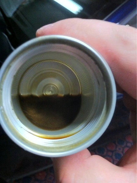

Washed my car today and I checked my JLT oil catch can too. Had a little more than a tablespoon of oil in it after 300 miles. From what I understand, the harder you drive your car the more oil you'll end up with in the can. Personally, I think it's well worth $119 to keep that out of the intake. Sure, it may not severely hurt the engine, but it definatley won't help it either.
