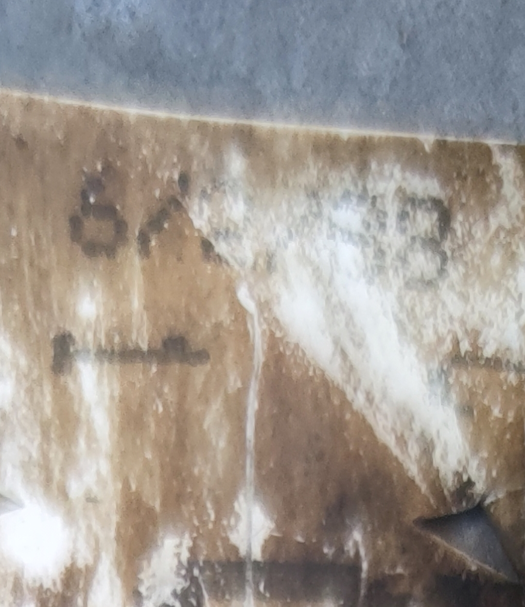

Ford used a simple casting code to date certain cast parts.
The heads will have a 4-digit date code under the valve covers, and the block will have a part number and date code cast in the starter area.

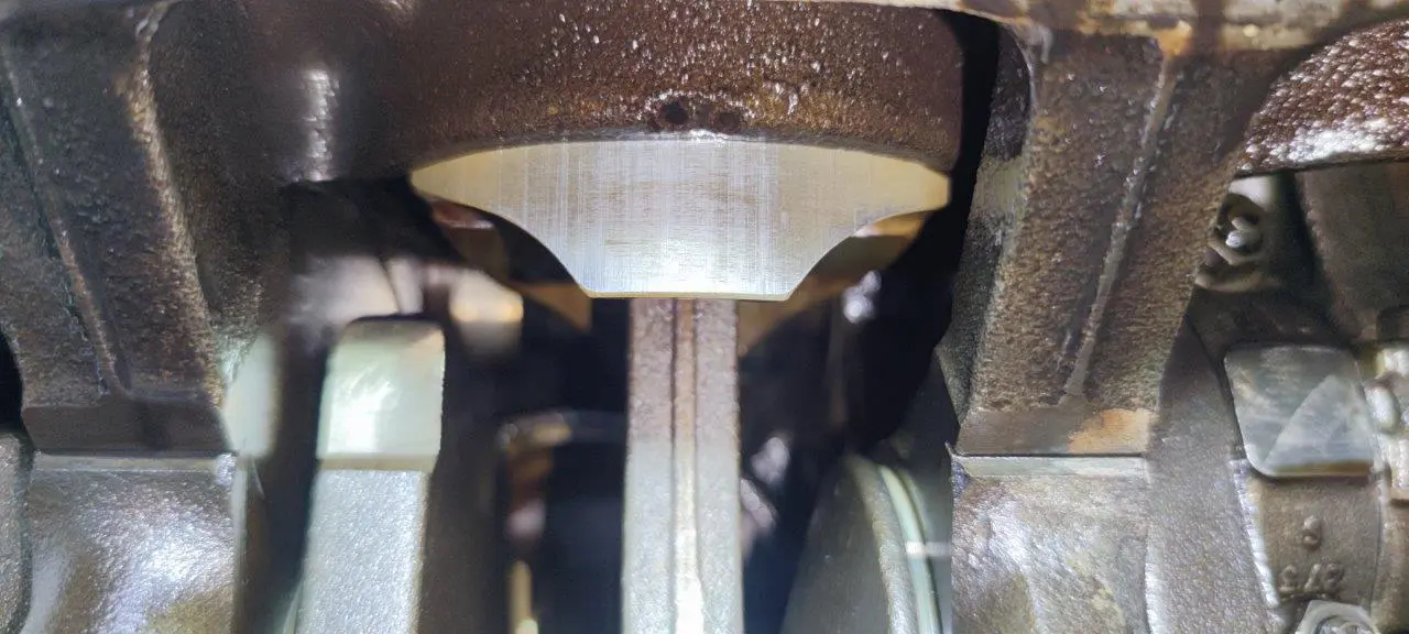

Pulling the harmonic balances tells me there is radial (left-right) and axial (front to back) play on crank. Left-right may be chain, but front to back is well-known thrust bearing. I will measure how much it travels today with 0.001mm resolution feeler.

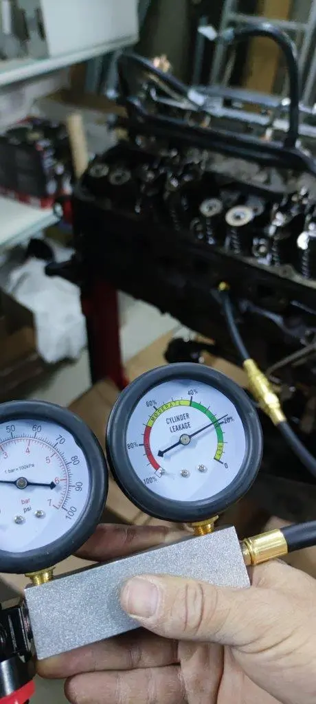

Before any teardown: Cylinder leak test showed 15-20-25% across all cylinders except #2 and #4 which are leaking to intake (#2: 50% -#4: 70%). I plan to remove rockers on thoose two and re-test.

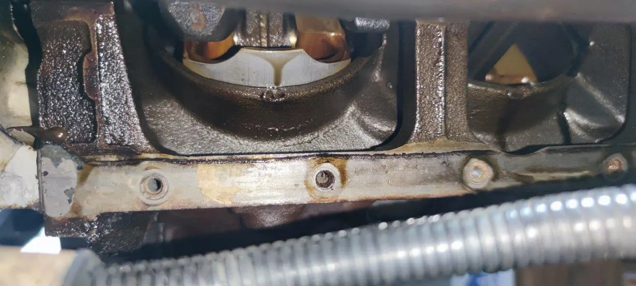

From what I saw under valve cover and with removed oil pan, this engine is much, much, much more cleaner (yes, three times) than was original "tacky-black-soot-dirty-sticky" one so this also may we a sign of better service during life.

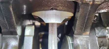

Piston skirts show few scratches but nothing close to wear from original one. I might get away with re-ring only...

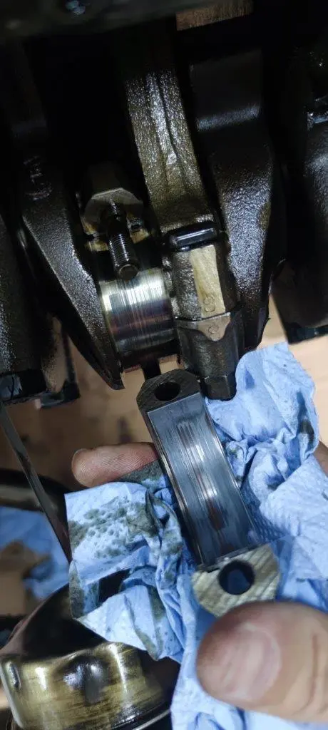

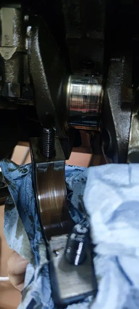

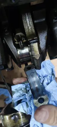

I took #4 bottom rod cap out. This engine was rattling like crazy last time it worked for sure...
Chewed bearing down to metal and damaged crank - I can clearly feel grooves on journal.
I also took #2 main cap off and bearings also had some debris and are down to copper.
Crank grinding will be neccessary.
So, fine particles in leftover oil I saw were not just my imagination. Let's just hope that none of them is spun. Engine was turning nice...
Piston skwirts have some lines, but I would really like to re-use them if possible with re-ring and hone.

Leakdown problem with #2 and #4 was resolved with removing rockers and few rubber hammer blows to intake valves.
All cylinders show leakdown 20-25% and are leaking to crankcase.

That piston skirt looks OK to me. Have you measured them ?

@90sickfox I need to get to them (pistons) to measure them. Good luck to you with those 3 engines :)

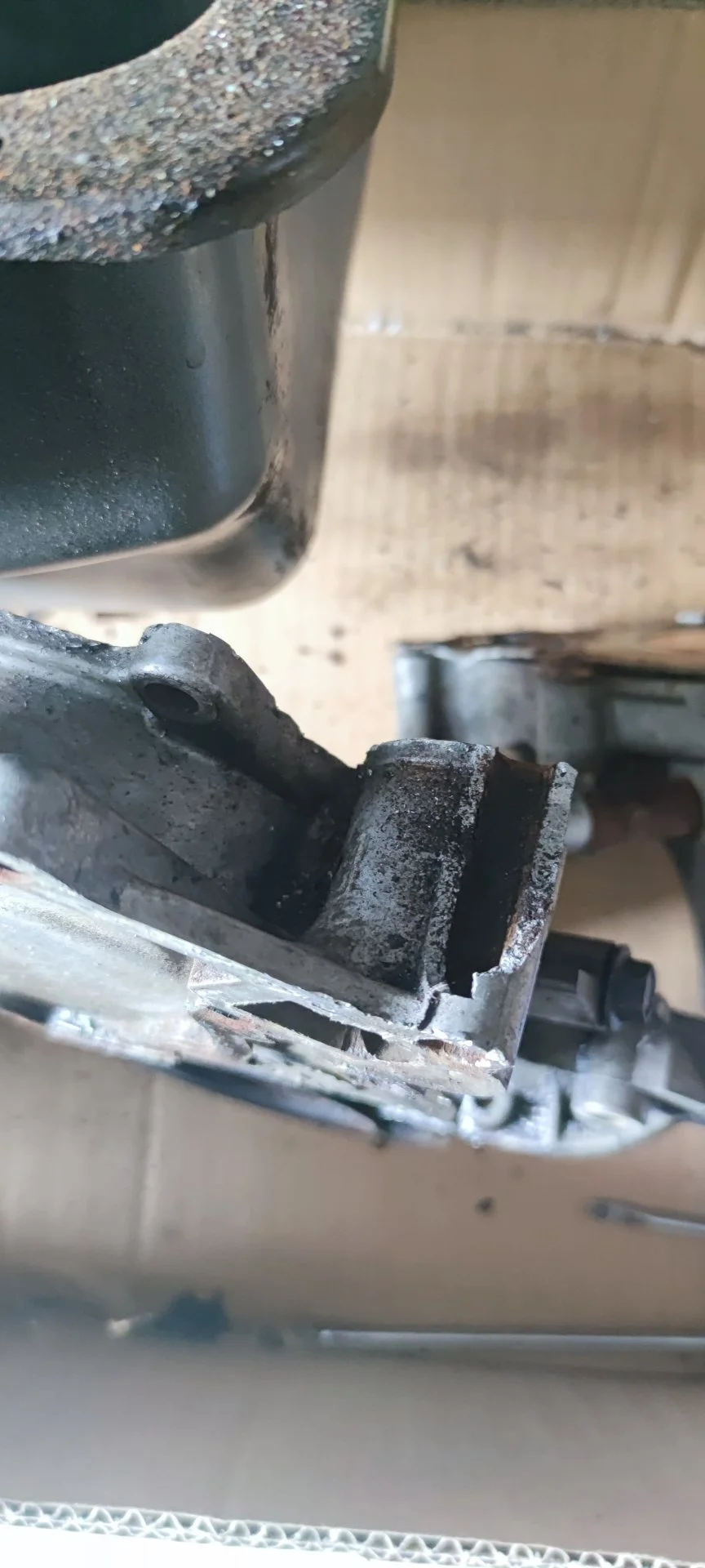

Yeah... TC off. As it started to let loose on right side, it was soon clear why - it cracked along bolt hole....
Timing cover off, casualties are water pump housing, three water pump bolts, timing cover and one termostat housing bolt.
Water pump casting says 96, made by Ford. So pump was changed when car was 8 years old. 25 years of corrosion took its toll.
