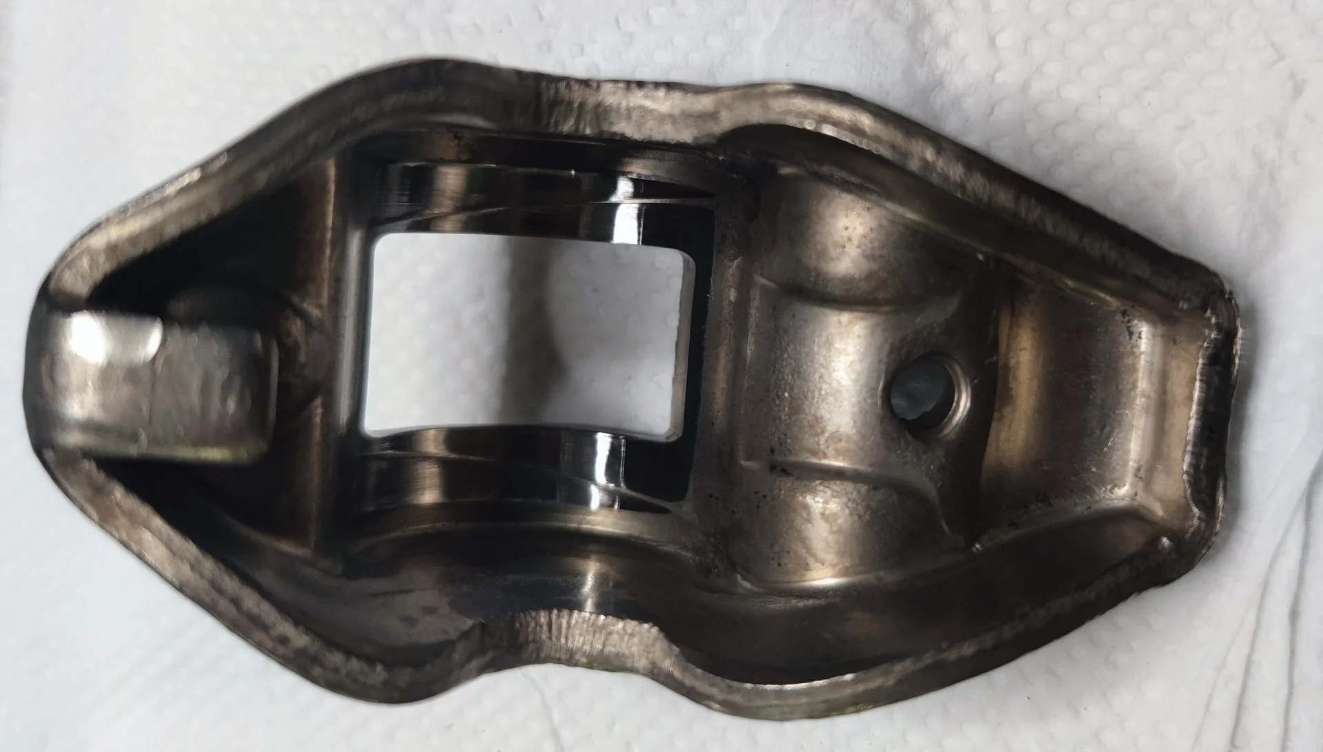

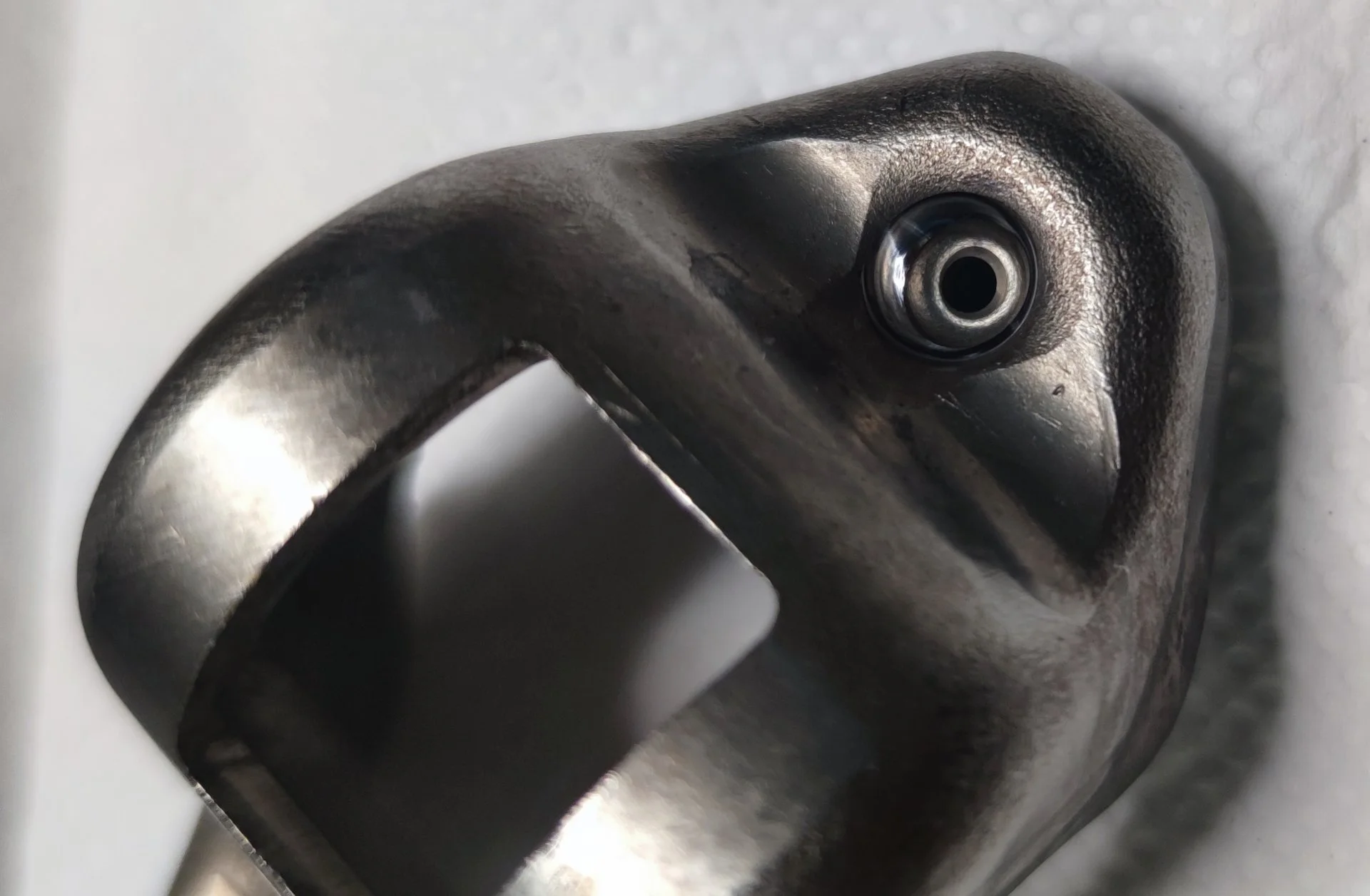

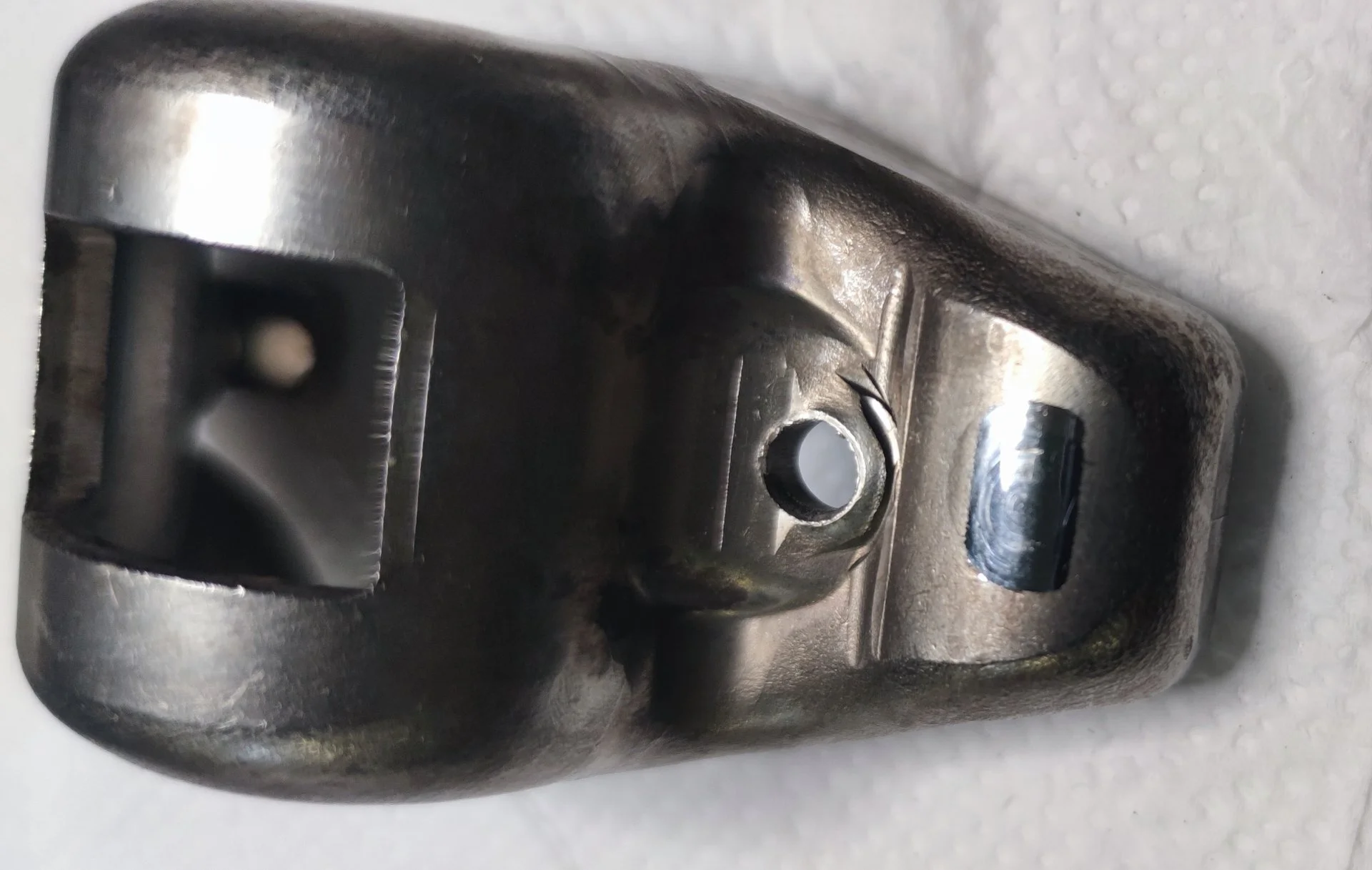

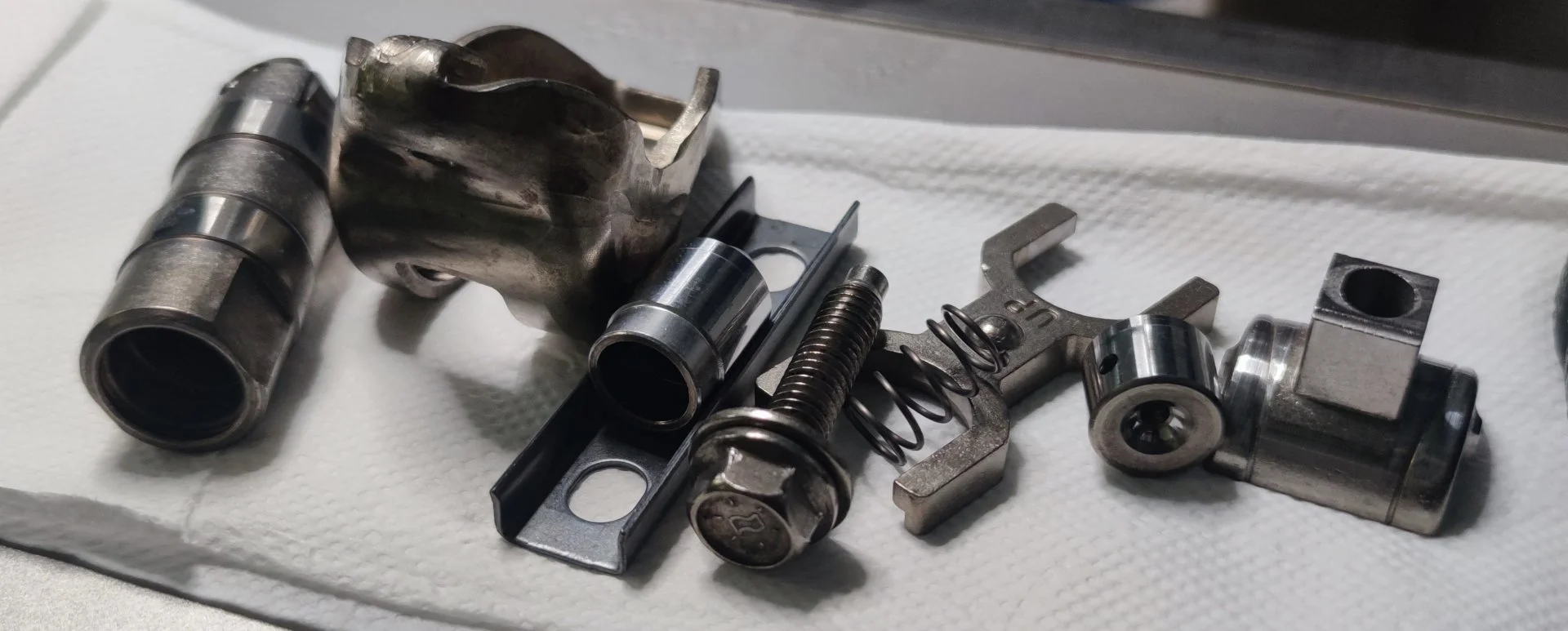

Now as I have time I took comfort to clean the valvetrain parts and lifters in a ultrasonic bath...
Rockers took some wear but I will lightly polish them, just enough to make contact surfaces smooooooth

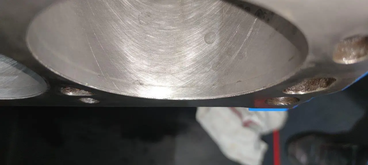

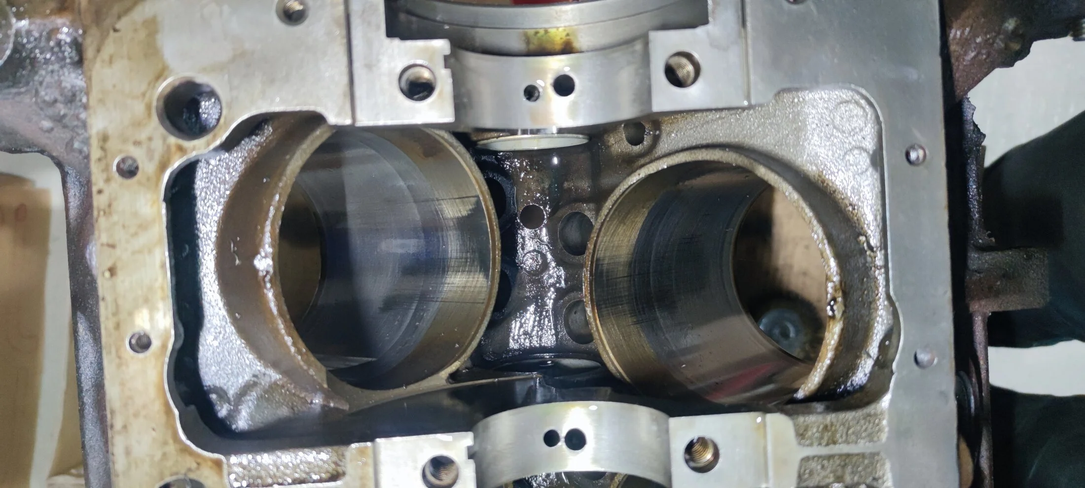

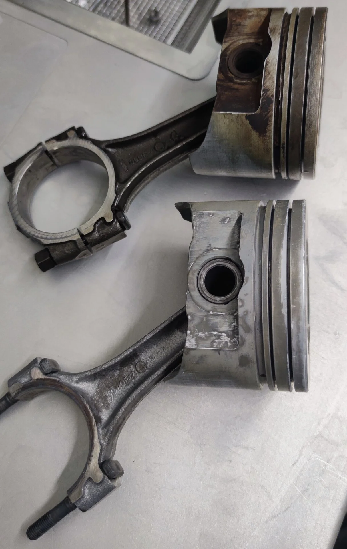

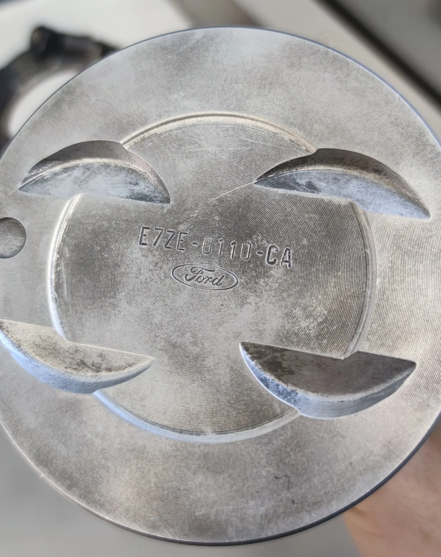

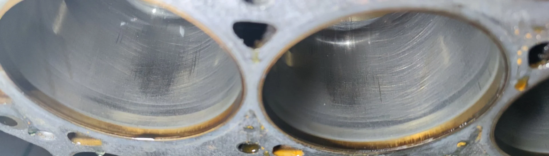

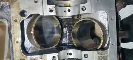

Okay, new engine apart.
I will measure skirts in next few days, only skirts show wear.
Cylinder bores have a bit wear marks from the cylinder skirts also, but honing is still clearly visible. No deep scratches, can't feel them with fingernail. But, you can feel the edge at the top of the cylinder bore with finger.
I plan to reuse the pistons, wear is there, but does not seem too much. See pictures, and tell me if it is a good idea to hone and re-ring. Thnx.

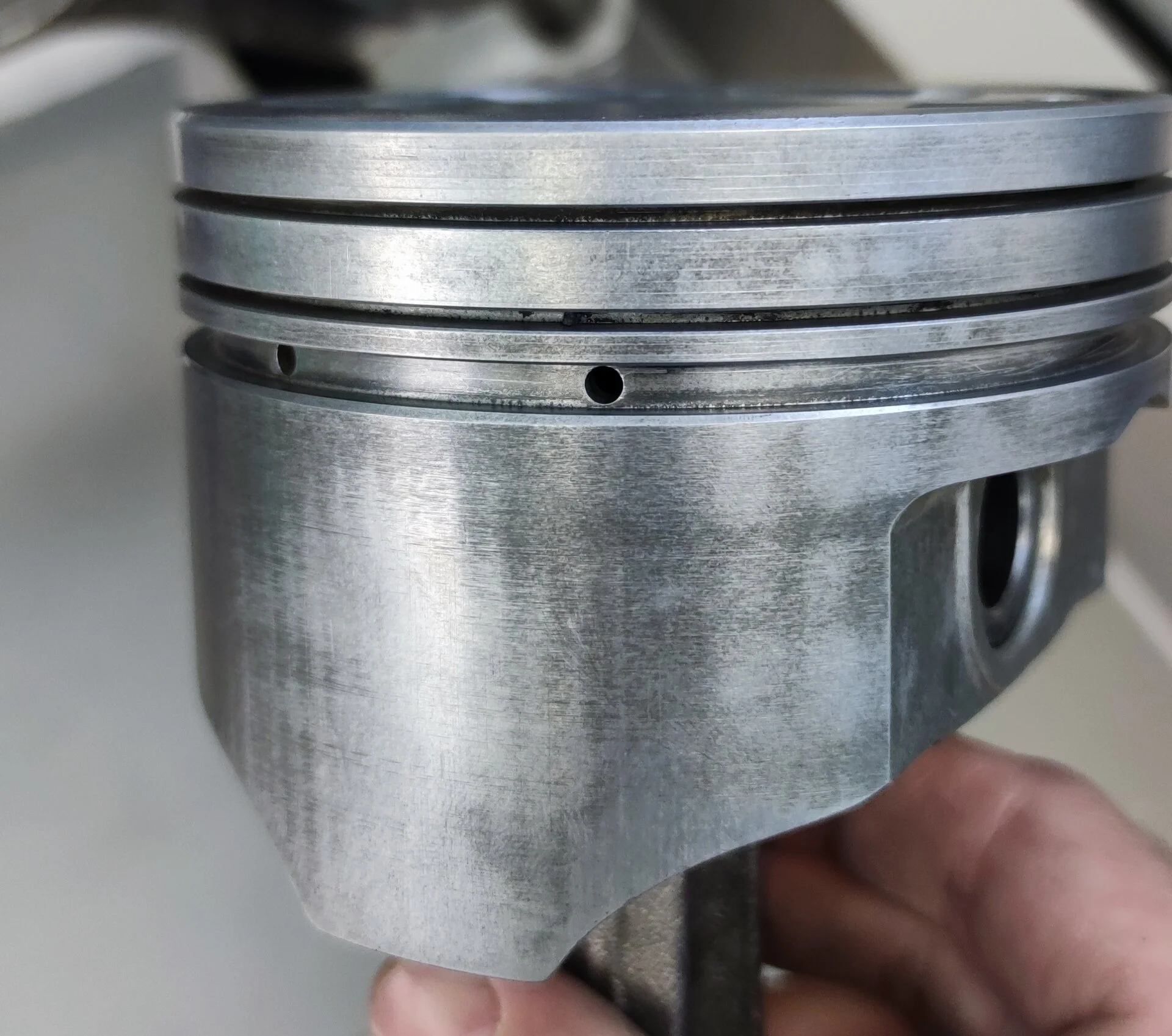

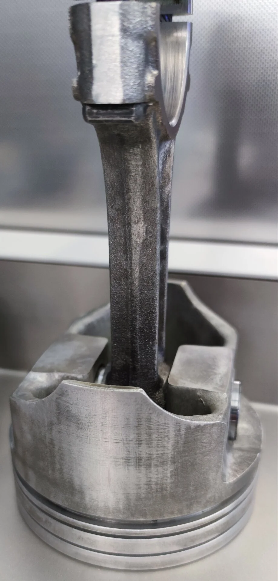

This is how ultrasound cleans the pistons and rods (scrapes are from manual wire brushing carbon deposits)....
Shall I try to slightly&gently polish the skirts? Something crossed my mind: Did anybody use that cerakote stuff on skirts?

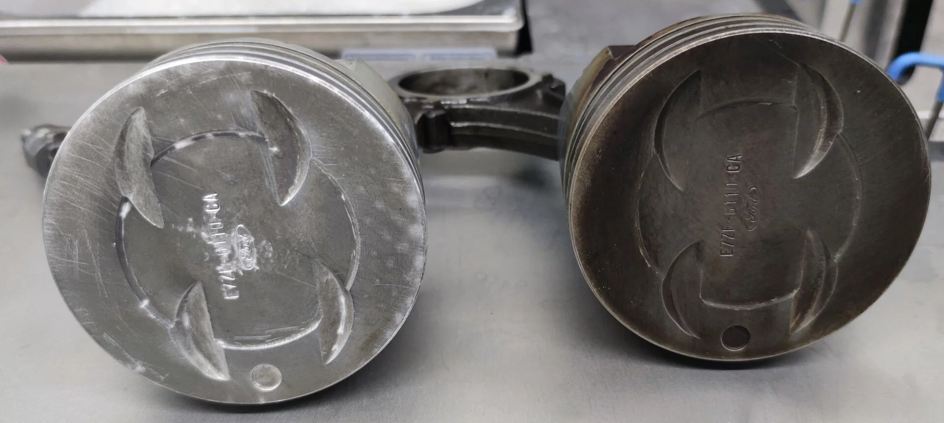

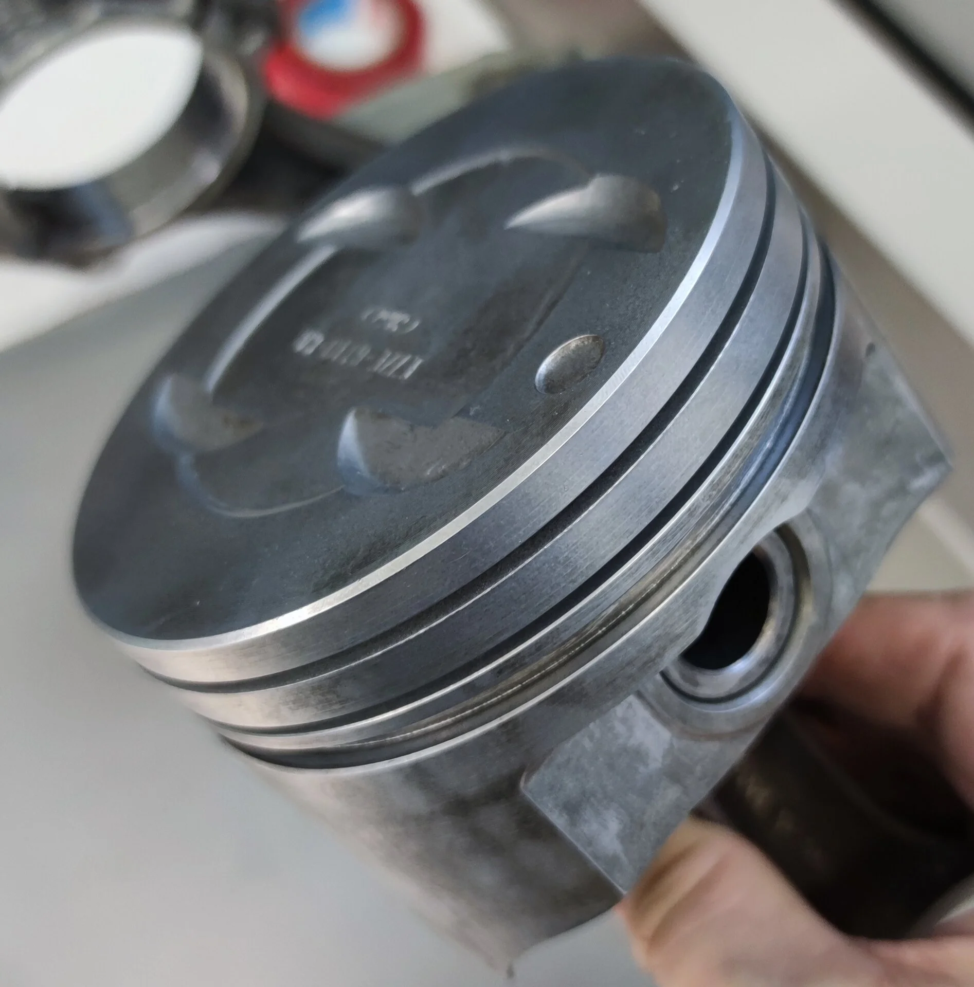

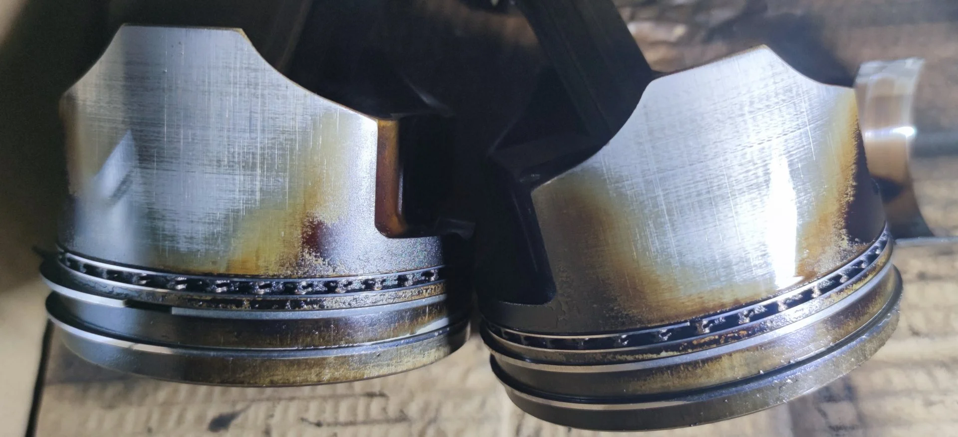

@General karthief got me wrong there, was just thinking into replacing worn 0.001" with ceracote. But You are right, looking into the price tag.... does not make sense....
Pictures of rubber polished pistons attached... proud about results!!!!
Roughly measure says middle of specification. I would say REUSABLE....
You reminded me with Your footnote:

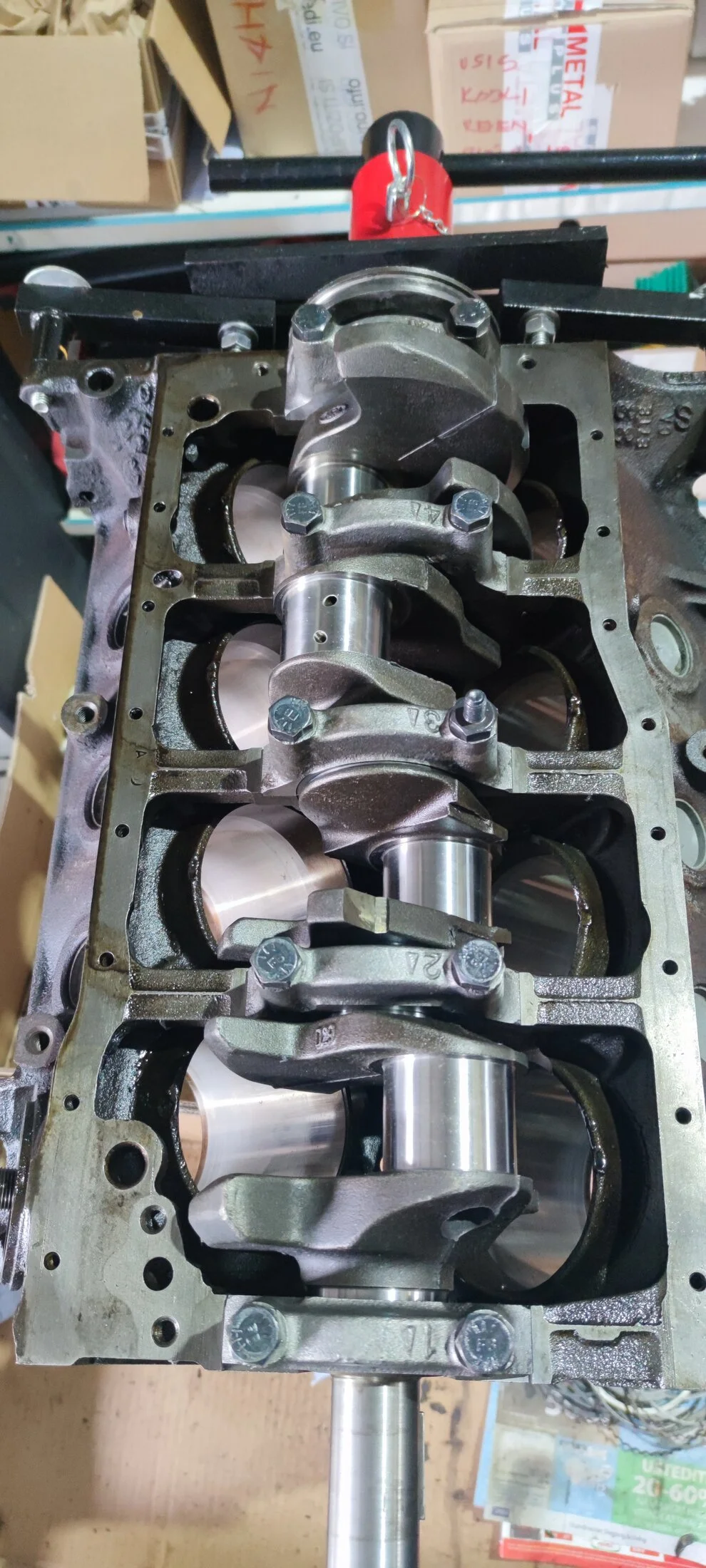

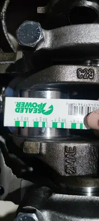

After some other projects (bought 2012 F-150 STX with Coyote 5.0), machine shop finished the crankshaft so I went back to my spare engine rebuild.

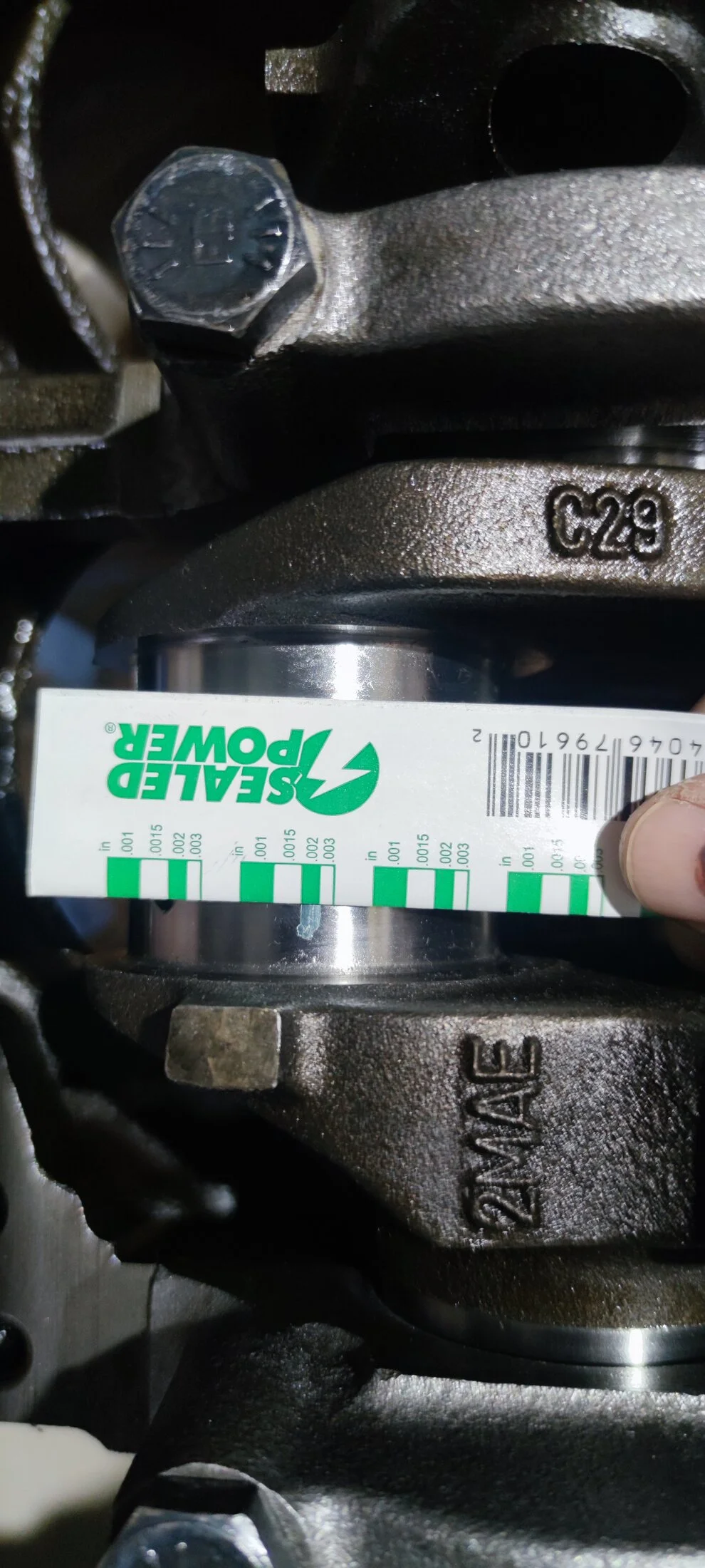

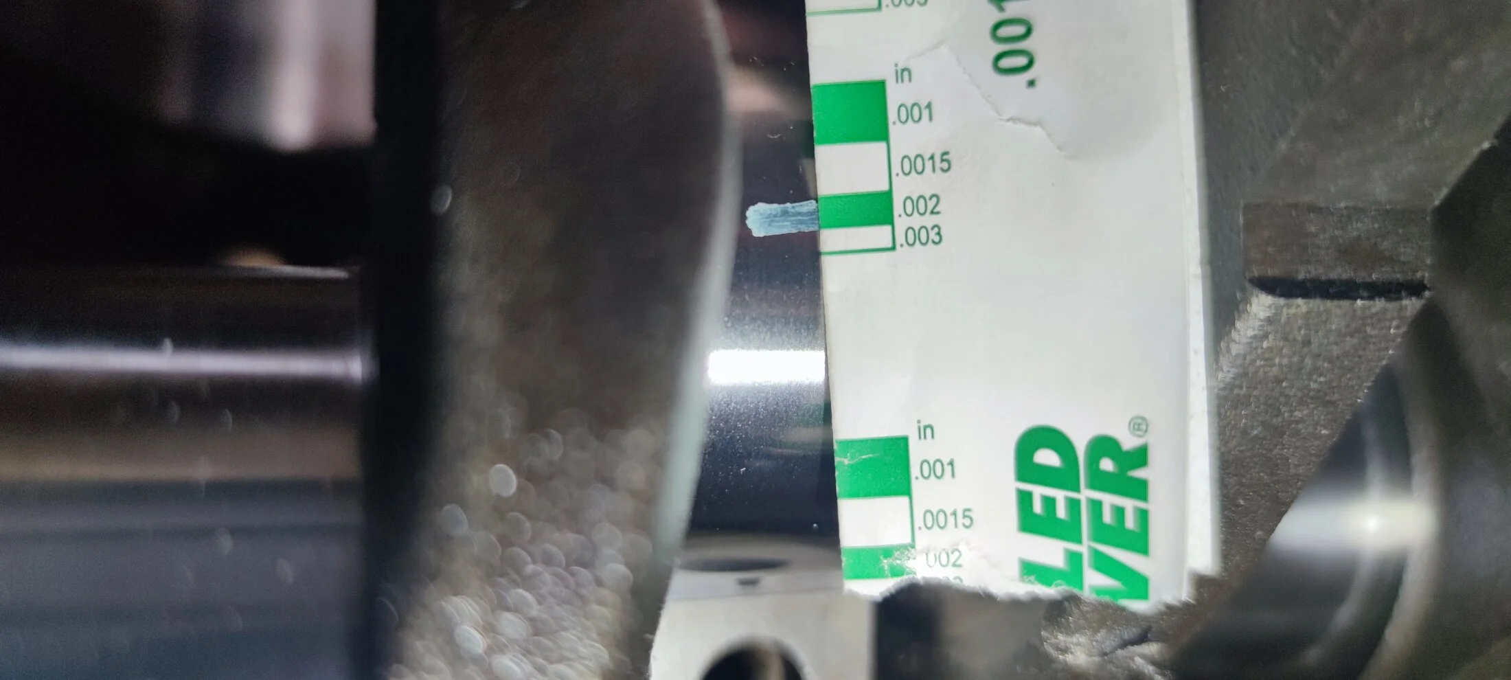

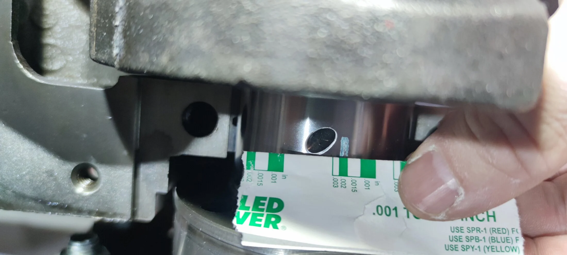

Checked the crank with some used .010 bearings...
Plastigage say:
Main oil clearance 0.002
Con rod oil clearance 0.002
Feeler gauge:
Crank play 0.0078
Border tolerance for crank play, but could be okay...

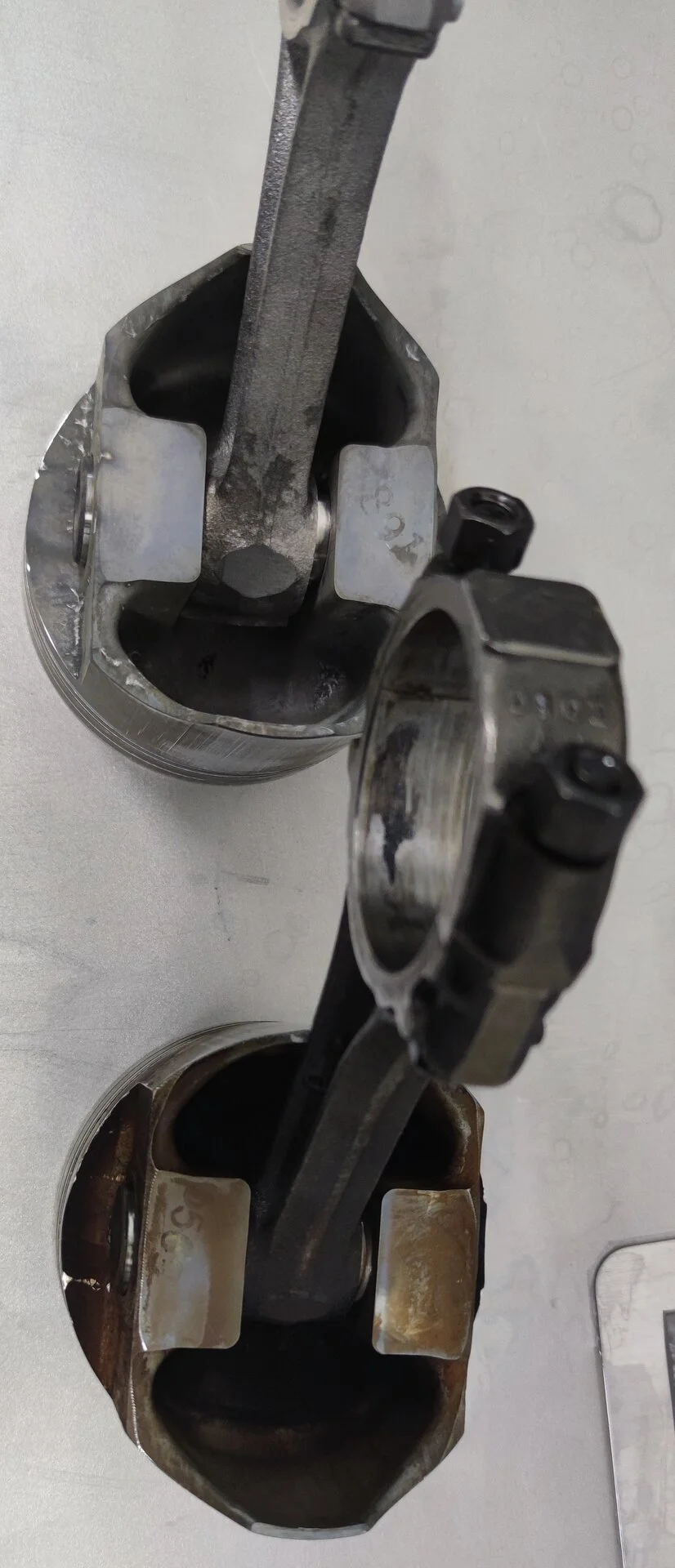

Next to check are the pistons after polishing them and backyard cylinder honing still need to be done (three stones tool)...I hope those dirty oil scoring marks will disappear with light hone...
Just from curiosity, what is the maximum allowable piston to cylinder wall clearance on TRW pistons? I mean before noticeable piston slap?
I know factory is 0.003 to 0.0035, but I ask from experience?
My pistons first measured ~3.996" which is below tolerance -0.0012", and I expect the backyard honing to take away another 0.001" (at least) from cylinder wall.... so I could have eyeballing 'bout 0.006-0.008" piston to wall....
Thnx!

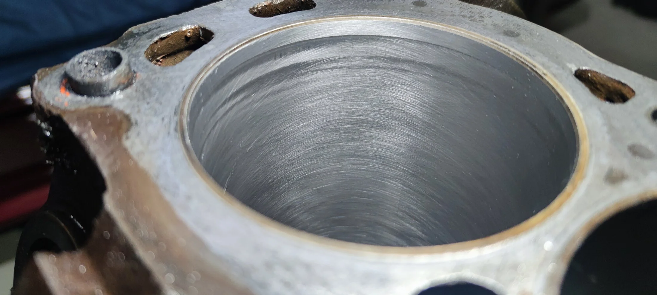

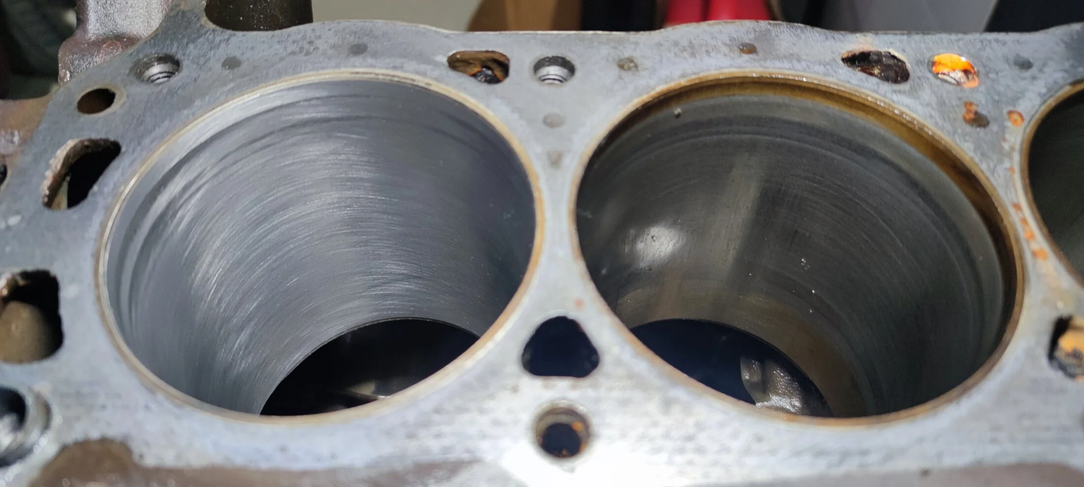

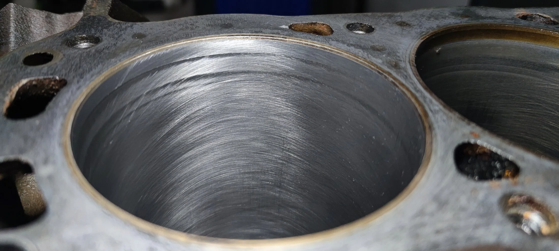

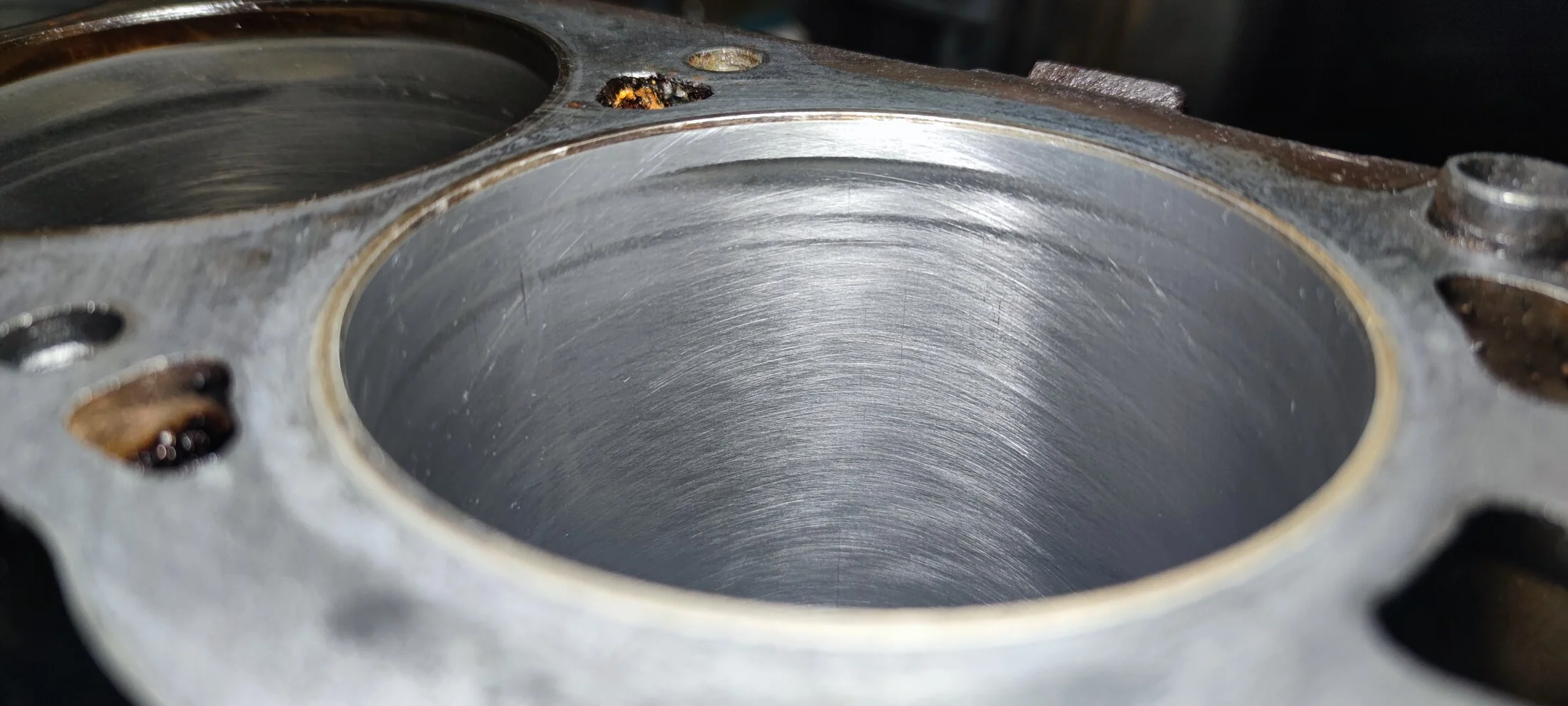

Okay. This is as deep as I would go with hone 320 grit for moly rings.
Clearance 0.0045"
What will yall say? Good to go for trw pistons and moly rings?

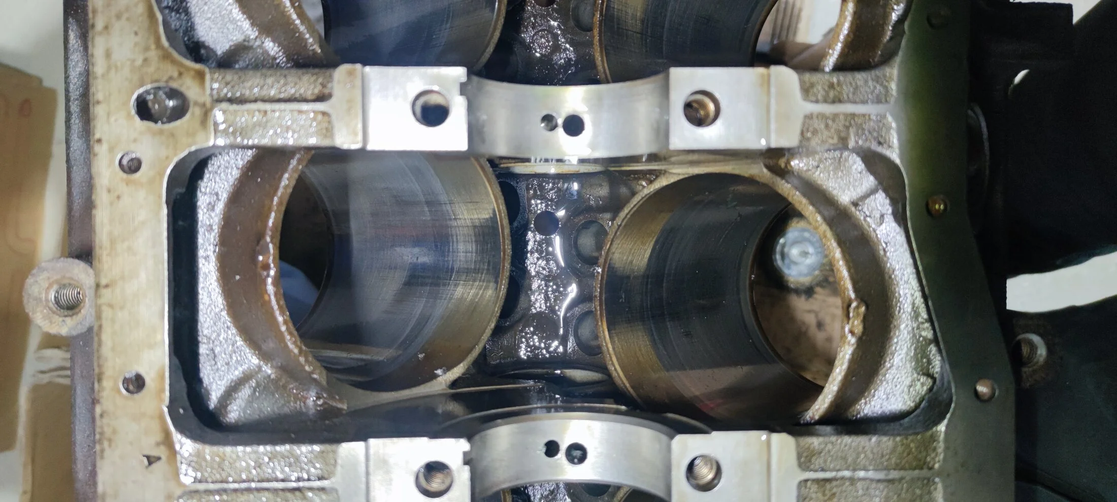

Hi yall.
Long time no report :cool:

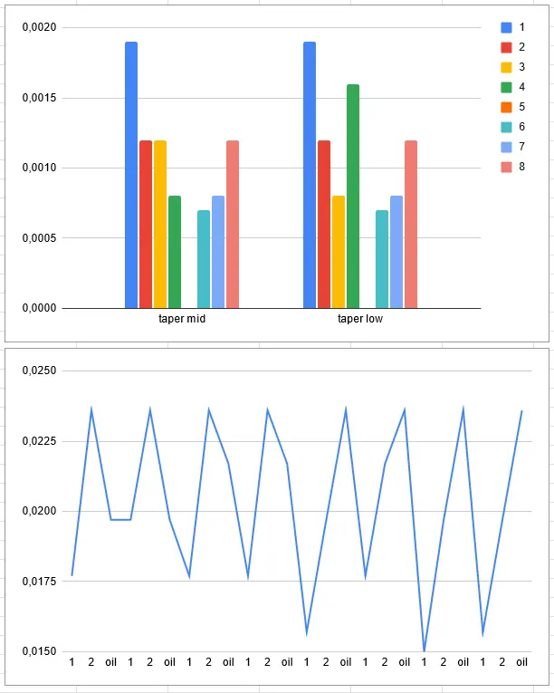

After a backyard hot tank at the end of last year I finally found a bit of inspiration to start working on engine again.
Stock piston compressio rings had .0030-ish gaps so I went with a .005 rings in order to file fit them.
Said, done... yesterday. Looking at the numbers, I have:
- 1st rings on three pistons .015-.0157, rest are .017-.019 max.
- 2nd rings on three pistons .0197, rest are .0217-.0236 max.
- oil rings all inside .0197 min to .0236 max.
Graph attached.
Question: Shall I file thoose three compression rings a bit more to be safe or I should be fine (book says .010 to .020)?
Cylinder wall taper is well under 0.002" after honing.
Damn... guess I did not oil after WD40 spray: on cylinder walls there were some "spots" of some surface rust pitting from standing a longish time. They went out with a few hone strokes, but the surface "etching" is still visible. Guess it went a bit deeper into steel, a few spots per cylinder, not worth boring I think so... check picture.
Heads look okay.

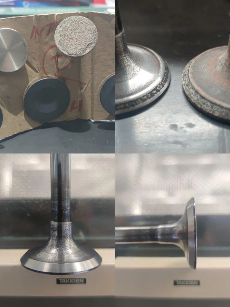

Almost all of the exhaust valves had a lot of pitting on 44° face so I took them to my workplace and we ground 44°.
A few valve stem tips have a kind of edge chipping around perimeter where valve stem is chamfered. Thoose may be from hex hitting stem during disassembly, but what this may show? On the other hand, wear marks are nearly perfect on valve stem tips. I must picture this...
Valve lapping follows :)
Thnx a lot for comments and suggestions!

You need the correct margin on the valves or they will burn
That margin is what you see below the pitting (needs to be roughly .80- .120")
Be careful grinding the valves and seats
Easy to get the valve sucked into the head too far and make the lifter plunger be in the wrong spot, you get a lifter tick that will not go away
I also thing you are asking for trouble with your piston to bore clearance
Same with the ring ridges, those need to be removed before punching the pistons out to not crack the ring lands
Your ring ridge was light, so the piston ring lands are most likely okay
3rd time around this thing needs to be fixed for the knock
Good luck
Maybe run the engine on a test stand before stabbing it into your Mustang
Ehen you say "good to go with TRW pistons"? What? You got new pistons?
Ring end gap spec is .020 for the top ring and add .008 for the second ring
So ,020 and ,028 is the minimum.
If you have ever cracked a set of rings due to lack of end gap...
That tears pistons and bores up real bad (ask me how I know)
Thnx.
Then I will file cylinder 5,7,8 rings a bit more to get the end gap in range of .017 as the rest. Second rings are .022
Your numbers are a bit on safe side, but You just said why... :-(
I read a lot about it and found consensus: for NA in general there is a .004 per inch, for 302 some guidelines are .016-.018 and +.004 for second rings. Of course for spray or blower You need to open up further (sometimes double).
Good luck
Yeah, we just licked the 44° face until the pitting went out. Margin was therefore not changed too much and was within spec. Allhtru, I still need to check the stem to guide clearance.

The piston type and ring manufacturer have more to do with the ring end gap than the Ford spec does these days on a rebuild
The rule of thumb for Hastings for instance is 3.5 thousandths per inch of bore (means .014 is okay for a 4 inch bore)
We saw a bunch of 302's that knocked slightly under base warranty when new
All or most had specs within tolerance on everything we could check including piston to wall clearance
Problem was eventually narrowed down to piston slap on #1 on a few of them
No need for a stand then
Run it. My Boss 302 (forged) pistons are set up a little loose to go racing

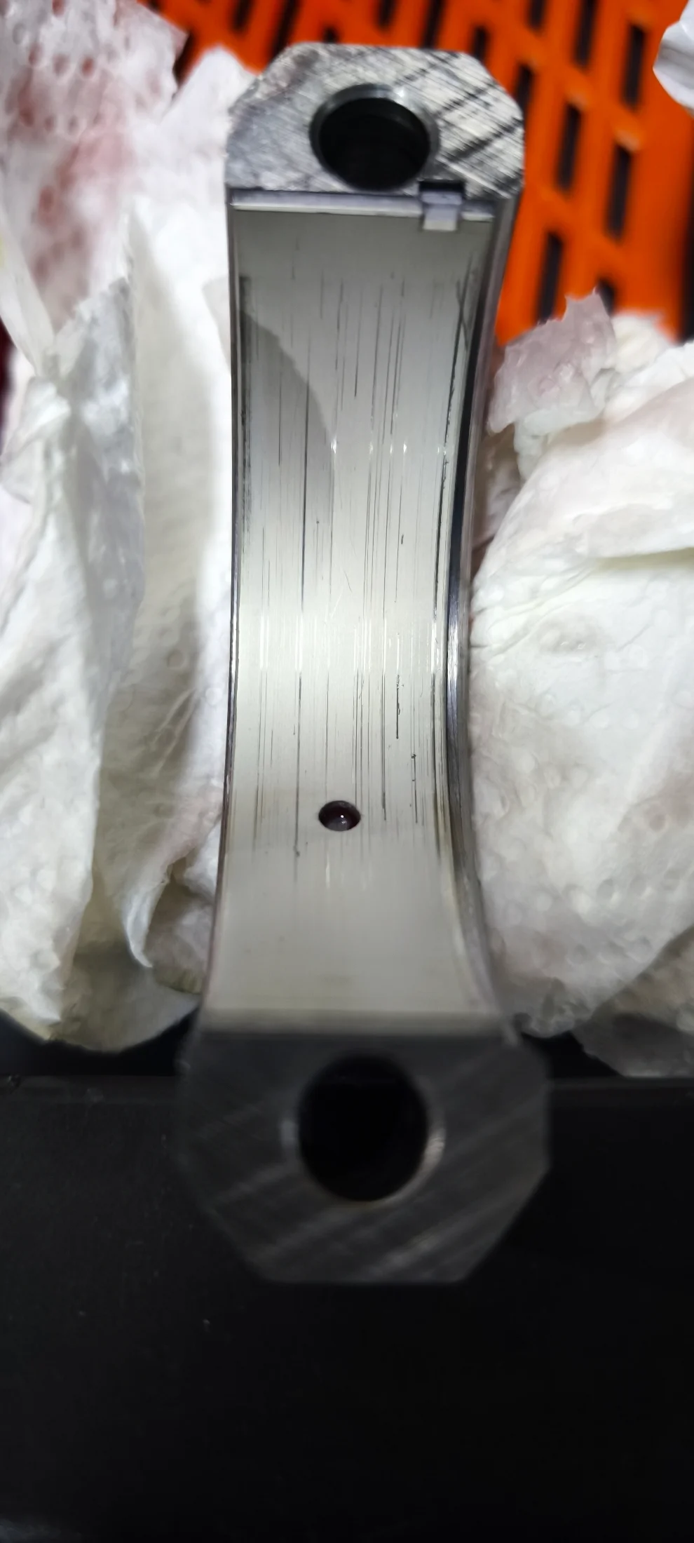

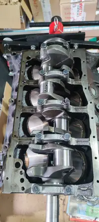

I just installed the crankshaft and pistons into the block, which had been waiting for assembly for at least a yea

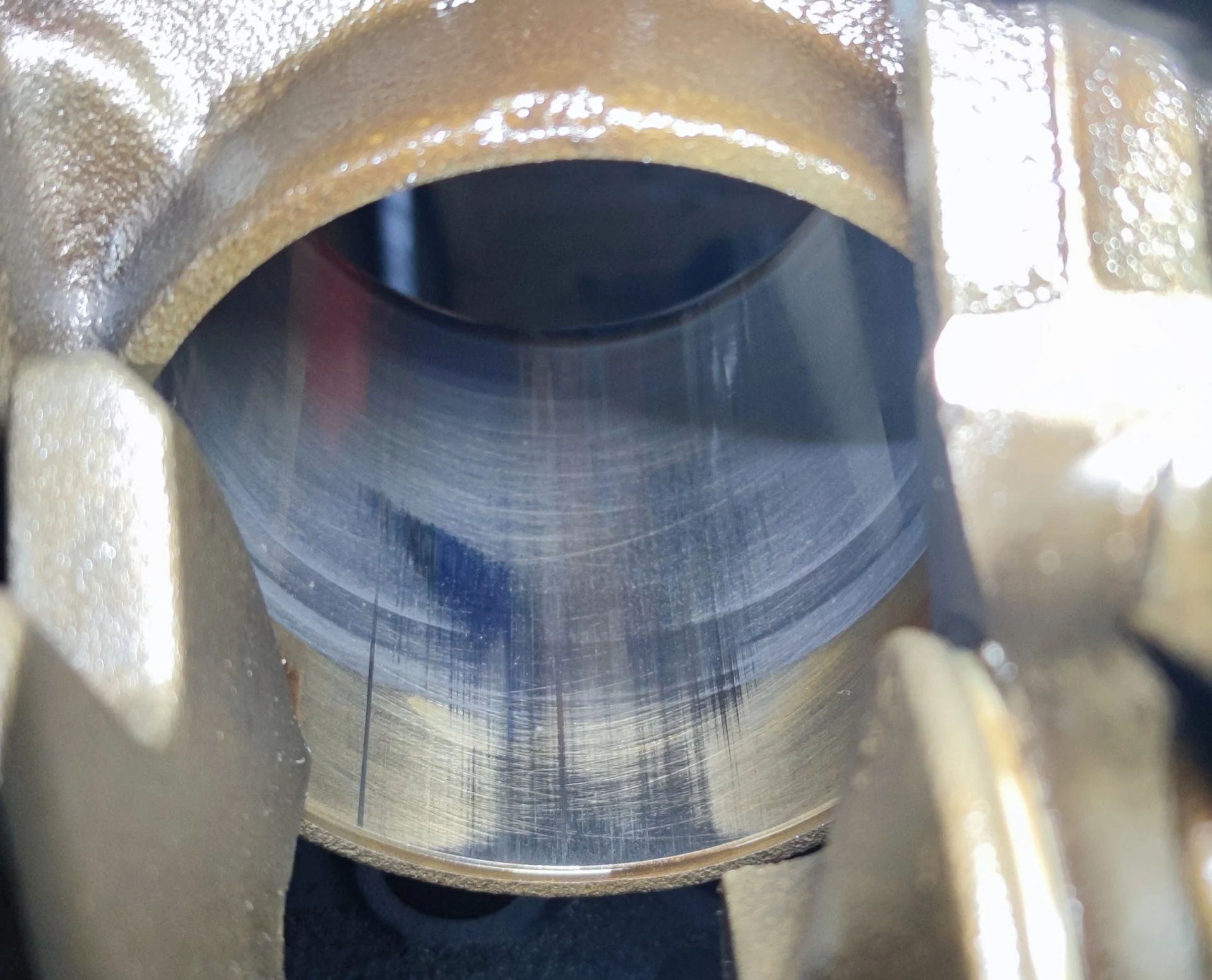

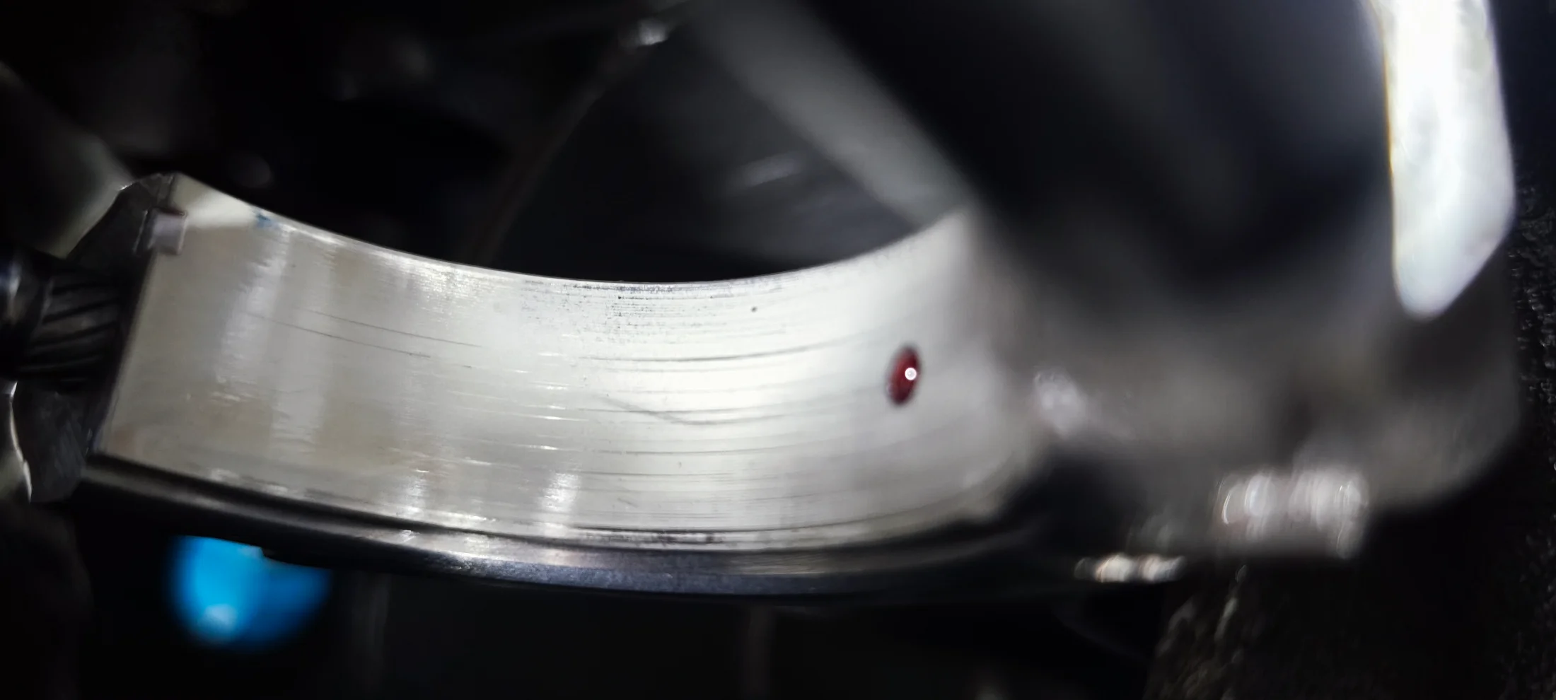

I used Plastigage to check clearances — the crank is ground -.010, giving about 0.015–0.020" on the mains and 0.016–0.018" on the rods.
While removing the Plastigage, I noticed a shiny upper connecting rod bearing — I assumed it had just seated itself.
Attached are some pictures of the rod bearings after about 30–50 turns of the crank (during piston installation, oiling between turns, and wiping excess oil from the cylinder walls). Assembly lube was used, of course.
Upper is much worse. You can’t feel any marks with a fingernail, but it looks like contamination — even though everything was clean (pistons, rods, caps, and bolts were all cleaned in an ultrasonic bath).
I also re-checked the crank’s oil passages with a brush before installation.
This is driving me crazy.
Not sure what to do now — just put it together, or tear it all down and clean everything again?
Thnx...
