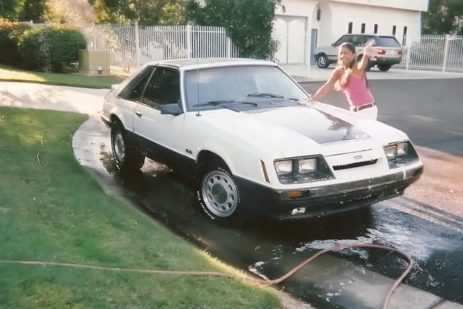

just to let you all know. after the shop totally f%$#ed my car up i ended up replacing all of the wiring with all new wiring from ford at the dealership and spent about $6000 to have the dealer un f*** the whole mess and get it back to stock, i made some of my money back when i sold the engine and tranny from the cobra but not nearly as much as i have spent. but, at least my car is drivable again and in pretty good shape considering what it's been through, check her out. by the way, i now have into the ol girl about what it costs to buy a brand new base GT and the car is basically stock, nothing major done to it.
anyways, if you are going to do this swap beware, YOU need to be an expert mechanic that has done a lot of research or you need to be having a trusted expert mechanic doing this. good luck to anyone else that tries this. i for one will be rolling my fox the way ford intended 5.0 all the way.
