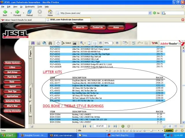

Just looked at Summit's webpage Crower and Erson Make roller lifters too. As does Lunati. If you are looking to spend less than 150 don't bother looking any farther than FRPP. Everyone else is $200 and up for 16 lifters. FRPP is only $120. And if you got 130K out of the originals, you'll likely get just as much from the FRPP units.
That's what I was thinking too... It would be hard for me to spring for the Competition cams lifters for a street motor. Especially since I probably won't see 100 dollar performance difference on an already tired short block. Thanks a million. FMS it is!
