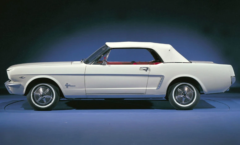

This is stock height. You sure you wanna go higher that this?
