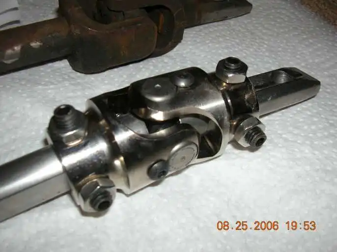

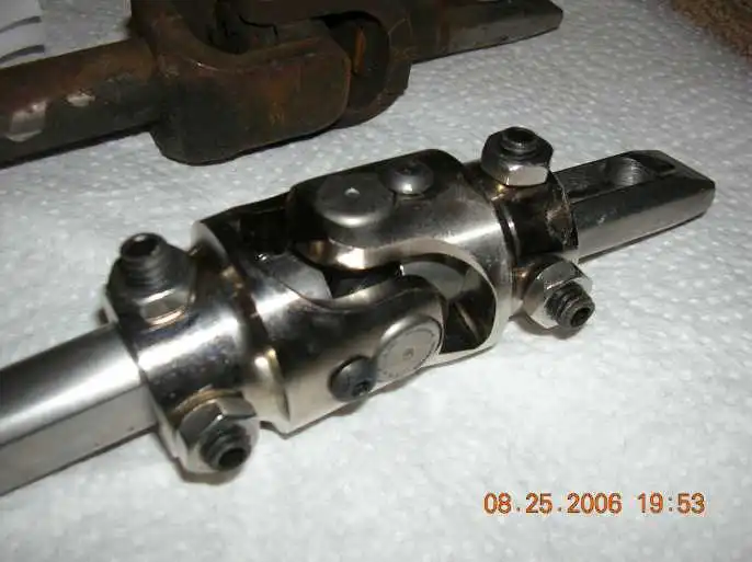

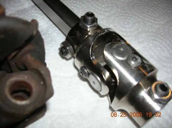

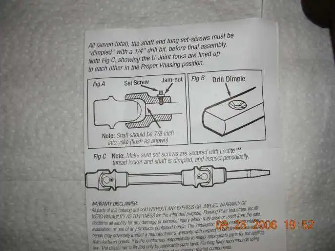

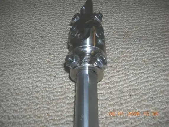

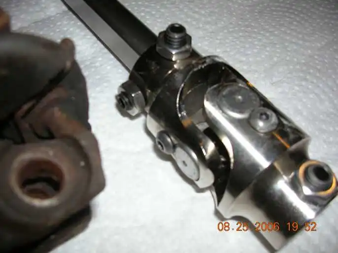

If you showed just the two following images to any Mechanical Engineering student and they couldn't immediately see many problems with the design, then I think that any University would be fully justified flunking them out of school! And, I say that as a former engineering teacher! :) Uhm, ignore the length of the bar stock. It's the depth of the screws and the flat locking nuts "locking against" the round body. Plus, the moronic very shallow depth that flaming river suggests for a counter sink. For one thing, WHY so shallow? Geez, do they know anything at that company?
Close up of the Flaming River rod and joint assembled:
Another close up of the Flaming River rod and joint assembled:
Flaming River shaft instructions:

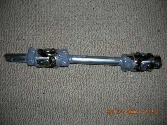

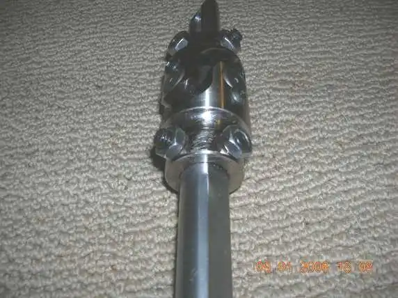

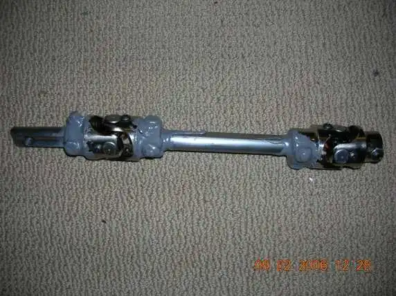

My solution to the POS Flaming River design. Compare the counter sink amount to the pictures above. Also, the JB Weld I used was has a very high temp rating (the shaft is next to the headers).
Here is how much I did the counter-sink for the screws. You can see the difference in height in the set-screws fro the side and the flat.
The JB-Weld job isn't pretty, but MY steering assembly is never coming apart!

I just welded mine I felt skiddish about the set screws also
My guess is that you're also very good at welding (going by reading your posts). All of the Mechanical Engineers (all had over 15 years experience in aero-space) that I talked to didn't "feel comfortable" welding because of the risk of damage to the seals at the bearings in the u-joints. But, most of them felt that "it might be possible" (to weld and not damage the seals). We've all seen the work that top welders can do. However, none of us are in that class.
I was going to use "blue death" (commonly used in aerospace and military applications). But, "by the specs", JB Weld seemed better with regards to heat. Also, we have been able to (mega) heat parts (for a long time) that have been "blue death-ed" together and get them apart. But, that was after high heat for many many hours. "Blue Death" has been used for ?20+? years and is approved by NASA and DoD for many applications. And, I know that people have used JB Weld on heads and so on, and it's seems to hold up.
