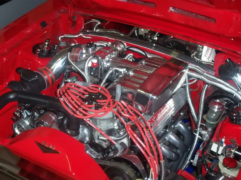

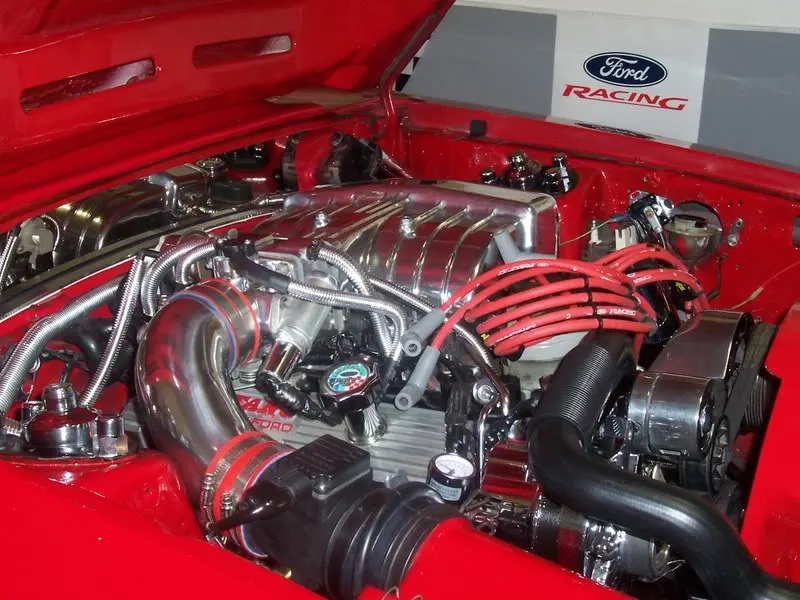

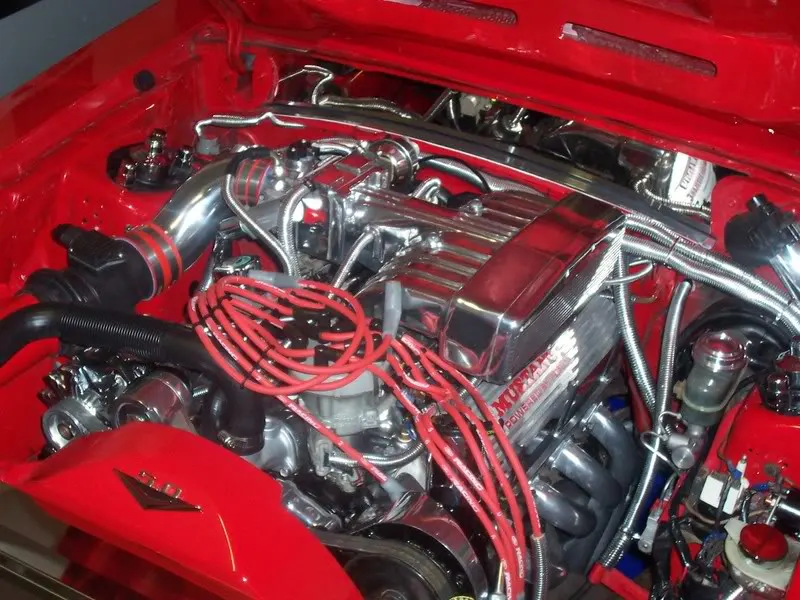

polish done...tired...several hours later.
