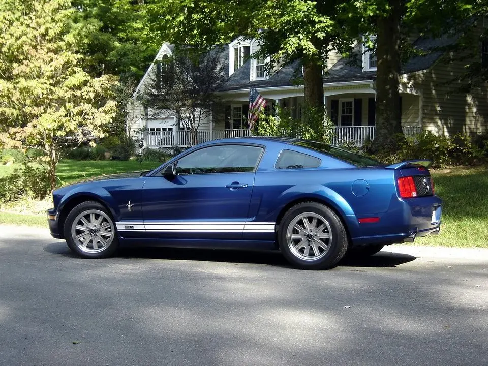

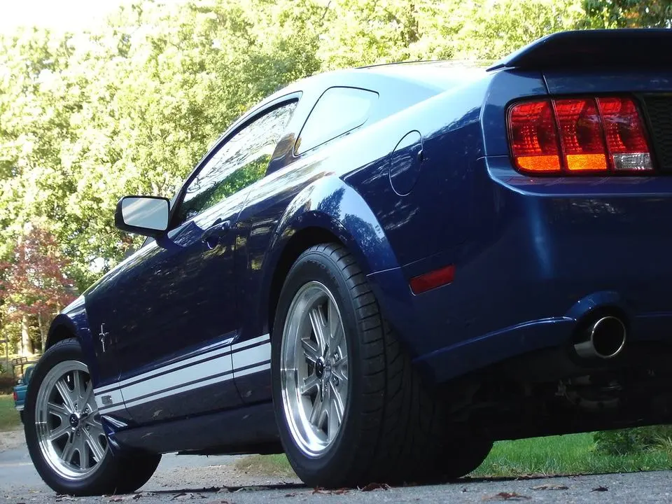

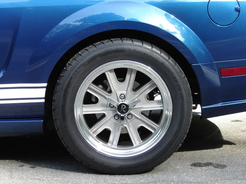

I agree that the car looks more aggressive with the taller rear tire on staggered wheels be it the Bullitts or many other deep dish wheels. I know mine aren't Bullitts, but you can get an idea of the taller/wider rear tire and the stance it gives(mine is 100% stock suspension). I run 18x8.5 with 255/45 and 18x10 with 295/45 no rubbing issues at all.

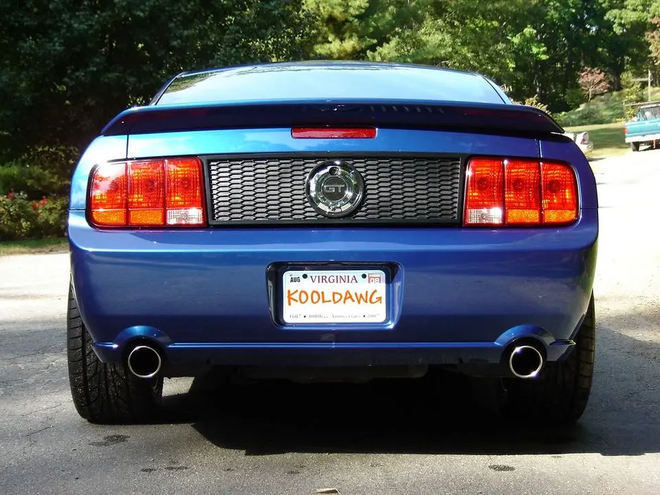

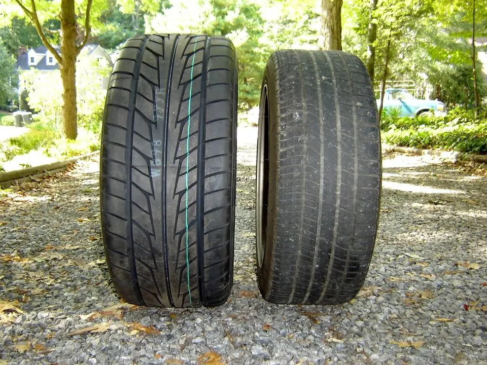

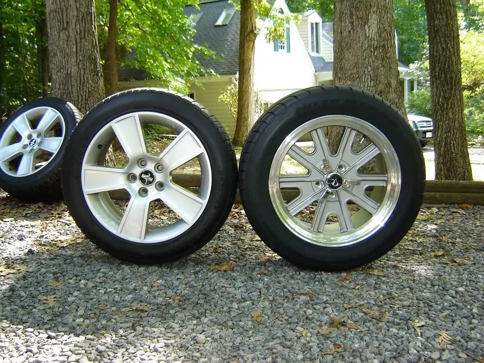

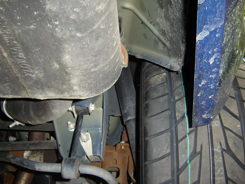

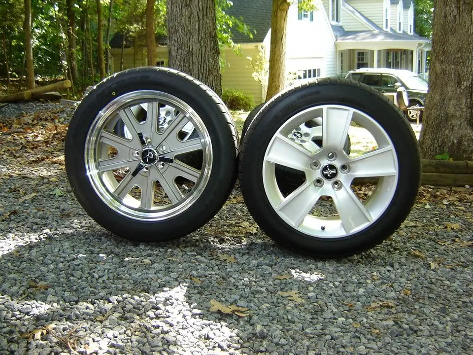

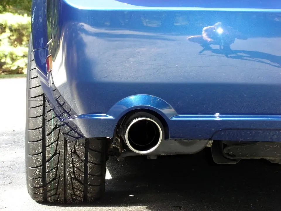

Pics you want...pics you get:D

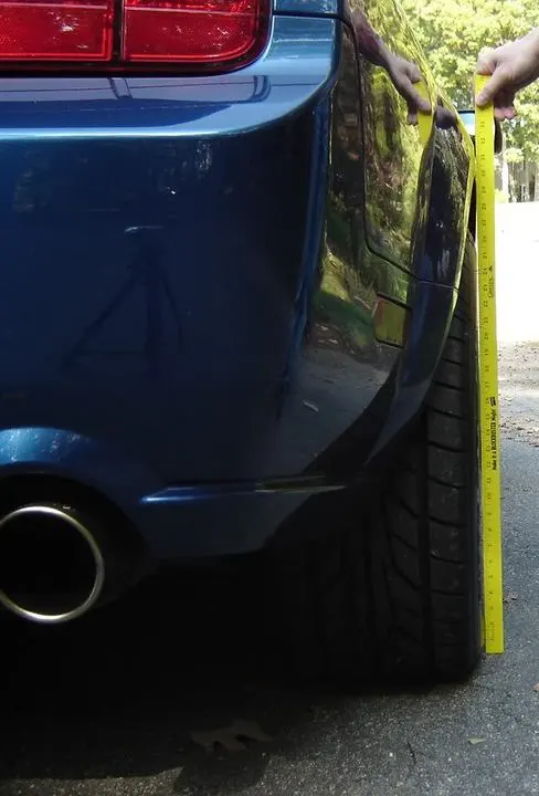

My rear wheels are +45mm offset. It puts the tire right to the very edge of the fender lip:nice:

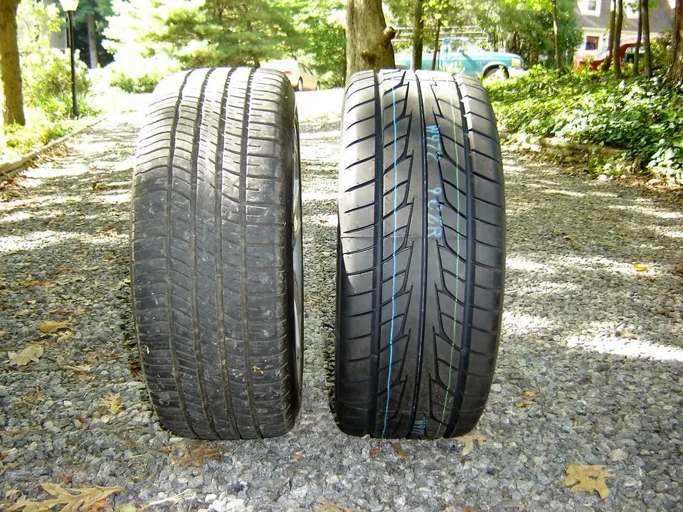

The Nitto 555s next to the OEM KDWS(235/50-18)
Front:

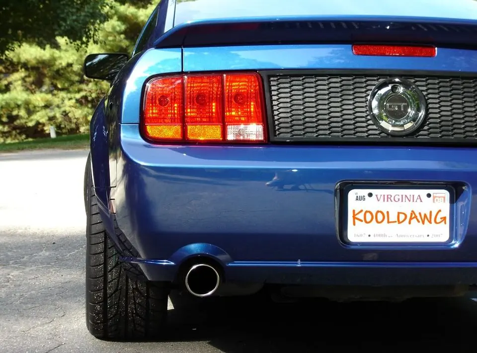

Rear:

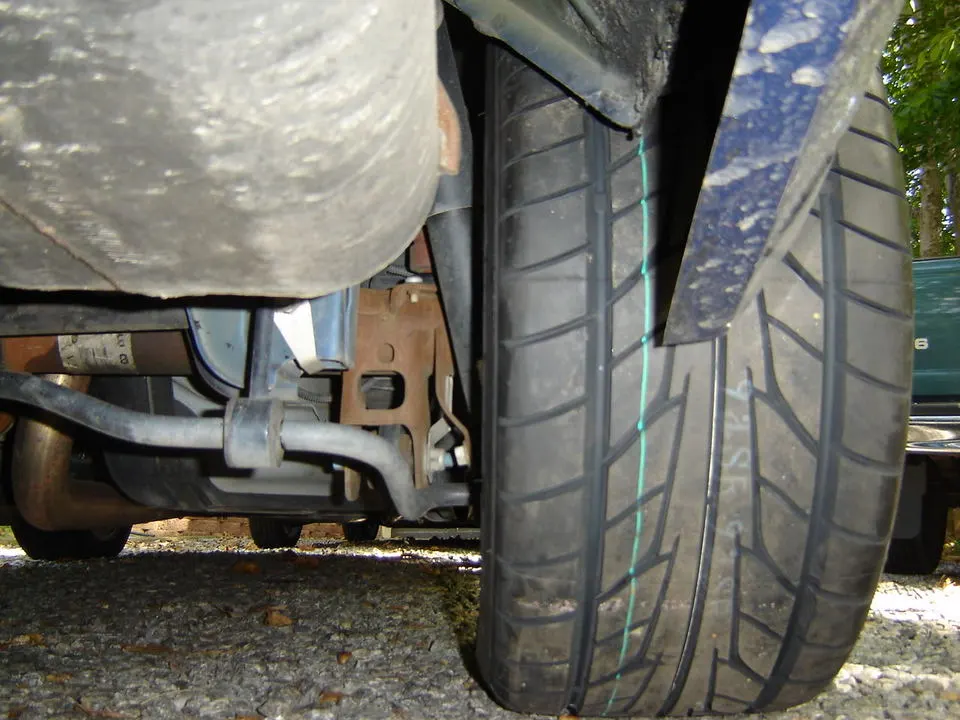

Right after I installed the wheels/tires and before I washed the car, but shows underside view and tire clearance.

I don't really know how it has affected my acceleration:shrug: I never took it to the track with this setup. Since drag racing season is over, I also toned down my tune as well. I dropped the shift RPM from 6500 RPM back down to 6200 RPM and also changed the shifting pressure from +20% back down to +5%. Both of those changes alone changed the way it runs. I got this tire/wheel combo mainly for the look. I do enjoy the added handling, but I will have dedicated 17" with ET Streets on the back for drag days next season. it won't be long now before I get dedicated winter tires for my Fanblades for the snow.
