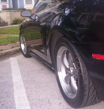

On the Cobra 03/04 from the factory 274/40-17 all the way around. It will fit fine. I have a Steeda Front swaybar that is a lot larger than factory plus lowered a little.....so my inner tire can rub the sway bar at full turn but it is not bad and I can still turn pretty much as before....just touches at full lock.
http://i32.photobucket.com/albums/d12/cvgtpony03/100_0372.jpg
http://i32.photobucket.com/albums/d12/cvgtpony03/100_0367.jpg
http://i32.photobucket.com/albums/d12/cvgtpony03/100_0371.jpg
I wish I could get my damn pics to actually show up on here like every one else. Crap.
How the hell did you do that???
Man I have spent hours trying to get the site to accept my files. Always says they are too big. I have to just paste the link to them. I hate you. :D :hail2:
They are the Steeda sport springs in the back with the height adjustable aluminun control arms (set at about the normal height. I have not played with them too much yet) So about an inch or so of drop. Like a dumbass I forgot to do a before and after measurement. Upfront are UPR coilovers. Same dumbass mistake up there too. Tokico Illumina 5 ways all around.
