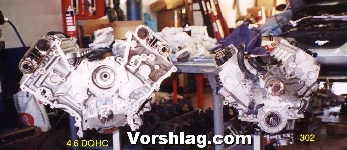

This is the problem:
The dohc motor is so dang wide that it just doesnt fit well in the engine bay. With a MII it will fit no problem. By notching the towers, you will NEVER get the valve covers off without pulling the motor. Headers will be a *(*#$$ too.
Its all about preferences... if you want to do something different, do an 03 cobra motor. Its going to cost a lot more than you think and its going to take 3 times longer than you think.
<----put a sohc with MII in a 66
