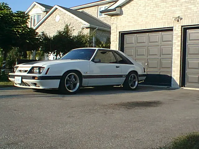

anyone have 91-93 fenders on there 89-90?? post pics...does it look better?
86 :shrug:

Most of the time when I see guys with a 17x9 wheel up front the wheel is flush with the fender lip. To make it fit they use a 245 tire - yuck. Some think it looks OK, I think the tire looks too stretched on the rim for my taste. I have 17x8 bullitts up front with a 245/45/17 and the factory whell has a smidge over a 5.5" backspace and it fits and looks perfect. 8" width wheel up front is really the widest you want to go to give the proper amount of clearance. If you want to massage the fenders and alter your front suspension and try and make it work then maybe that's another story. a 17x9 or 18x9 will fit out back no problem but really take the time to get your backspace right. Make sure the exhaust pipe doesnt rub. 6" backspace for the rear is pretty good to fit a 17x9 with a 275/40/17 without any problem Flipping the quad shock will get you about another 3/16" of clearance or so but a nice set of control arms mounted up and you can throw the quads in the trash.
