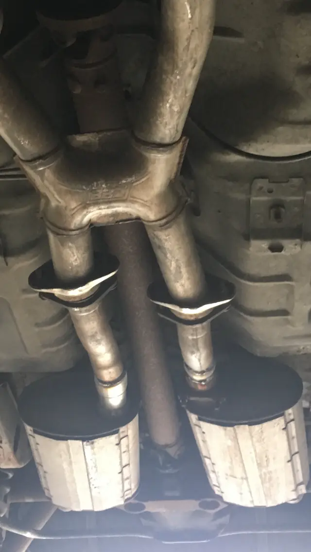

91 vert GT - no engine mods - 2 front factory cats ( rear cats removed ) x pipe , OEM headers , car has 2 regular type looking mufflers ( I cant see any brand markings ) car sounds good like it is , but I want a bit louder . I have used flows 40s decades ago and remember they sounded good with 4 OEM cats and the H pipe ( but they did seem to pop a lot down shifting ) . I heard some spins 9000 on long tubes no cats and they sounded good . Can I just change one muffler to a flow or spin without causing the heads to have a lopsided amount of exhaust flow? My thoughts would be the X part of system would balance the pressures -

The cats are probably the most restrictive part. Although its really odd to have mis-matched mufflers, I don't think it would cause any functional problems with the engine. At least not with a stock engine that is exhausting through restrictive cats.

It would have to be an extreme difference in flow before you would notice. It also would likely differ in temperature, the more restrictive one would be hotter.

I don't see how it would affect the engine negatively in a huge way, but I think it will sound weird if one muffler is less restrictive (meaning louder) than the other. My suggestion is to replace them as a matched pair, I think you'll be happier with the result. And, as Noobz says, "The point [should] be to not end up with a cobbled together piece of gokart at the end of it all."

I can see how 2 different pulse waves could be problematic ( I am a stereo guy and understand sub building ) I saw some spin tech 6000s that look good and sound good with no drone or popping - if I do anything I will do both mufflers
