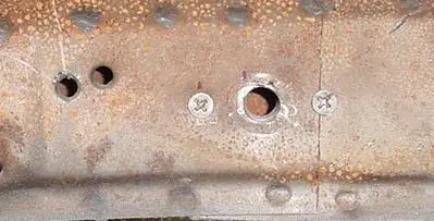

when I did my shoulder belt conversion:
'cept instead of welding, I drilled & tapped two 10-32 holes on each side of the 7/16-20 hole in a chunck of steel and used stainless steel screws to hold it in place. It still serves the purpose of giving the roof support area some "meat" to hold the main anchor bolt.
As far as "decapitation", I think if such a thing would or could happen, you would've heard about it. And there would be "DO NOT RETROFIT SHOULDER BELTS IN OLD CARS!!!" warnings all over the place.:nonono:
