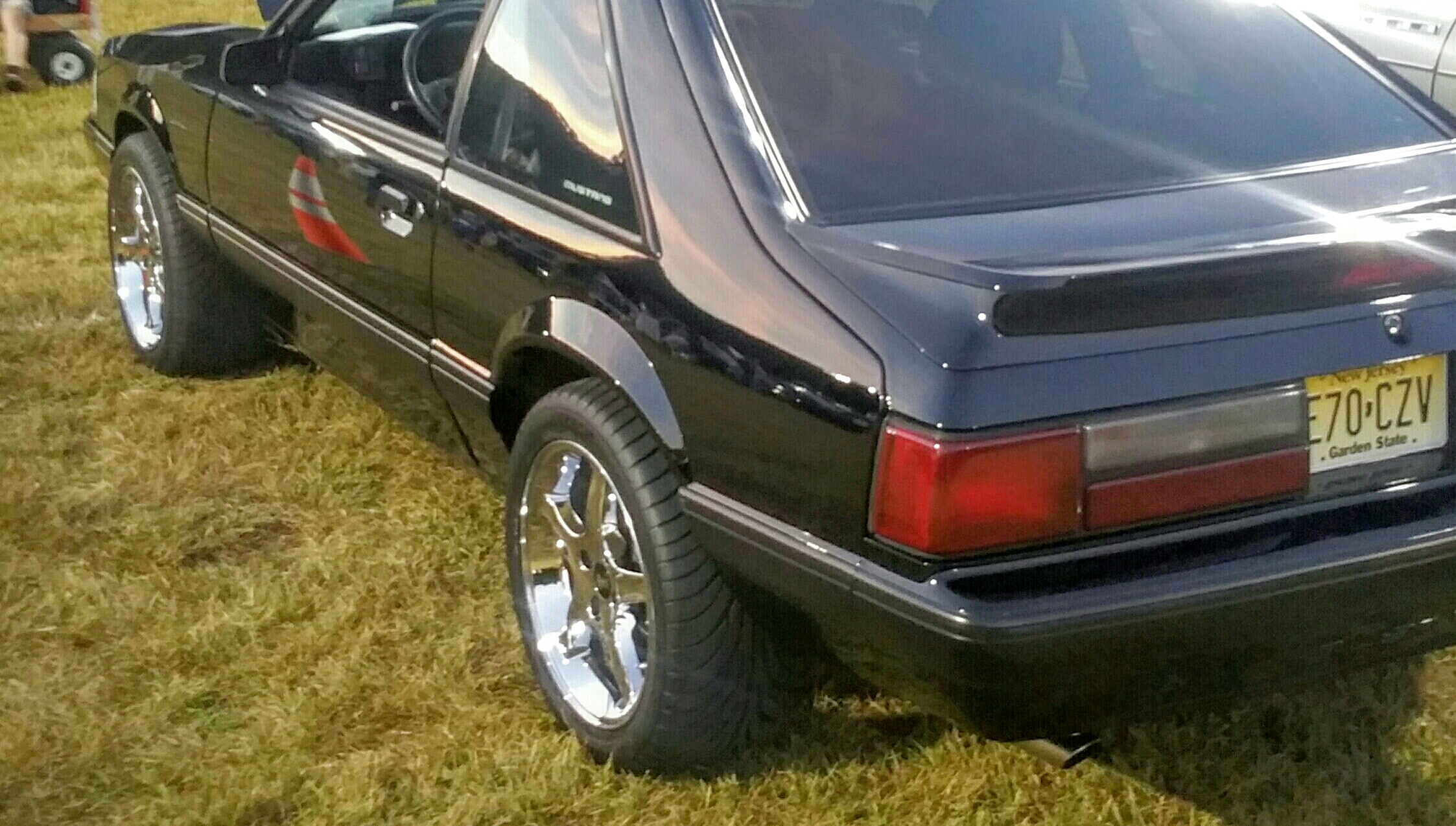

17x9 with 245's on a 89 LX in the front, 275 on the back. At full lock in reverse if I'm not paying attention it rubs slightly
