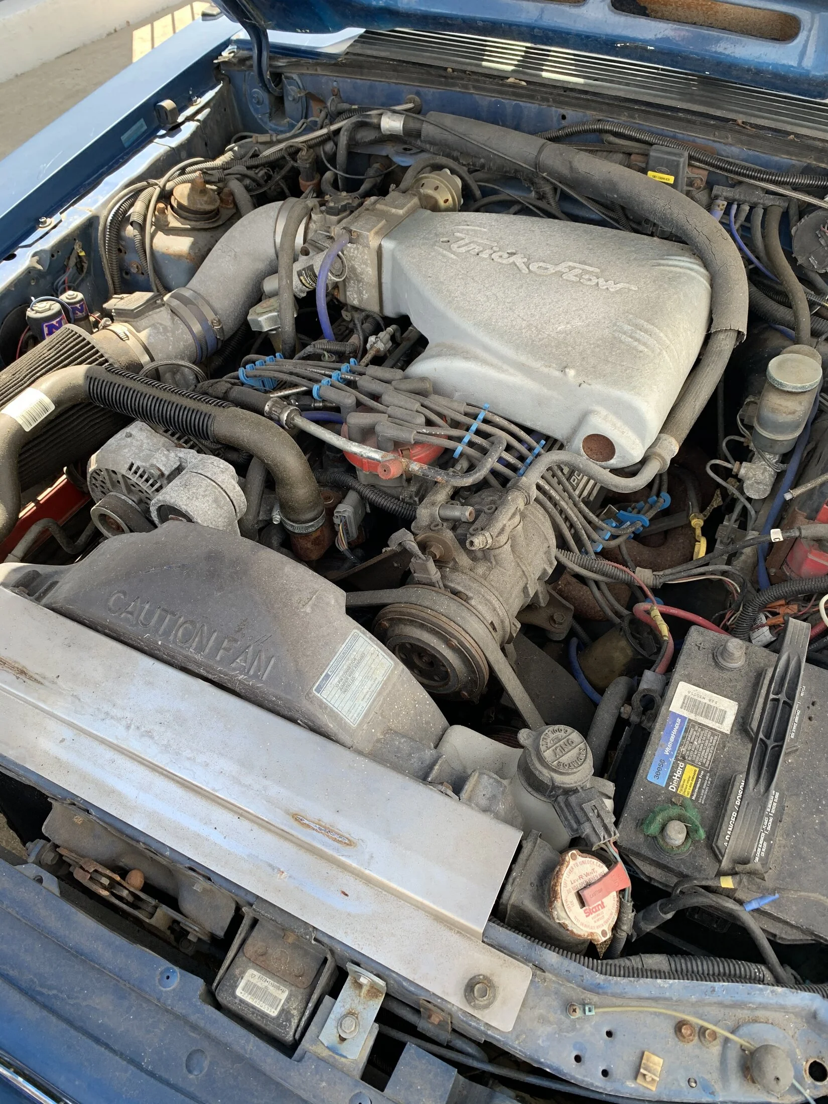

I do think it does already have some mods I can show a pic but I’m not 100% on all he did
But I plan on keeping it how it is for awhile

I'd do a 150 if those are stock heads and If there are aluminum heads down there i'd do a 190
I cannot answer if the 255 hanger will work as would need to see it. For the most part the fuel pump hangers are the same and the pump just interchanges. So if the current hanger is a stock type hanger then it would work.
So I used the stock hanger to install a 190lph Walbro pump and then a few years later put a 255 lph Walbro pump in the same hanger with zero issues. This was over 10 years ago so buyer beware. I would suggest that you check the passenger side fuel rail and see if it has the stock fuel pressure regulator (FPR) on it or an adjustable one. If it is not an adjustable FPR you should seriously consider installing a good one. I have an Aeromotive FPR on mine and it holds pressure steady as a rock even at idle.
