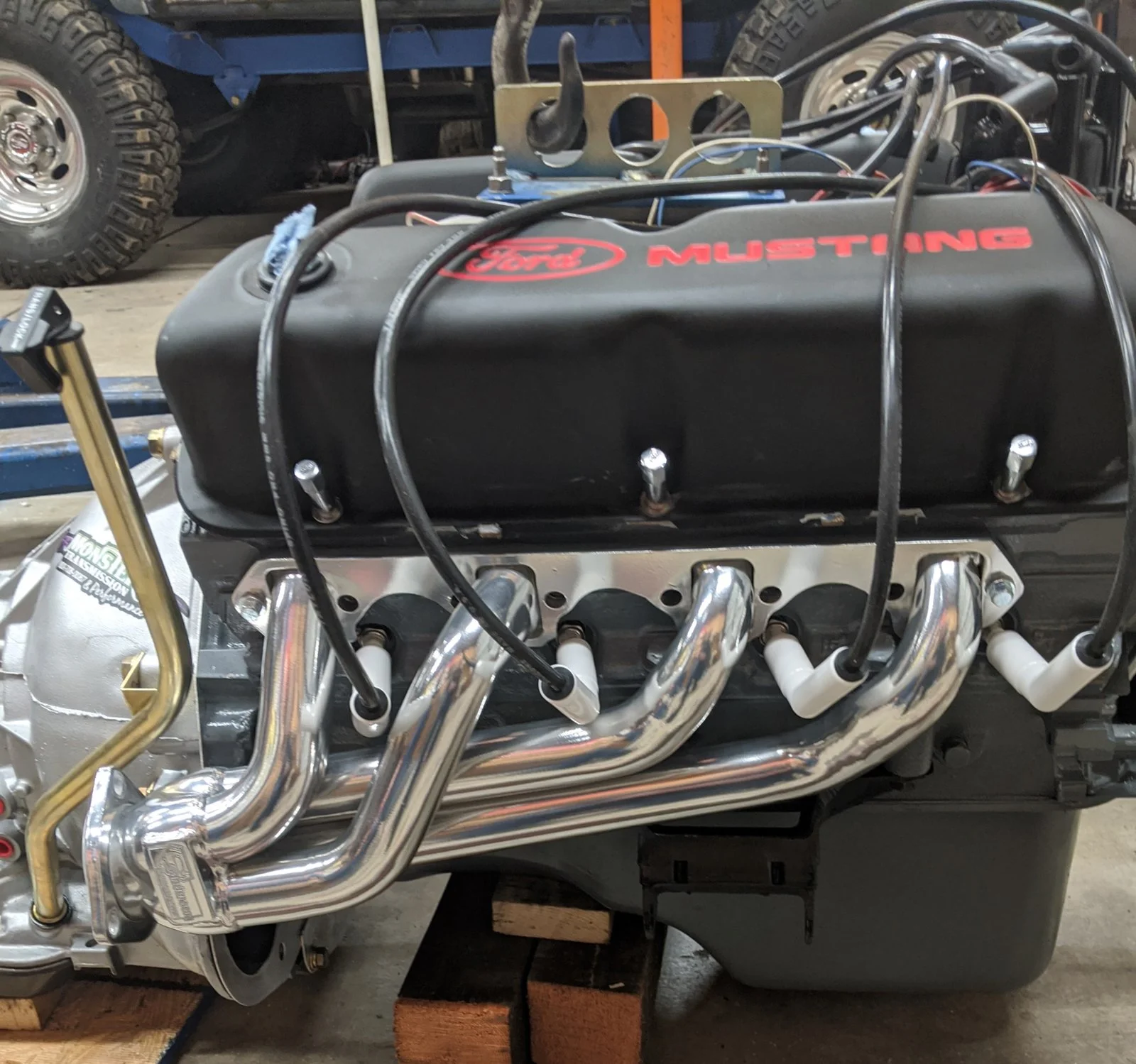

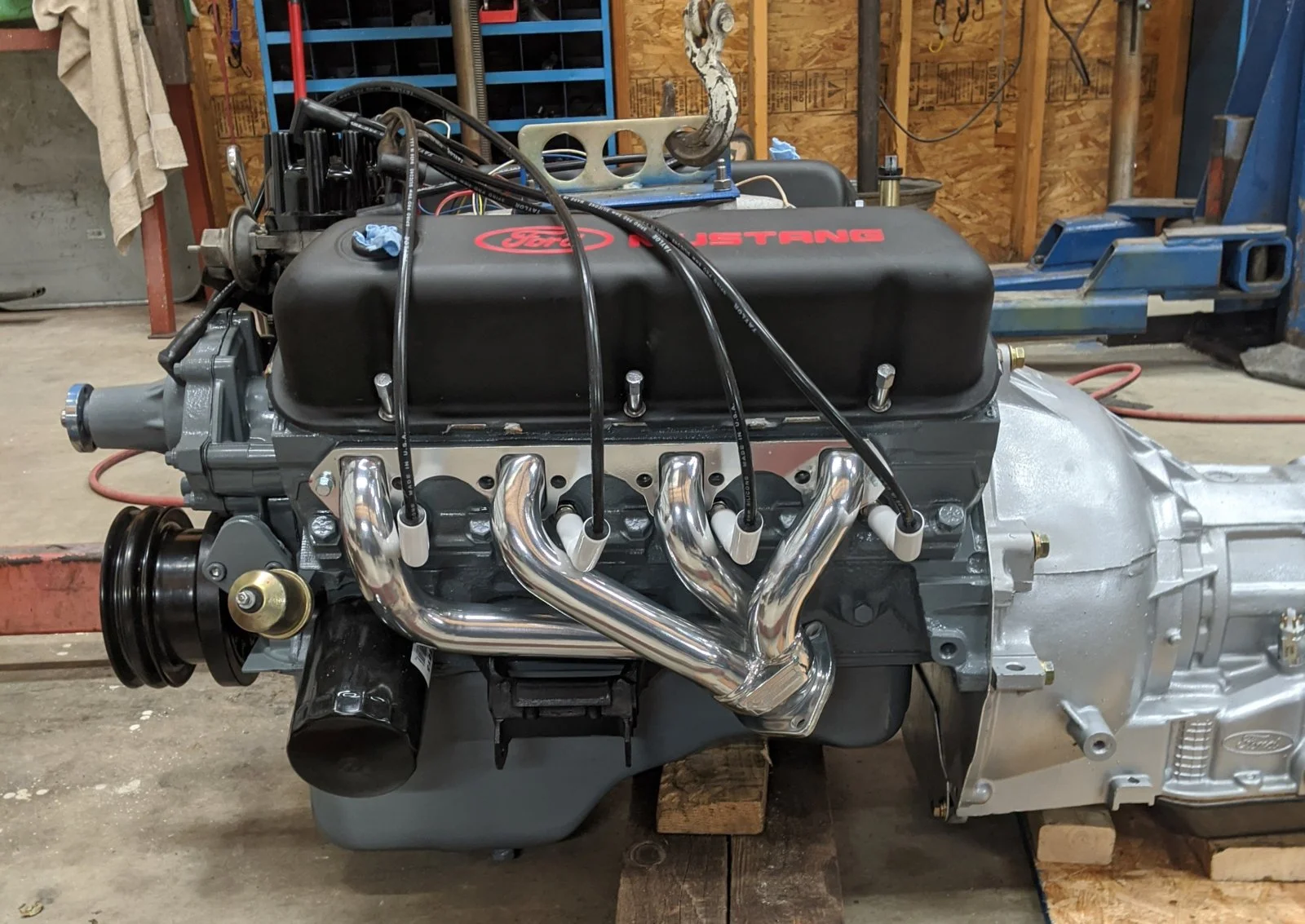

Will these headers fit Gt40p heads
The bolt pattern and exhaust port spacing did not change so those headers will bolt to gt40p heads, you may still have trouble with some of the plugs/ wires because the plug angle is different on the p heads,

Its a 289 in my 67 ranchero with 3-speed top loader
Those headers will be problematic with P heads, hell you're gonna have problems with the plug angle with any header on that ranchero, maybe the shorty style headers from mac for a fox body will work but no guarantee. I would use a different set of heads.
