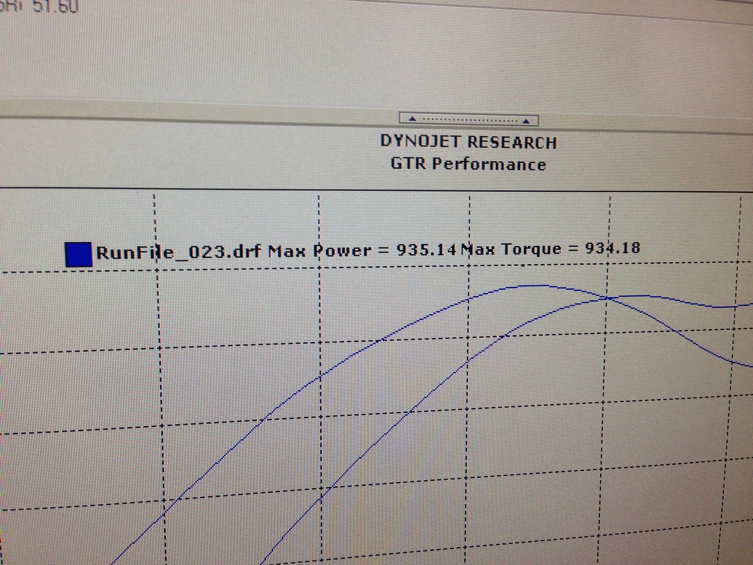

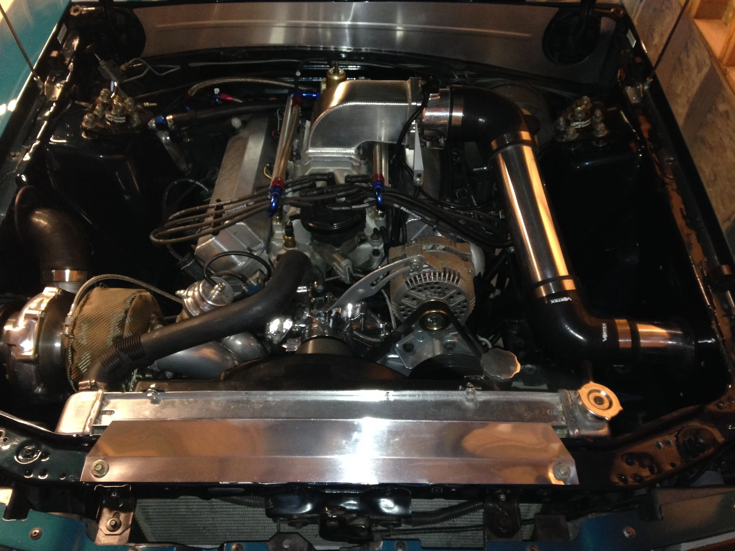

Yeah that is a 6061 elbow, the turbo ( if that is what you are asking) is Precision 76GTS
363/AFR205/BS3/120#/E85
Makes more power than useable and looks like a stock 5 lug swap car
What lower are you running? I looked at the vic jr efi...power range is 3500-8500rpm it says...my r series is 2500- ...
