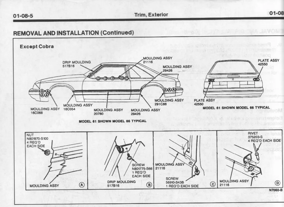

My door trim is not held on by any square clips, just the 4 round clips and the screw at the rear of the door.
Here is a pic of a page from my Mustang Service Manual. Look at detail "D".

Yeah, mine is completely different. it looks like D, except that they are only plastic retainers 2 circular and 4 rectangular on either side. They just snap down into those square holes and thats it. No rivets involved. Thats confusing. I'll snap a pic tomorrow.
