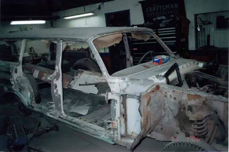

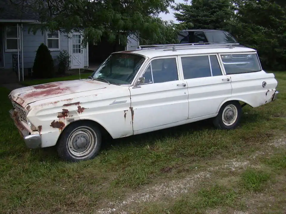

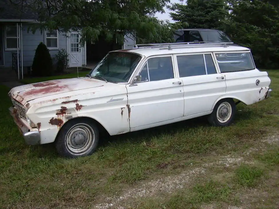

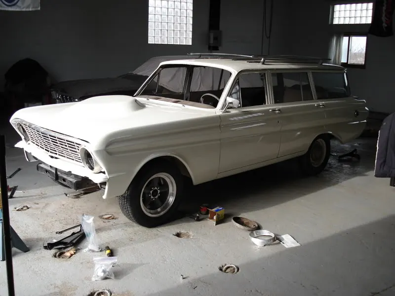

So far this winter I went from this disgraceful beast::nonono:

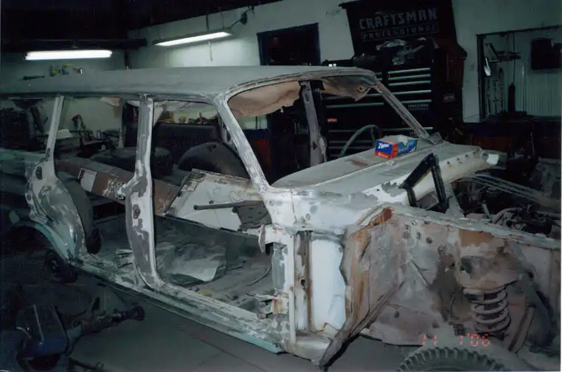

To this::shock:

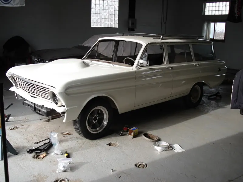

And finally to this fine mo-chine::hail2:
Its got a Crites glass hood and fenders covering the beastly 170 3spd at the moment. I have a rebuilt 5.0 H.O. with gt40 heads waiting to go in, along with a t5 and 9" that Ive yet to find. The front suspension is basically stock, but with shelby drop. Interior is done and waiting to go in, and bumpers are done also.

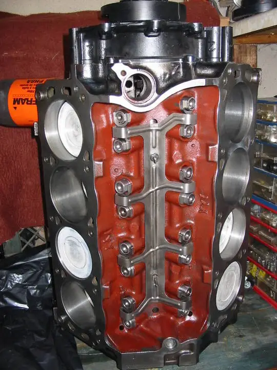

My car has been off the road since January 25th 2006.... But it has gotten the following and will be started at the end of March for the first time.

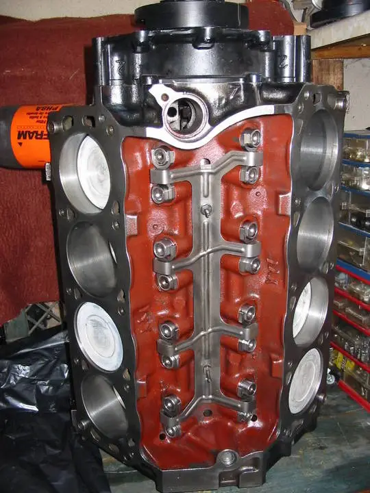

351c shortblock with forged TRW pistons. Fully machined/balanced

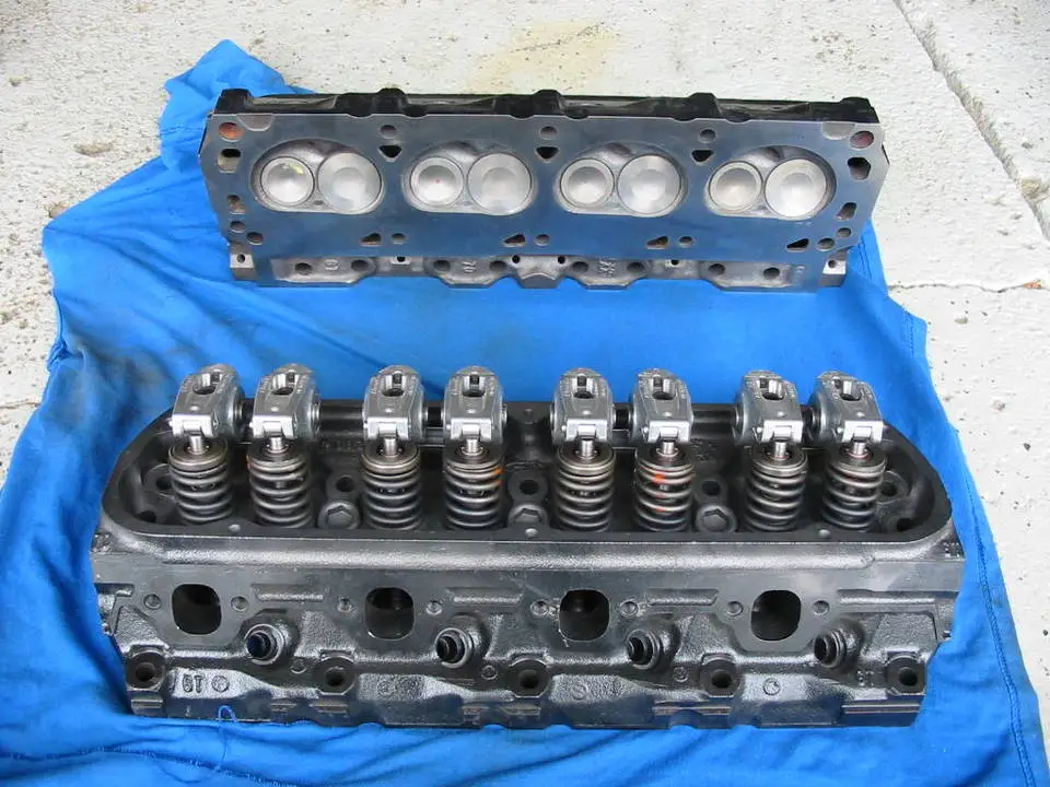

Aussie 2v heads ported and flow a REAL good number
F246 Solid Cam
Harland Sharp roller rockers
New hardware from ARP
X-CELerator ported intake
Speed Demon 750 Carb
Swapped out the Turbo Mufflers for some 40 series Flowmasters 2.5"
Rear leafs and a rear sway
Mallory 29440 Coil to match the Digital 6 Plus
Electric water pump drive
Serpentine pulleys
P/S delete linkage
Took all the stereo stuff out except stock.
Fixed wiring and hid the engine bay light harness.
Moved battery back to trunk
mini starter
Tried a MKVIII fan but it didnt fit.
4.11 rear
I still need a C4 and a high stall converter, or a 4/5 speed swap. I can't decide and I don't have the cash at the moment. I will be trying to get that, finish the interior and paint the car within the next year. Hopefully I'll get it back together and drive it. I had nitrous on the car last year, but have removed it since the new motor should be faster than the old with nitrous. It will be getting another system , once I have the supporting safety features. The car should go 10.90's or faster on the 150 shot, but it'll take more. I need subframes, a cage, a transmission and a good set of tires/rims to 'finish' the performance side of things.
