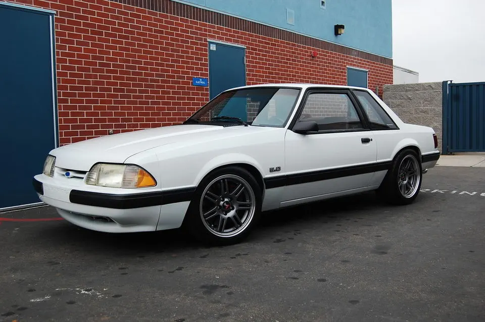

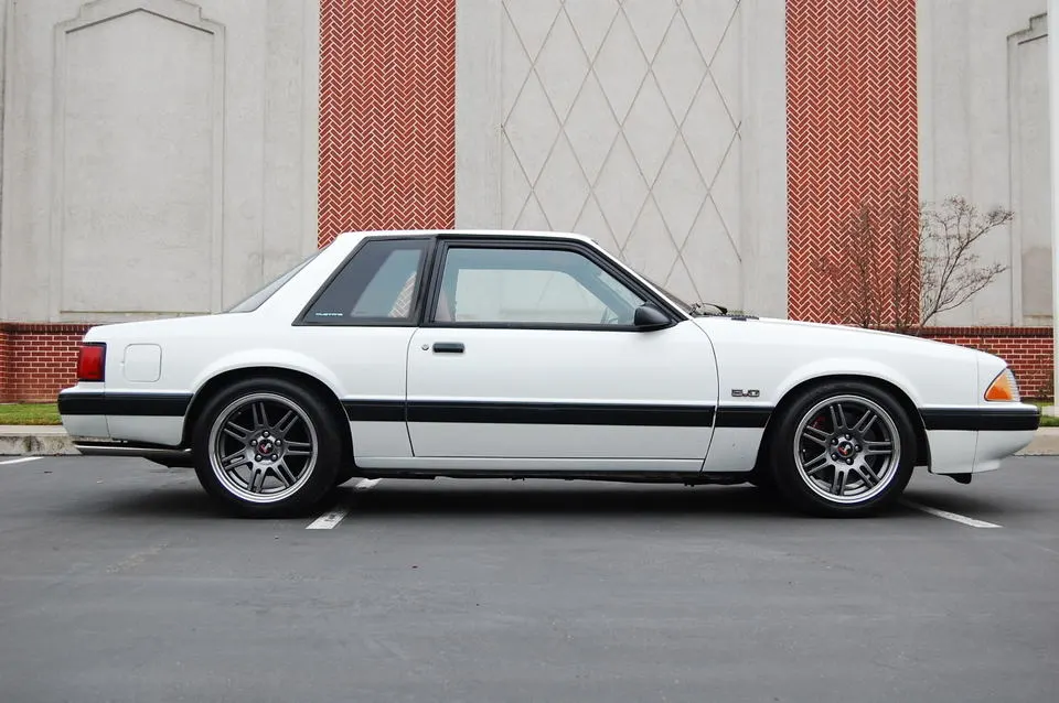

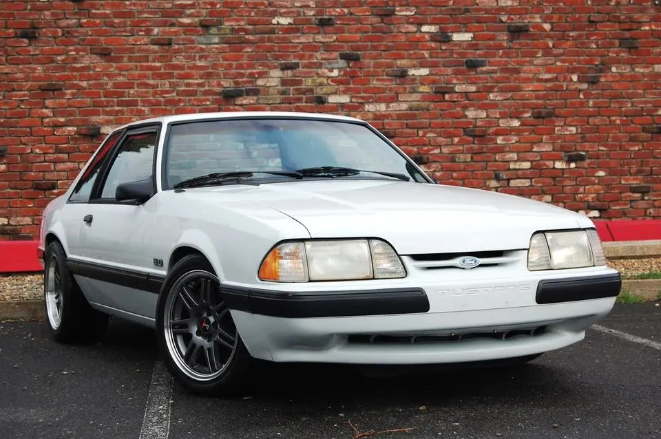

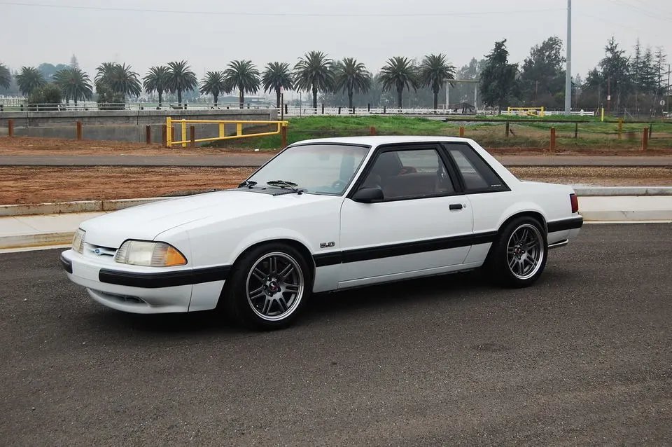

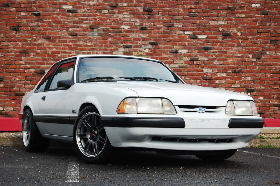

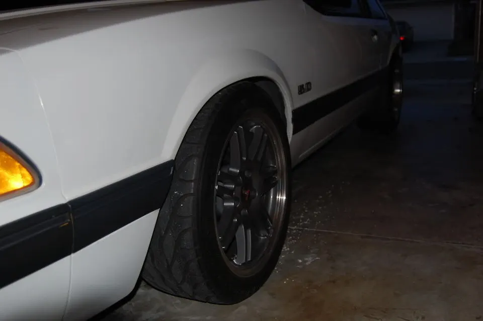

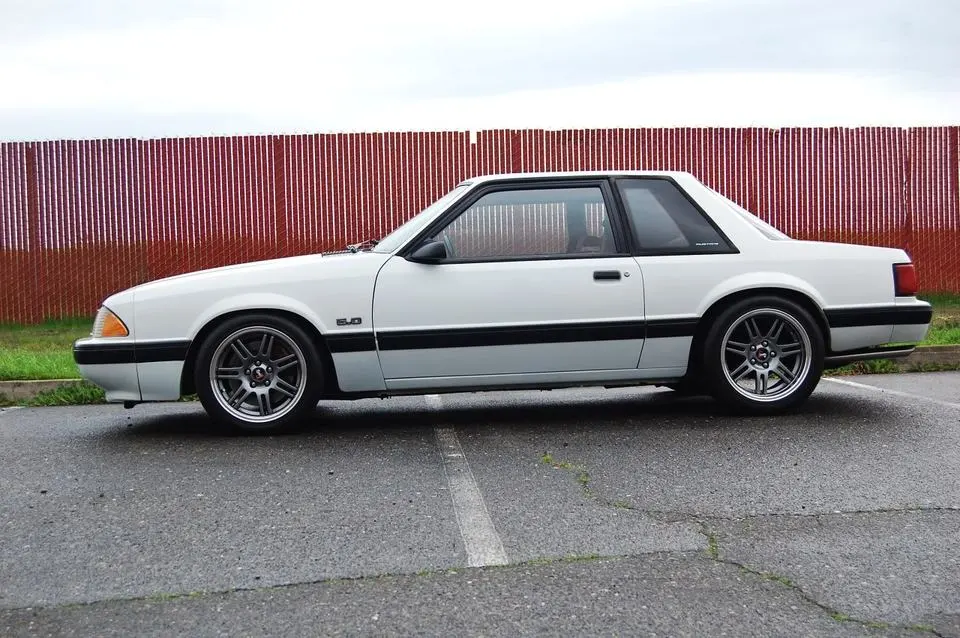

Since it was getting ready to rain for a couple of weeks straight, I figured I would take the Notch out for a quick spin. I also removed the lower front iso's last week ,& installed MM cc plates, so I needed pics of the new stance. Not exactly winter compared to some of you other people that get snow, but this is what winter is for most of us californians LOL...
I also want the rear to come down about 1/4"-1/2", but I already have the rear lower iso's removed. I have a set of MM XD adjustable weight jacker LCA's, but I have yet to install them because I still need to reinforce the torque boxes so I don't rip them out LOL...

Thanks... All it has stance wise is sportlines with the lower isos removed.
Its funny you ask about the headlights because a set of new stock replacements is next on the list. These are actually the originals & I am surprised they are still this clean...
Love the stance...hell i love the car.:nice: Just curious how did you go about removing the front isolators? Did you totally disassemble or is there a trick to it? My springs didnt quite settle enough for my liking and would like it slightly lower.Sorry to jack your thread, you can pm me info if you like or post it here.

gorgeous car man, still my favorite factory color scheme on lx's. the stance is amazing too! mine sat exactly like that but the 17x9's rubbed the top of the fenders reaaallllyyyy bad when i even grazed the smallest of bumps so i had to put iso's up front. now it sits level, almost higher in the front. i hate it. :(
Thanks bro... Unfortunately, to remove the isos you have to pull the springs out. I already was installing CC plates at the time, so it wasnt a big deal. At 1st, I removed all the iso's up front & the car sat waaaaay too low. I then took the front end apart again & reinstalled the upper isos. Its really not that hard to be honest. I guarantee you will be happy with the stance if you remove all the lower isos....
Thanks. White & black is one of my favorite color schemes as well... My car sat the same way before too,it was level, but it seemed like the front always sat higher??:shrug:
i removed all of my isos, and it definitly sits REALLY low (eibach pro-kit).
