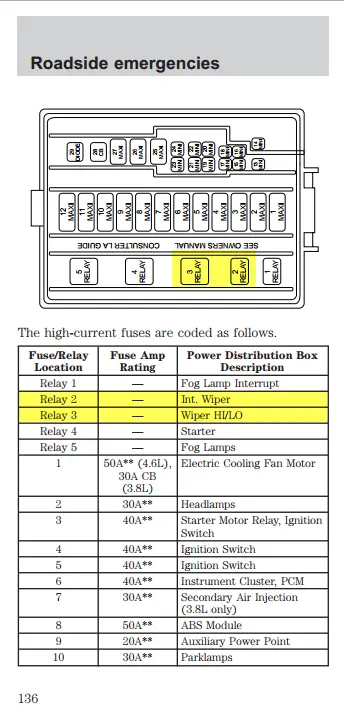

Did you happen to check your relays? The owners manual indicates there are 2 relays for the wipers. One for the Hi and Lo and one for the intermittent. See the page out of the manual below!
Best of Luck!
We have a winner!!! Big Shout out and thank you to TeamCaffineGT!!!! Relay swapped and delay works perfectly!! Now trouble shoot my driver window down and won't go up!! Rofl!!
