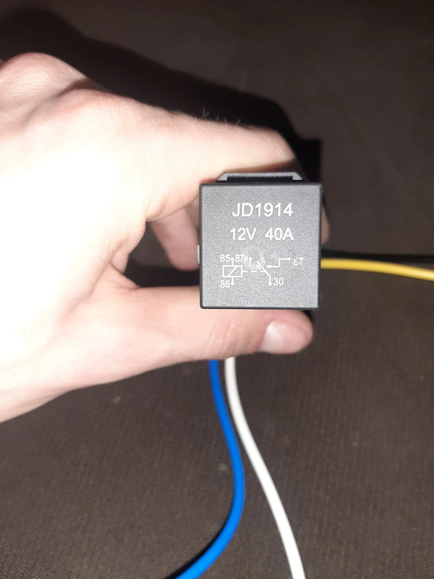

This is the style of relay im wiring in, believe I had everything correct, I followed the colours to the pins you'd directed but like I said no reaction from the pump on key on

Yup. Standard 5-prong relay.
85/86 is your coil. This is what closes the relay. Red/black and tan/green go here. Do you hear the relay physically clicking when you turn the ignition key to on?
If you remove the relay, can you test it with a 9v battery across 85/86. Might need 2 sets of hands to test the relay.
Your constant power at all times goes to pin 30 and 87 is the feed to pump. 87a should not connect to anything.
