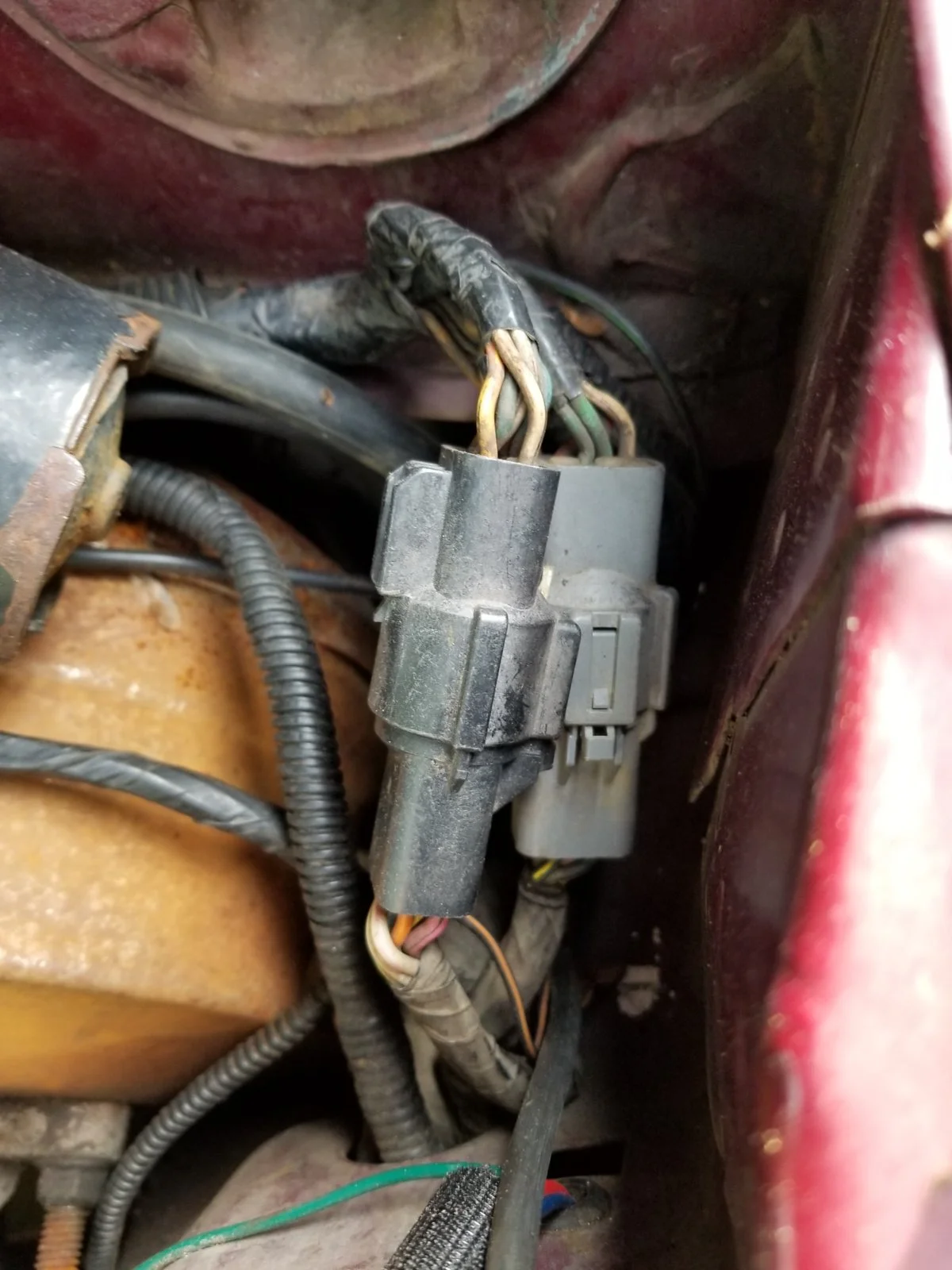

The harness you use is determined by the year of the car. My 88 4 cylinder is using the harness out of my 89 gt. The difference is in the plugs by the booster ( for the most part ). The engine harness you use should connect to two round connectors by the booster. Excuse my rusty booster.
These connectors wires run along the firewall, through a large grommet, and into the computer. The ten pin injector harnesses also plug in to this wiring. You want to use whatever harness has these two connectors. The injector harness on the engine is the same. Computers plug in the same but you'd want the 5 speed computer.
Don't forget to pull the jumper connector off the clutch switch harness end, plug it on the switch. If the 4 cylinder car is already a 5 speed then this and the trans harness is done already.
The o2 sensor harnesses are different put can be repinned to work. That harness runs over by the passenger frame rail and runs over to the k member.
