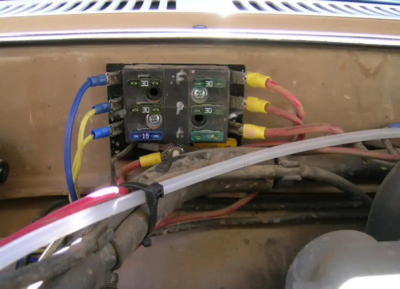

I built a fuse panel of my own to power non-factory items.
I tapped into the vert power wire (I have a coupe), the vert switch power source that would go to the vert switch is installed and powered (but capped) on coupe models. It is a switched 12v source. I ran a line to the underhood fuse block to a relay, ground, line out (to the fuse panel), and switched (vert power source). The key on powers the relay and the power is sent from the underhood fuse panel to the stand alone fuse panel.
I have a 6 fuse panel.

will do, after I swapped the 03 console in I am now playing with switch placement/new switches, when that is sorted out I plan to do a detailed pic of what wires to tap into and were I placed things. I am going to cut out the power port in the bezel and the bulk behind it to mount my tweecer knob to. Then put the line lock and bottle warmer in the bezel...just not sure if I am going to put the line lock were the n2o switch is and move that or pick up a shift ball with a switch for the line lock. I am waiting to clean up the wiring until I get the switches placed so I have extra length all over the place now...messy.
The fuse panel I have fits right in the passenger side of the console and fits in there like it was meant to go there.
