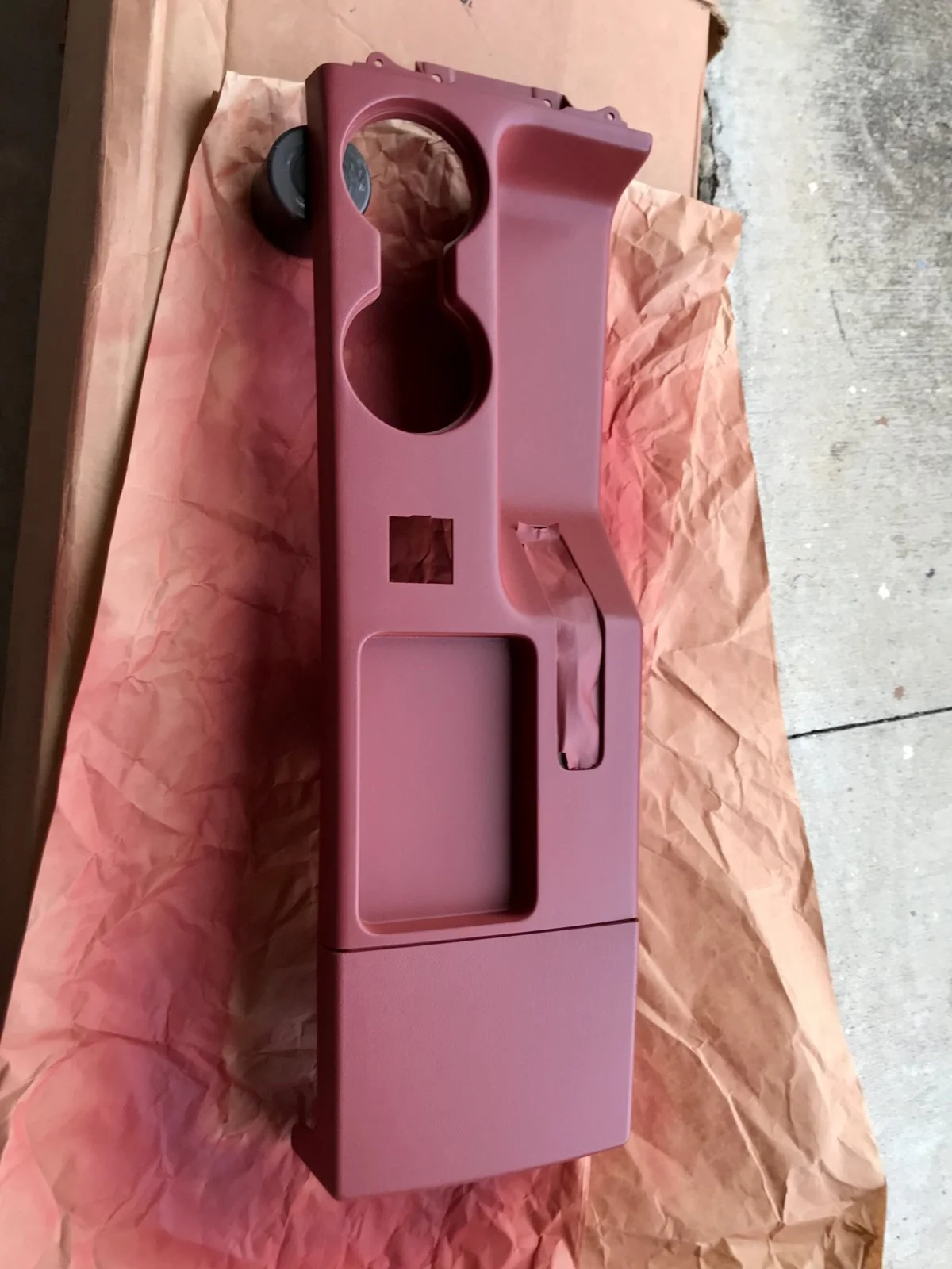

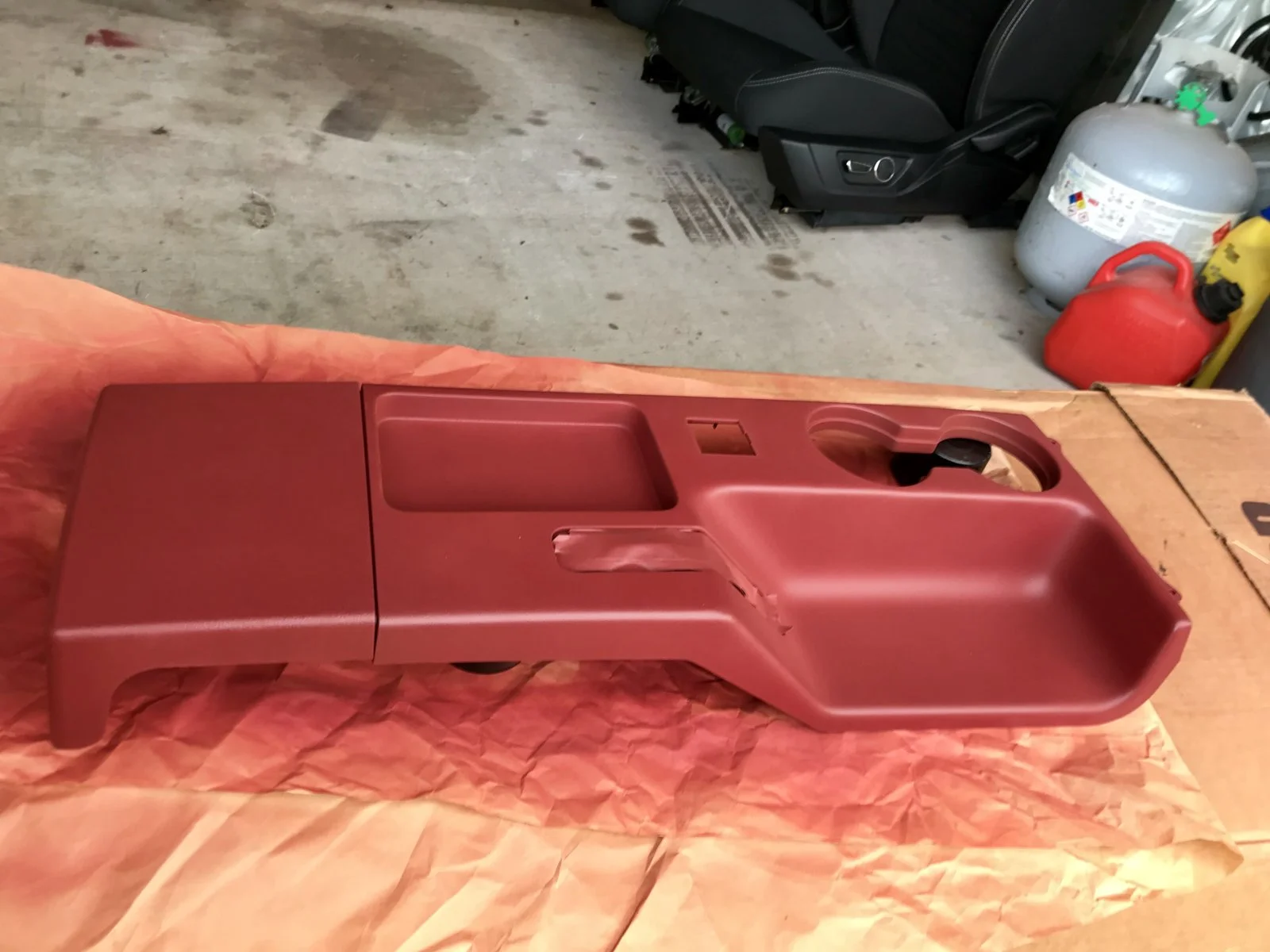

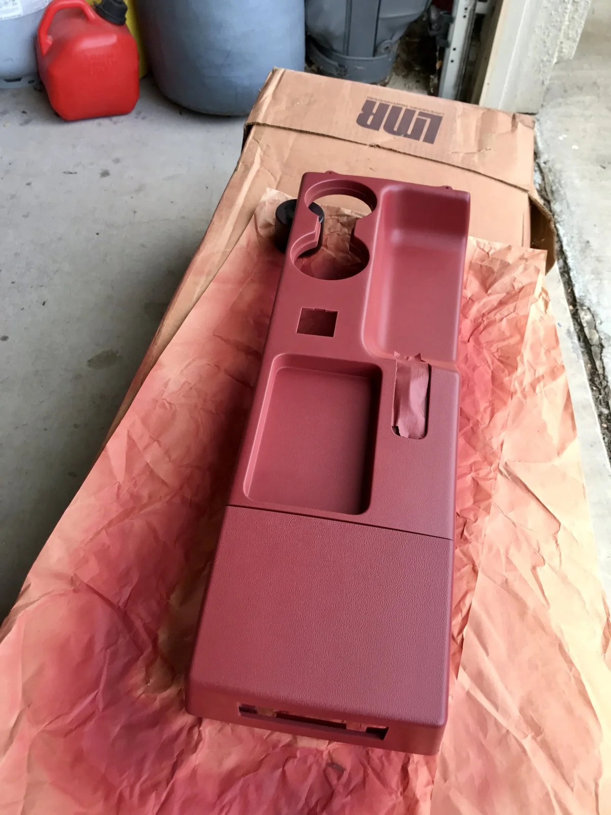

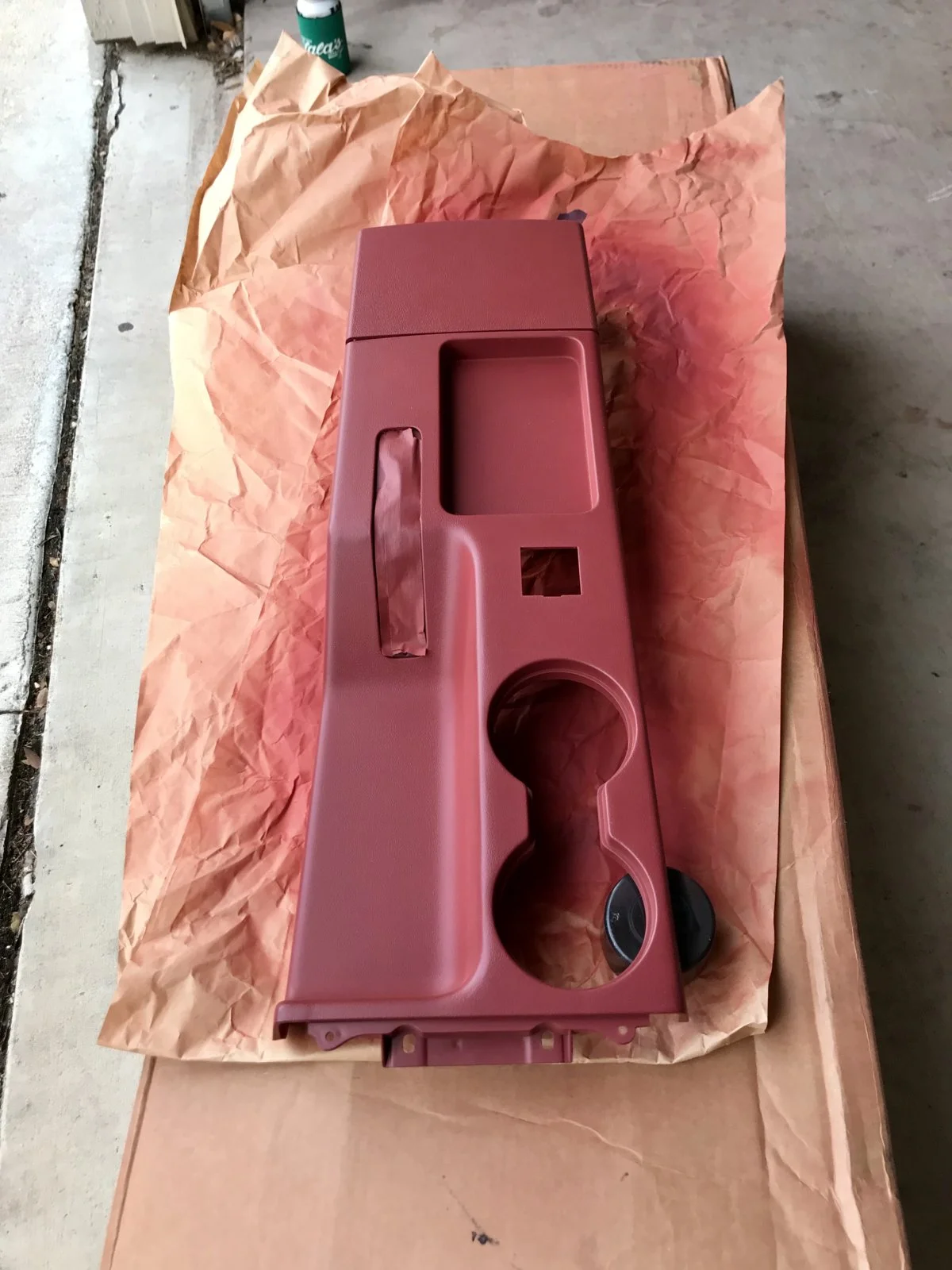

Ok took the advice and just went a little at a time instead of being a tagger and going heavy. Came out much better and I still have plenty in the can to touch it up and blend once I get the car back and put this in!!

That looks way better
Ohhh yeah man way better!! Thanks for everyone’s tips. I guess I’ll never know if it was me or the cans the first go around lol but appreciate lmr for hooking it up.

It looks good but like me you have opened Pandora's box.
My console looked great when I painted it. Which made my dash look like crap. So I replaced the dask pad and repainted the dash. That made the door cards look like crap. So I bought new arm rest pads and the map pocket deletes and repainted them. The plus side is my interior looks amazing now.

This is too little too late, but your previous attempt failed because you must've painted on a very high humidity day. The blotches come as a result of that. It's called blush, and is a side effect when using lacquer paint in high humidity. The process you used is what you have to do....slow down, and give each coat a chance to dry before adding another.

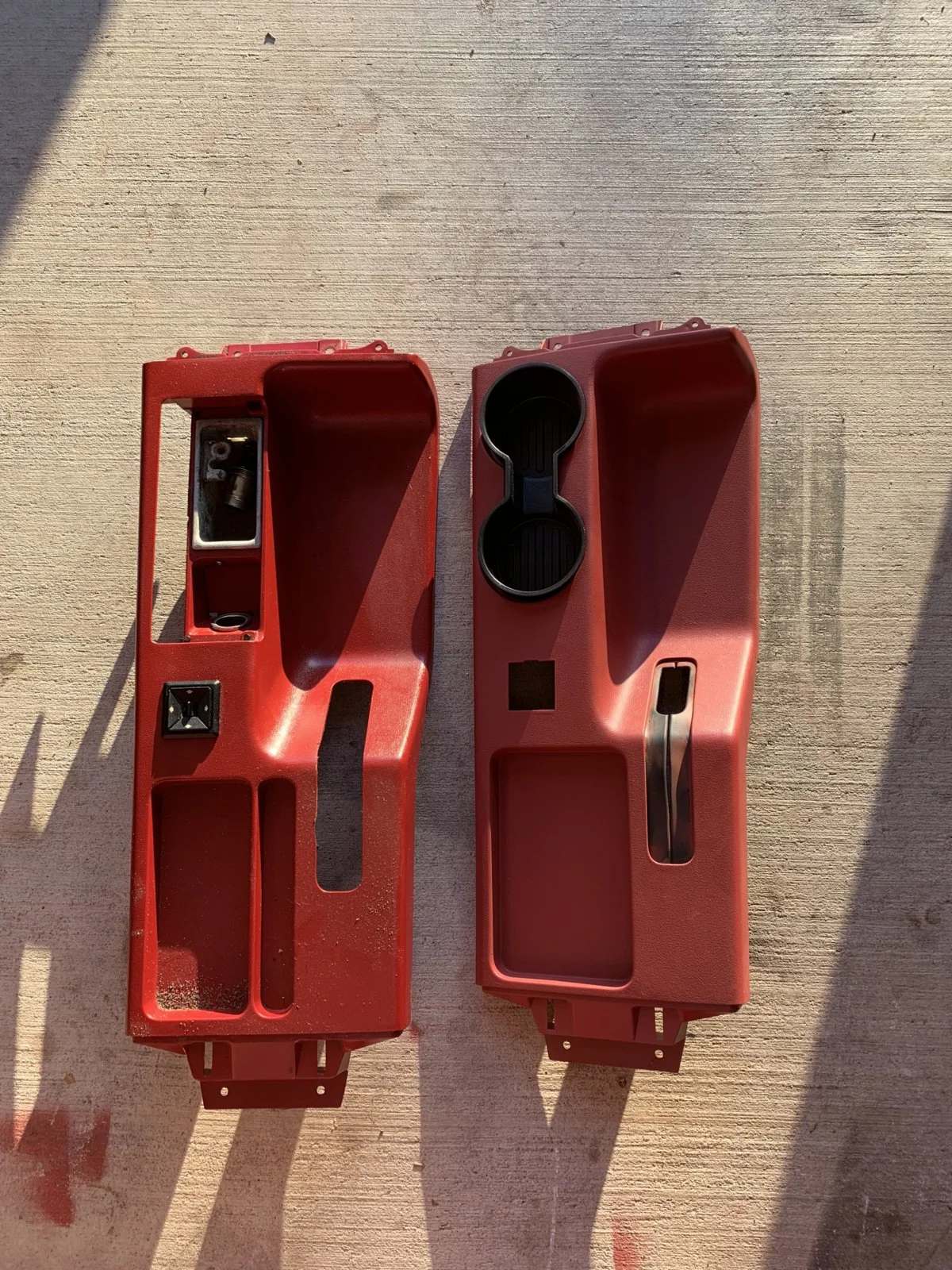

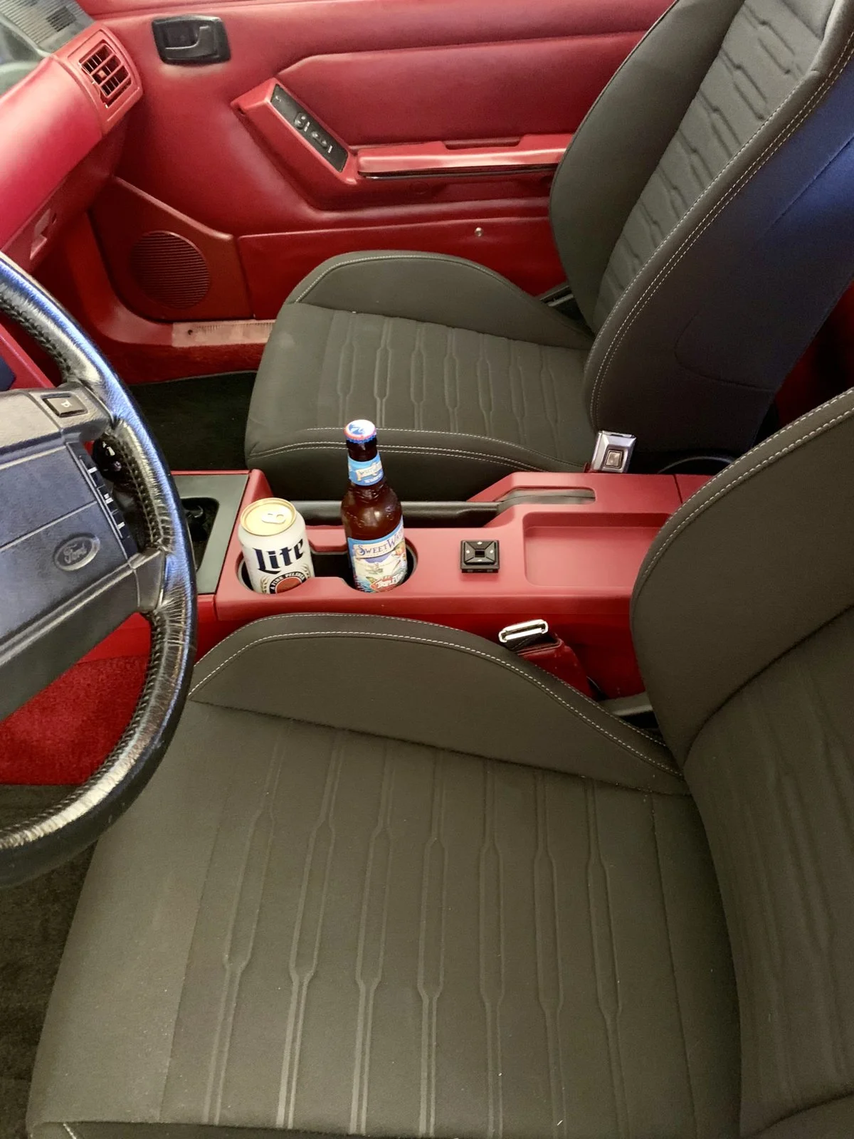

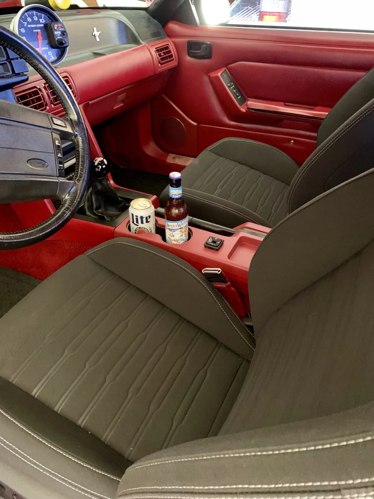

Ok so installed the center console, cup holder is cool, didn’t have anything else to try with so grabbed some beers out of the garage beer fridge. So not sure how to get it to match better? It’s there but not really, looked good out of the car but compared to the original plastics it not matched up perfectly. Doesn’t have that glossy pop either, granted I had wiped down the car with some cleaner. I also tried a small area on the center console with some of the cleaner shine stuff and I felt like it was rubbing the dye off, anyone else had this issue? Thinking I might buy a can of the Napa red and respray it. Do I need to do anything to it if I do or can I just spray on top of what I already sprayed.

I dunno. Looks pretty damn close from what I can see.
I would assume you can overspray it with new color. Just wash it with soap/water to remove and grease/oils from handling first.

Looks good, but I’m with you in that it just doesn’t match. The OE color is just, more red, for lack of a better description. The LMR color looks like it has more brown in it. I’ve been debating trying the Napa as well.

I think I’m gonna buy a can off eBay and give it a try. What could it hurt???
